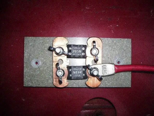

A DC fuse is designed to soften as it reaches it's blow rating. When the current eceeds that rating, a large chunk of fusible metal drops out rather than just a spot. This eliminates the welding effect.
Even marine fuses in the 400+ amp rating are expensive, just not as much as the special T fuses for solar. There really isn't any difference. They all come out of the same box, it's just that specialty equipment is always higher.
In an industrial setting, fuses are often paralleled to increase the current carrying rating. There are some what/ifs associated with doing this including the ambient temperature of each fuse.
As a practical matter though, two 10 amp fuses will carry 20 amps. Even if one blows before the rest, it increases the current on the others and they fall like domino's
I'm going to put together a high amperage block today just to do it and will post it later. I want to stress though, that it will not pass code!

I am but you can't get large enough fuses for the inverter. I have a 5K inverter and that worked out to a little over 400 amps. The largest I could find this morning were 175 amps. I'll make a block to parallel  them for 350 amps.

I didn't have a lot of extra time today but I did get the block finished. It still needs the cover which I'll use Kydex and heat form it to give an inch airspace between it and the fuses.
The base is Corian, 1/8" copper and stainless bolts.
It will handle 350 amps and total cost is under 13.00.
I'm not sure where I'm going to put it yet because I already have a fuse at the inverter. Maybe as a doomsday fuse at the battery box.

Looks good Peter. I'm curious;  ::) how are the bolt heads protected behind? I've made similar devices, bus connectors and have recessed the heads and then placed another layer of insulating material behind. But some of those were mounted on metal, like an auto firewall, fender, etc.
Kydex is a nice plastic. Tough, abrasion resistant.
I used to use some of it for some playground equipment.
Have lots of scraps around still, handy for all kinds of things.

[highlight][highlight]I'm curious;  Roll Eyes how are the bolt heads protected behind? I've made similar devices, bus connectors and have recessed the heads and then placed another layer of insulating material behind. But some of those were mounted on metal, like an auto firewall, fender, etc.
[/highlight][/highlight]
Sorry Don....I missed that part of your post.
That's exactly how I did it. The bolt heads are recessed in and I have a second piece of Corian behind.

QuoteThat's exactly how I did it. The bolt heads are recessed in and I have a second piece of Corian behind.
:) Just wondered if you'd hit upon some other method. Guess that cat's gonna be skinned the one way and that's that.  :-/
