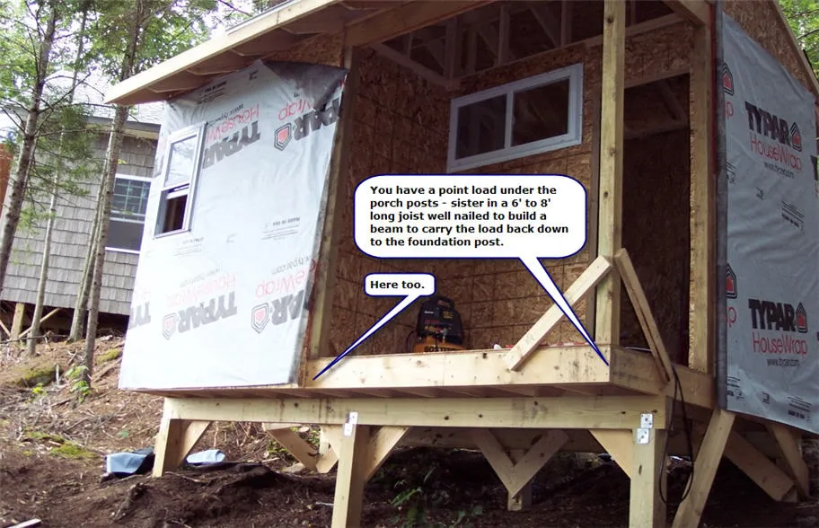

Here's a suggestion.
The one in the middle isn't quite as important as the nailed off sheathing on the wall works like a big diaphragm to share the load. However, that corner porch post is the lone ranger out there.
Very nice kitchen in the main cabin.
MaineRhino
Thanks for the tip. I'll do that this weekend.  I had wondered if that would need to be done.......   d*
