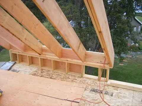

peg_688
#3
Solid blocking a 2x 6,8,10, 12 , / or piece of "I" joist between each joist( the same size  block as your floor joist) , so they can't roll over. It / they may not be required IF you do not have to pass a inspection.
Solid blocking between rafters you should do the same with floor / deck / etc joist. Common practice in todays framing market/ envir.

peg_688
#5
One per bay . Just so they can't roll over , generally,  at what's called the point of bearing (over the wall and/ or beams )  ;)
Post some photo's , if you have the equipment , I'd sure like to see if this teachin is payin off in the field  :)
