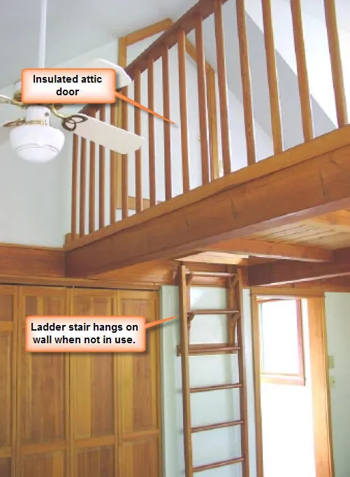

See if this ladder stair detail works for you.
http://www.countryplans.com/Downloads/ladder.PDF
Amanda_931
That looks like a nice idea.  I've been considering library stairs (still using a chain hoist to bring up and down boxes or baskets), but those take up so much less space.
