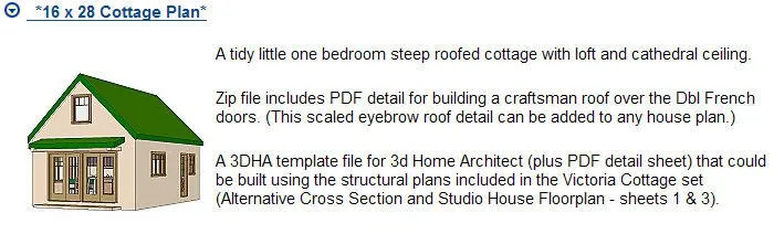

If you want to learn the basic 3D Home Architect program, it will be able to produce scaled floorplans with windows, doors, cabinets, electrical, ect. You can print these and the four elevations out at 1/4" scale and paste these into your new set. A template for the floorplan of a 16x28 Cottage can be found at the PlanHelp.com site templates and this could be simplified down to fit your size.
This probably is not exactly what you want, but it can be modified (I would raise the loft ceiling to match the new cross section assuming you want the room in the loft.) The 3D aspect of this program is helpful since it gives you a feel for the space rather quickly.
