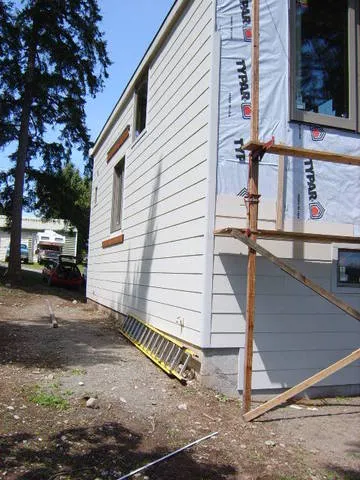

This place had a basement level/ gnd floor / a kitchen , master bed , hall bath level, a livingroom level 48" above that, and a loft level back over the master bedroom .kitch area. It was  a PITA to frame .
In the last photo you can see the difference in floor heights by the door locations .
So there's a bit to think about when different floor levels are introduced.
