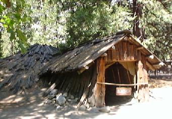

Here is one of the historic Indian cabins from Yosemite area courtesy of the National Park Service.  I realize we are talking earlier than this but I included it as it looks like it should be one of John's plans.

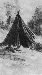

Here is a sketch of an Indian dwelling called an Umacha in the Miwok language.  The lady who drew the sketch years ago called it an o-chum,  I helped my friend, Ben and his wife Kimberly, repair a couple of them in the Indian village in Yosemite.  They are built of a pole frame covered with long large pieces of cedar bark.  As I remember, cross supports were tied on with wild grape vines.
Link to the picture site with more information.
http://www.yosemite.ca.us/history/yosemite_indians_and_other_sketches/indians.html
My friends are part of the Miwok and Maidu tribes.  They were mostly hunter- gatherers rather than warring tribes.  Their cultures were fairly similar and both used the  round houses for their ceremonies.  These were semi-subterranean, cone-shaped structures with pole frames, covered with bark, brush, grass, or tule; a fire-pit stands in the center and a hole is left on the top of the dome for air circulation.  Some were also earth covered.   This is a picture of the round house I have attended several Indian sacred ceremonies in.  I would guess it is approximately 40 feet across and 15 feet high with 4' high stacked rock walls around the inside perimeter.  The center is supported by 4 tree posts with beams in the crotches of the tree posts.  Poles radiate out from the center and other poles are tied across them horizontally with wild grape vines then the entire structure is covered with cedar bark.  There is a large fire pit in the center to see the dancers by and warm it.  Smoke exits through the hole in the top center.
