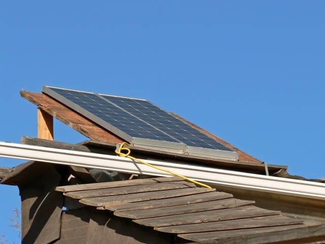

A man on another site I was reading mentioned that he used a blower hooked to a couple of solar panels - sun comes up - motor goes on - no need for a thermostat- sun goes down - the motor goes off - no sun, the motor stays off.  In the summer I will disconnect it.  A friend gave me an old car heater blower and I had my two old original 50 watt solar panels - the rest of the system won't even miss them.
Next thing was to take the motor to the roof and see if the panels would run it.  Disconnected them from the system - changed them from series 24v to parallel for 12 volts.  Motor took off- no problem.  The motor -- that's the aggressive part of it--- it gets in there and gets the job done.   A good head of air too. :)

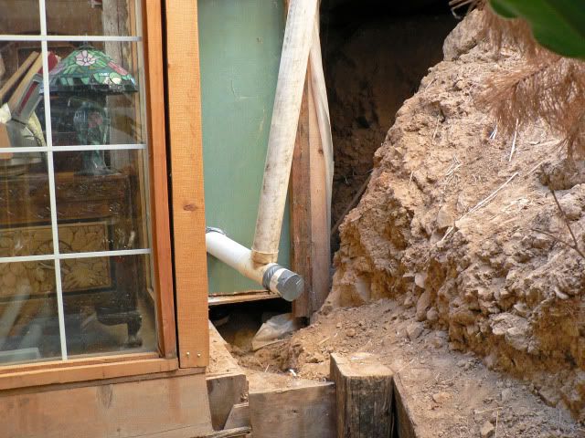

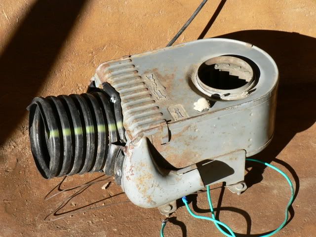

Next thing was to run down to the junk pile and find some suitable pipe.  I had some old  PSP thinwall 4" sewer pipe that was the perfect size to slip over the end of the blower output.  It was square - the pipe was round but it fit.  Then a good wrapping with duct tape --- Hey -- I even use the proper tool for the job. :)
It's a duct isn't it?
I found a "T" and a 45 to make my duct job perfect.  Next thing was where to put it.  If I put it to the top of the room I had to cut through the wall - no big deal but the heat would want to leave the room at night right back out the way it came in - so to the bottom it was.  The easiest place to go in was through the closet wall - the closet only has a curtain on it so this would work fine.

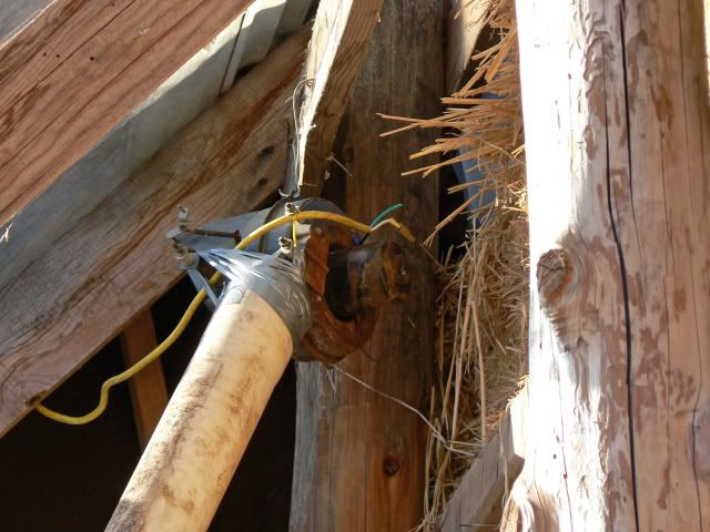

Sensors indicated that the prime mover was achieving undesirably high temperatures which were emanating from it's outer housing.   (I heard an engineer talk that way once.) :-/
Translation:  I stuck my hand under the plastic at the top of the strawbale insulation of the greenhouse and the motor felt a bit hot.  I assumed that it was because the motor had been wet in the past and may have had a bearing problem.

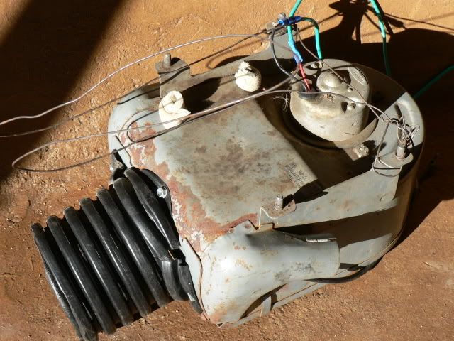

I quickly went to the junk pile and found another of the heaters my friend had given me.  I removed the heater core and plugged all openings that were not going to be used.
With self drilling fasteners I attached a piece of drain pipe of the proper size to connect to a piece of PSP.
Wire stubs were attached so that the system would not be shut down for longer than about 5 minutes for the change.
In about 30 minutes I checked and the new blower was running a bit hot too.  Checking showed that the unit was pulling about 3.02 amps at 16.2 volts.  That was the problem.
The two 50 watt solar panels in parallel were putting out too much power.  I guess it's time to go back up on the roof and remove one from the system.

I removed 1 solar panel - currently running on one Siemens 12v 50 watt solar panel.
New voltage is 14.14 volts and room temperature was 64 degrees  Incoming air is now 86 degrees and OAT is 69 degrees F.  There is almost no noticeable difference in the speed the blower is running at.  With a 33 gallon trash bag my assistant, Sassy and I  measured fan output at one bag full in just under 4 seconds.  This works out to a little over 1 cu. ft. per second, or 60 cfm.  At this rate the room will get an air change every 40 minutes.
