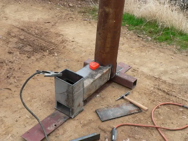

I got started on the rocket stove today. Best is fire brick but I didn't have any so I did the heavy steel alternative.  Its experimental so we'll see what happens.  I'm building from the plans in Ianto Evans book, "Rocket Mass Heaters."
Here is what I got  so far..
Feed tube, burn tunnel and heat riser.
This shows the bottom half of the tin retainer for the insulation.  Not good to use galvanized but I'll hold my breath for the first few burns. It's internal so should go outside anyway.  Behind it is the heat exchanger barrel.
I put it inside - now for insulation options - I think maybe clay and sawdust to make insulating clay -- we'll see what happens.  Gotta study more.

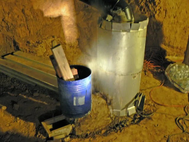

Now - progress on rocket stove testing continues.  Here is a test of the sawdust- fire clay insulation mixture.  I used 10 fine sawdust 5 wood ashes w/ small pieces of charcoal as from the stove, 5 fireclay - mortar clay it is called -$5.08 for 50 lbs dry powder for masons.
Now before anybody asks, no I do not have a dog and no-- he was not eating asbestos.
The mixture held up remarkably well even under the torch flame.  This may not be the best insulation but it was free to cheap with the added clay.

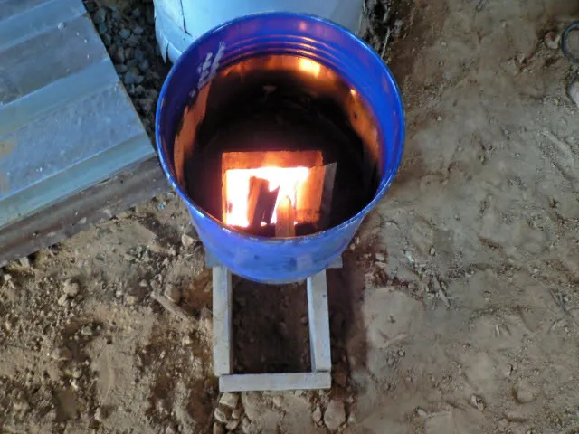

Next a test of the partially assembled rocket stove - to start drying the insulation and for the fun of it- note that the barrel heat exchanger is not on and the heat riser is put temporarily into the stove pipe.
I'm sure you are wondering what the square hole is on the stove's bottom.  That's it's ash hole. :)

Insulation continues - mixed up about 6 wheel barrow loads - probably about 1/2 yard of sawdust or more.
Fire is progressing nicely and insulation is to the top of the riser now.  I made the outside of the insulation retainer from scrap flashing and welded spacers to the outside of the pipe riser.
The insulation is steaming and water in it is boiling now. Fire tunnel is mostly insulated now.
Sassy still doesn't think it is beautiful yet. :-/
