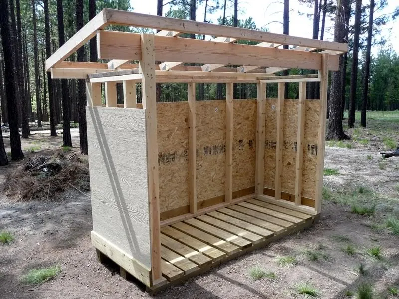

Update on the guest bunkhouse that I mentioned we were thinking of building. Budgetary constraints demand that we downsize the cabin. Yes, I know it is already on the small side, but there are people who actually have small cabins they use all the time. So I took a day or so and put together a simple little bunkhouse.
Here it is not quite completed...
Okay, it looks more like a bus stop shelter.  :)
In reality it is a wood shed, a place to store some firewood out of the weather. We took a simple approach with a "foundation" of three 4x6 PT 8 foot timbers running in the long dimension. It is 40 inches in width, 6 feet height at the front opening and 5 feet at the rear wall. 2x4 framing, 24"OC across the back and roof with some extra studs in the ends to prevent the stacked firewood from pushing directly on the siding. Progress photos below.
Testing...
More later when it's finished including a paint job.

If your budget is that tight Don, I suggest you either rent the lil guy out or, perhaps, have each guest bring a hammer and leave a board or two on the wall!  :P
Actually, I've seen the local wood sheds built using walls of staggered boards which, having a full board's width between them allows for circulation. It got me to thinking of all the wooden pallets laying up the road which eventually rot. Perhaps I can put them to good use yet. A wall of pallets... Hmm  ???
