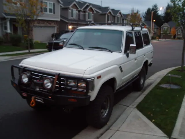

DirtyLittleSecret
Okay, so it took me my spare time over the last three days to go through this thread, and I gotta admit...its gotten me anxious for the snow on my property to clear up!  Seriously, thanks for sharing with us.  I'm already considering a PV system now.  Oh, and nice Jeep.  Too bad it isnt a Cruiser!

DirtyLittleSecret
My "Mountain Rig": 1988 FJ62 w/ LT1, 4L60e, 1 ton (Longfield 30's, Poly Rears), 3" OME, 1" BL, ARB/Aussie, Warn M8000, 33" BFG MT's, and fresh interior, etc...
...and this is a "modest" build...
Didnt mean to hijack, but thanks again for the great thread!  I look forward to Season 2!

Those work well with the small block; there are a few around here that I know of. If you have other images and want to show off you could go here...
