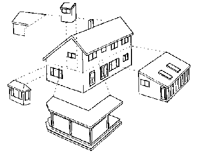

For a specific design the width of the main framing needs to remain the same, or it is a whole new design although length can be easily added to.  Independant add ons are also easy such as the Big Enchilada package, with rooms on either side but the bearing walls are still supported the same and the ceiling joists remain the same span as designed for.
Example - The 20x30 could easily be the 20x50 but not the 25x50.  Framing members and foundation would have to be redesigned.  Add-ons could still be done on the sides for more room.
I think the widest John has is his Expandable Saltbox plan. I would guess that it could be extended too.
It shows how additions can be made to the basic structure.
