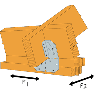

 Another suggestion would be to install your blocking 90 deg. from the top of your rafter and flush  the inside of the block with your exterior sheathing so it becomes a trim piece to side to. The hurricane clip will tie your rafter down just as well.  This image shows the block flush outside of block  to outside of framing . If you flush the  inside of the block with the outside of sheathing you end up with a 1 1/2" trim piece to side up to.
If you want to heat the place stuff a wad of insulation in the vent hole for the time being.
 You can and should IMO put the clip on the inside , this  photo was the only one that showed the block and rafter. It (the clip  in this image ) is a H10 , more than likely a H1 or H2.5 will be all you need.
This is a poor image as it does not show a birds mouth cut on the rafter. But it does show the basic block detail.

Anti rotation blocks are standard equip. here in the eathquake prone  ::) PNW . A generally every where I've built . If you have not insp. to pass your idea MTL will work.

I think the anti-rotation blocking is just the horizontal blocking at the edge between the rafters as shown in the above clip installation illustration.  An earthquake would try to hinge your rafters and rip them loose at the top plate connection.  Without the block the sheathing would not do much to stop it.  The block will keep them from rotating.  While a bit more complicated to lay out, I don't see why you couldn't just make your blocks full rafter to rafter distance and notch then out as necessary to leave room for the rafter tail.

Humm I didn't think I was argueing , just explaining  :-? Or tryin to  :-[ The block shown in the Simpson image with the H10 attached to it would be a anti rotation block , a un vented one as it has no vent hole . It would keep the rafters from rolling over in a quake , or so they say  ::) I guess we'll see next time we have a big um  :o
