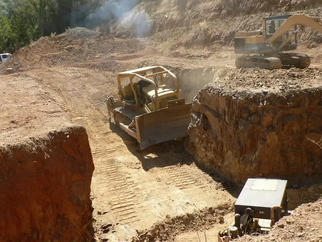

We are currently starting on the basement/utility tunnel.  The owners want to build on it as they get money to.  The last few days we have been excavating/dozing soft rock with a few hard places in it.

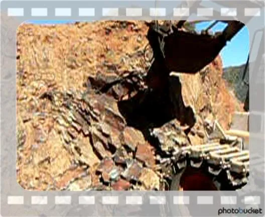

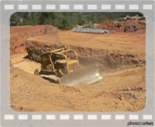

Here is an experimental Photobucket Video of me pushing a bit of rock and dirt out of the excavation with the D8 Cat to see if they are useful in our forum.  If you are game -- try it out -- let me know if it is useable or takes too long loading or playing. etc.
Interesting Glenn:
You took that with the Panasonic digital camera?
#5
Yes - I also set it to low quality video so that it will keep file size low.
Was it any problem for you? -- It looks like Photobucket converts it to a streaming video when it sends it out.  I don't know how it will do on dial-up.
That was me on the dozer -- actually --my assistant, Fred took the video with my Panasonic--- You remeber Fred?  I have his picture on here somewhere. :)
The video mode is available immediately - just turn the mode knob to video.  The videos download at the same time the pictures do with the HP software - others too.
The model I have has been upgraded to a newer model with more capabilities and higher quality video if desired.  For the web, 10 frames per second is recommended at 320x200 if I recall correctly, so this one covers it just fine.

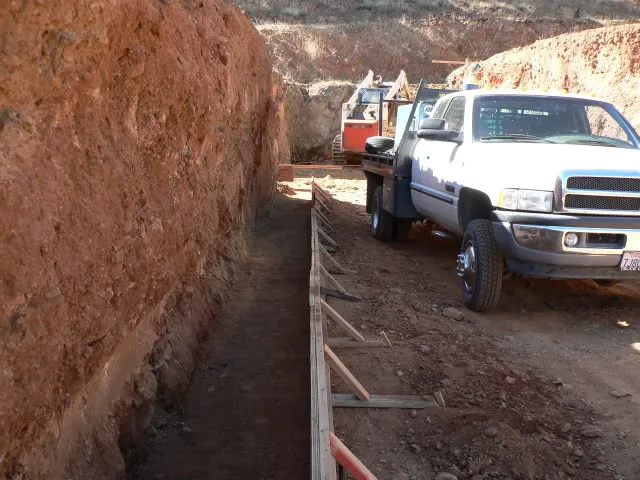

In this project there are only two concrete stakes holding the forms in.  The rest is solid rock so we are drilling through the forms and braces and into the underlying rock with a 1/4 inch drill in a rotohammer and anchoring the forms with 60d spikes driven into the rock.

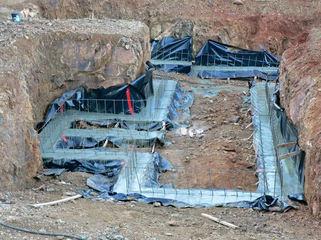

Getting ready for a pour on the footings.  Passed inspection yesterday but am going to clean out more of a clay bank that keeps caving off before the pour (actually the left side in the above picture).  It is in an old fill area at the edge of the pad.  The rest is mostly rock.

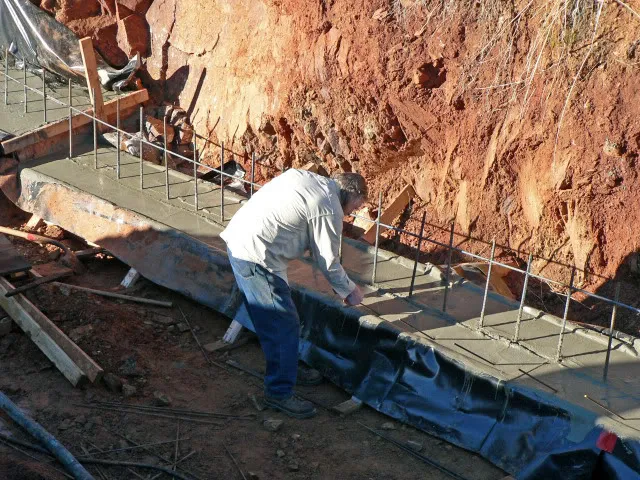

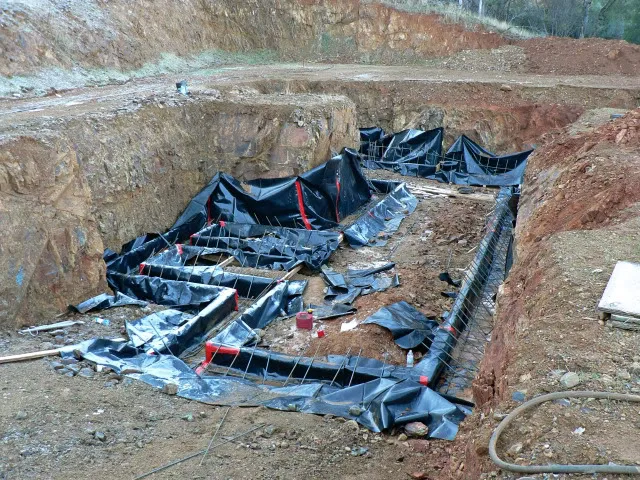

Here is a pix of the forms in place.  The plastic seems to be a bit of a joke but we are putting it in then adding French Drains to be sure that the water doesn't get trapped and work its way through the walls.
Reminds me of kind of a bad Batman Cape --- or how about a Batgirl cape. :)

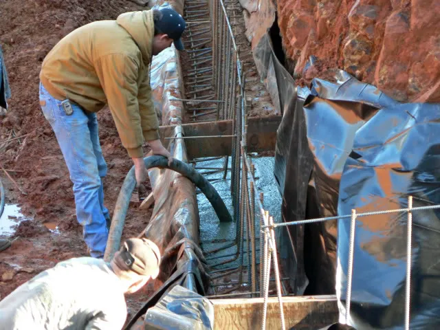

Concrete truck and pumper arrived on site before 8AM today -
We poured right at 300 lineal feet of footing - about 32 yards.
We had a few stepped areas we poured early to let them set a bit so they would be easier to finish filling later without slumping under the form.
We came prepared for all kinds of problems - even expecting them in the conditions we had to work in -- most of the forms - about 90% were nailed right into the rock.  I was wondering for a while at first why I took this job - it was a struggle but we kept at it until we beat it.  Footings went in without a problem.  No popped forms - about 1 shovel full boil out - that was it - near perfect.
