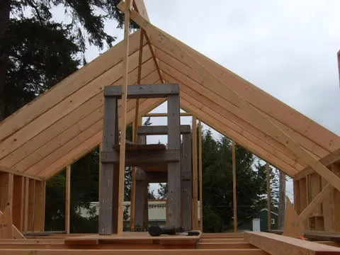

Here is a picture Pa Kettles 14x24 from the loft end:
It appears the gable was constructed within the end rafter. I can't help noticing a small gap between the end rafter/gable wall studs and the first joist.
Is this an illusion?
Thanks again for your patience
"A spoonfull of sugar helps the medicine go down.."
It's possible layout may have started from the opposite end leaving a little gap or he may have had some other reason, but more than anything, how it is actually done is not as important as laying out to minimize waste while staying within the structural limits of the members and design.  In other words , layout cannot be on 24" centers for both the inside and the outside of the same house due to wall thickness, so actual as built design may vary but the end result will be the same.

 What I see , and I don't think PK will be offended that his photos are being used to explain a point , I hope  :o
Ok what I see is first rafter , is the eve/ soffit over hang rafter commonly called a barge rafter, verge rafter, rake rafter , all the same part just different areas use different term , i was trained in R.I. we called it a rake board / or rafter, the trim board we used to nail to that rafter was really the Rake board.
 The second rafter in is the real rake rafter , it is flush with the exterior framing and the gable sheathing should tie the lower wall to the rafter end , IE Sheets should break on the top plates nailed the snot out of that seam , and then go up and tie lower and upper wall together.
That first joist has been moved away from the rake rafter by 2" to clear the way for those gable studs to set fully on the lower wall top plate , the joist shoild have been , MTL HAS been, nailed to those studs , rafter layout was pullled from the rake rafter to put the rafter what appears to be 16" OC , the rest of the joist are nailed along side there respective aligned rafter. so all the joist , except the end two should be on layout for interior sheet good .
