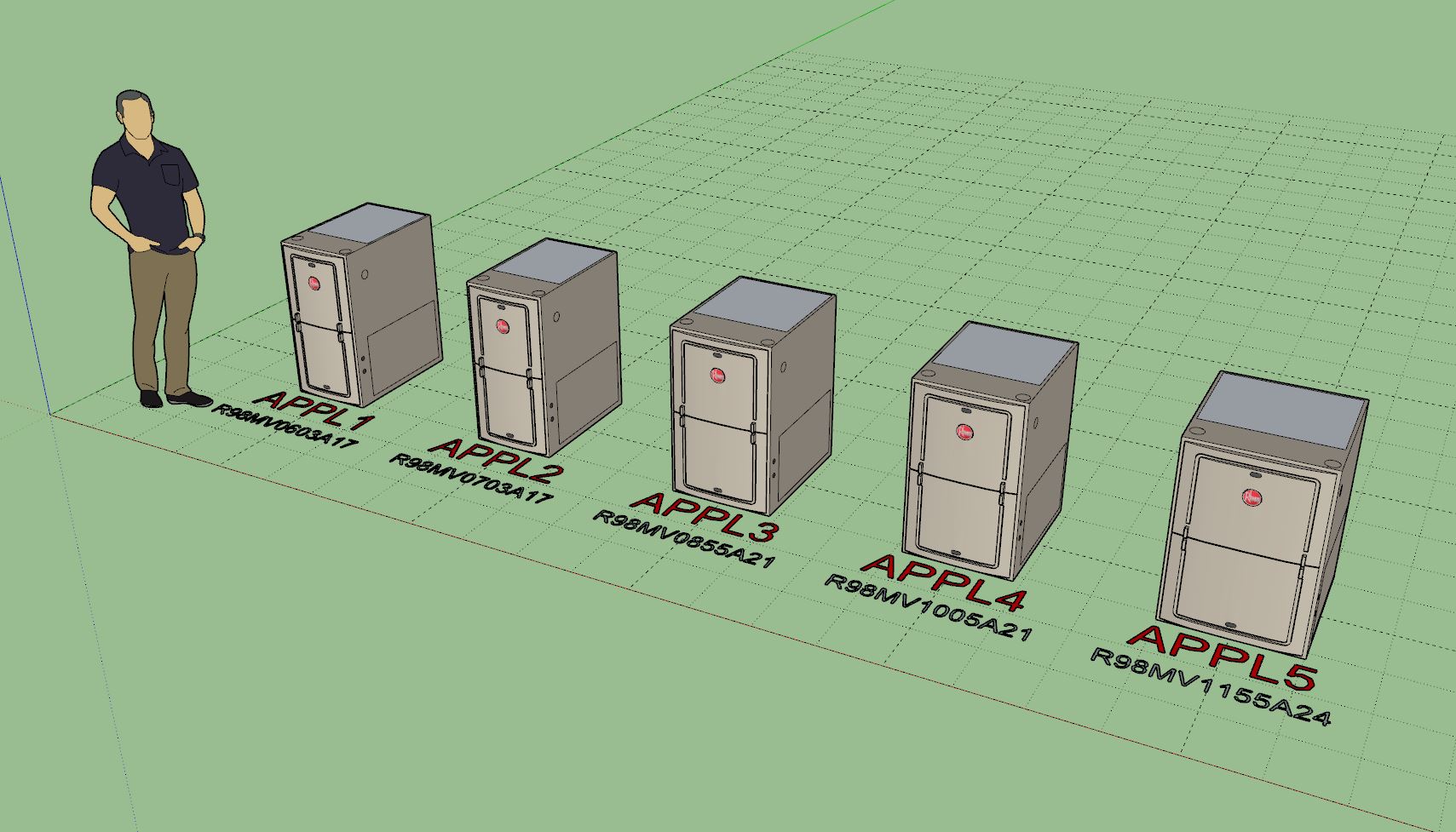

Medeek
Version 0.9.1 - 07.29.2025
- Updated the draw and edit menus for HVAC appliances.
- Added the following brands and associated models into the HVAC appliance built-in library: Bryant, Rheem
