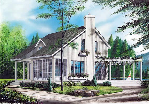

Here's the exterior elevation of the house

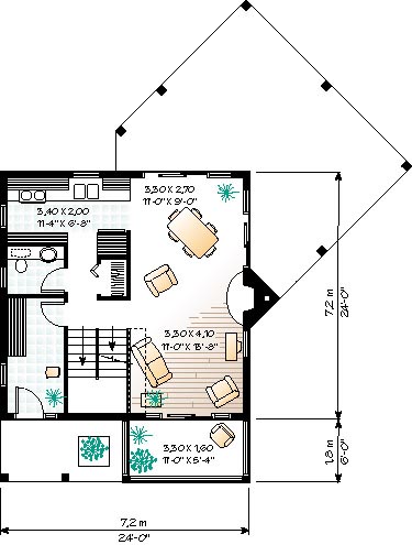

Here's the first floor.  We're running the front door through the sunporch and turning the entrance room into a big pantry(gotta have somewhere to keep all the wine and cheese I make :))

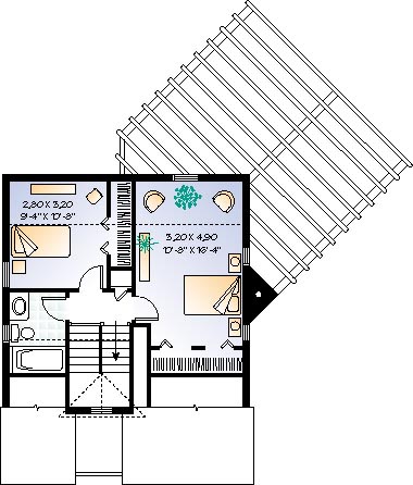

Here's the second floor.

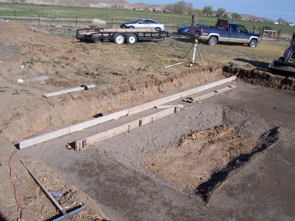

We rented a backhoe to excavate for the foundation.  We've hired out the actual concrete work.  Here the forms for the footings are going in.

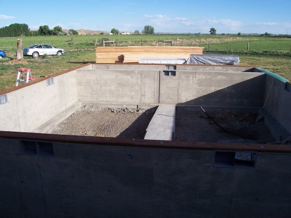

The foundation is done and waiting for backfill.  We've started putting on the sill plates.  The contractor put the bolts for the plates about 1/2" too low and we're having to chisel out each one to get the nuts on. >:(  This is the view out the front door of our trailer house.

We got all the first layer of sill plates on.  We're doing a double sill plate so we can put the I-beams wherever we want.  Fortunately we'll only have to drill holes for where the nuts are.  NO Chiseling!!

Cute house!  Do you have any other exterior renderings?

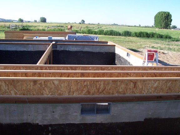

Our center beam and the three whole joists we got on last night.  You can see our cement floor and the sump we put in, just in case.
