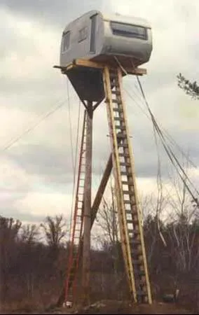

What I would actually like is to make a lookout with a great big log and ladder sticking straight up over the trees so I could see forever...  hmm
maybe something like this... [crz]

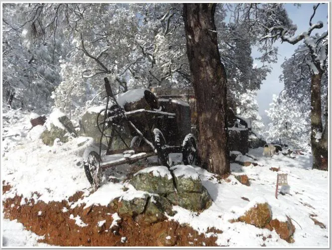

Got a couple of shots of my old concrete mixer while I was out in the snow yesterday.
It does still run and work if I care to work hard enough to get it started.  [waiting]
I think it is from sometime in the 1920's
poppy
You've got some post card quality pics. there Glenn.  [cool]

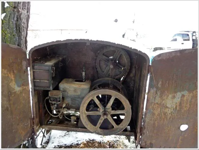

Is that mixer engine one of those hit-miss types?  My nephew has restored one to use with an ice cream mixer; pretty neat.  I have a pic. somewhere, but can't find it.
Yep.Hit n miss.We got an old fairbanks at the shop.I think it's fairbanks.  ???
Thanks, poppy and ben2go.  Yup - hit and miss.
I don't remember the brand the engine is but it is hit and miss.  Note the aluminum parts you can see in the picture just ahead of the flywheel.  I cast exact replicas in aluminum  and installed them in place of the originals.  The originals are in the tool box so that I could use them as patterns for making replacement parts for other collectors.

I have been collecting the hit and miss and other antique machinery since the late 70's.  Not a fanatic but I still get some occasionally.  They call them hit and miss because they only fire when necessary to keep governed speed up.  When the RPMs slow down the governor allows the trip lever to catch again and cause it to fire.  The rest of the time it is just coasting until it gets a load that slows it enough to fire every time, thus the name.

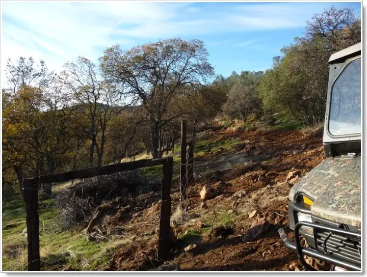

I got the weird idea I wanted to put the property and spring to work so when offered the chance to get some calves I did, but the lady who is taking care of them (a neighbor/customer/friend who got them for me)  checks once in a while to see how my fence is doing so I figured I better get cracking.... [waiting]
I completed about 330 feet of it  (straight across in front of the Bush Hog) this morning (started previously) and got a good start on another 240 or so feet today (the left down hill).  Posts and braces are in - wires strung - need to be fastened and stretched.  Probably only about 2500 feet to go and 2000 feet of old fence to repair.  [frus]
The hill is so steep and muddy that the Bush Hog won't go back up it.  I have to continue down to the road below.
