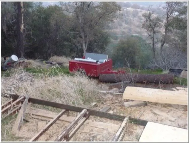

except this one..... [scared]
It decided to head down to the next terrace below the mill level ( about 20' elev lower) and attempt to smash my little red trailer... [panic]
These are bug damaged Sugar Pine and the larger ones average 20" to 24" dia and 16'6" long.
Looks like some pretty clear and straight logs.  They didn't even cut them up into unuseable lengths either like so many people do when they fall over a road.  They are so interested in just getting the road open at any cost.  Lucky find.

I was just trying to estimate the length and guessed around 200 bf in each when I guessed that the average was about (18") X 16' .  The trailer length was throwing me off.  ???
Yes - the trailer is ugly but it is twenty feet long on the bed.  It hauls more when it has all of it's tires and wheels - I lost one on the way back  from Whitlock's cabin the other day.  Oh well - didn't need it anyway... [crz]
