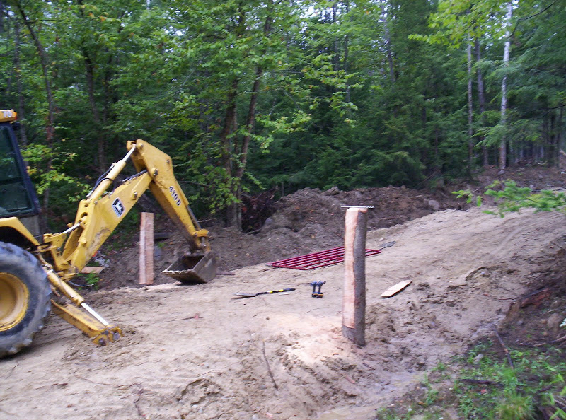

A couple more views of the subterranean shop.  Note that these poles (bottom) are placed on pins drilled into the ground with a rotohammer and drilled into the pole bottom to keep them in place.
The tunnel is visible in the  center  - yet to have the top covered and the piled up earth removed from it. d*
I'm going to use it to get up by the pool with the Bobcat for a final bit of earth moving and leveling for the roof and Hot Tub area.
