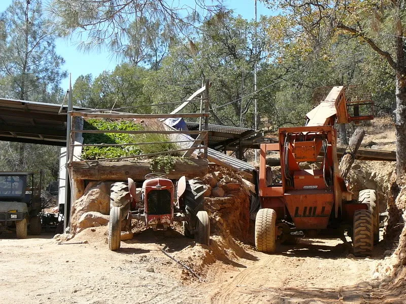

Last day of vacation, I have to make a move on the shop roof over the new excavated area.  I have dug out the entire major area on this side near the shop leaving some of the exit to the other side of the mountain area for later.  It is down around 5 feet but in hard rock so I figured the first section and getting a roof over it is a priority.
The boat dock sitting on the roof will be part of the roof section to go over the area going torard the exit tunnel.  It is 26 feet long x 6 feet wide.   The rest of the docks are 4 feet x 18 feet.  They will go over the room area to the east of the tunnel.
The 6 inch channels near the top are outriggers from existing framing to support the docks.  I will add additional supports on this side of the existing columns.  The docks will be spaced 4 feet with purlins on 2' centers to fasten metal roofing to.  4x10 beams of the docks will be  4 feet apart.  4x4 angle will support the port end of the docks being welded to the channels.  :)
The gutter you see will be a common gutter draining the old roof and the new roof.
Got quite a bit done today.  Decided to use power poles - had a lot of good cedar and treated ones here and don't have much big steel so wood it is.
Here I am taking in the beam that will support the boat dock roof.
It's nice having a little forklift to help with the light work.
The space where the forklift is sitting was a bit of a hill even with the strawberries on the left and the base of the tree on the right.  If the tree dies I will remove it and widen the room a bit more.  I think I may want to turn it into the bat cave.  [crz]
I stood the post up on a 3/4 pin drilled into the rock with a rotohammer and a matching hole drilled - loose fit into the bottom of the post.  I had long 3/4 all thread so used it for a pin.  The Bobcat bucket here was being used for a scaffold.
I also put about a 2 foot all thread pin through the beam into the top of the post.
I put braces from the claystone walls to the post using 60d nails and the palm nailer.
I got three boat docks installed on the roof and beam today.  Two are welded to the support angle.  All 3 are pinned to the beam log with 3/4 x 16" spikes.

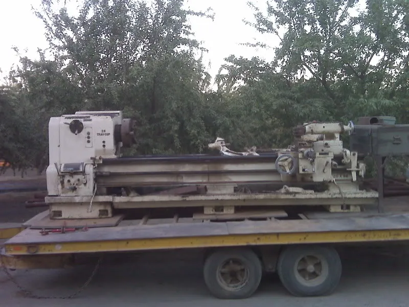

To make the trip to our other place worth while -- where the pipe was, I decided to pick up my lathe and a few other things.  This is the reason I am expanding the shop -- It is a bit large and I needed to get the wood tools out of there.
It weighs somewhere around 8000 lbs, rough guess.

What ya gonna turn on that? Thats a big lathe  :o
Anyting you want right! rofl
Did you put some air in the trailer tires? They look a might low, you know what Obama siad aout tire pressure rofl
I don't think may lathe's quite as heavy,

rofl [rofl2]   PEG, I think I'll throw  log in it and turn it for you.   I always get in a hurry and if the load is not real heavy I just kick all of the tires -- they got kicked all around for this one but that is only about 1/3 of the load I have had on that trailer - you are right - some could have used some air but I was carrying the spare so I knew I wouldn't blow one.  I only lose tires when I forget the spare. :)
That lathe will turn 26"dia x 96" inches long between centers (20" dia over carriage), however with a steady rest on the end I have turned 20" dia pipe 20 feet long for water well conductor casing.  Normal was 8 to 16" dia 4 to 5 feet long to trim ends and keep the well straight as pipe was added on.
A key or something sheared inside so I have to fix that - someone used it in my absence or it just wore out but I'm pretty sure it's nothing major. d*
Just had to get it up here.  I will likely convert it to a gas engine or overhead lineshaft drive like in the old days.  Short on power for a 7 horse 3 phase.  I may be able to get it running on my welder generator - not sure.  I have a home-made rotary converter but didn't bring it - out of room this trip.
I forgot about Osama's tire pressure remark -- he's right but - since it was him I think I will go let some more out. [crz]

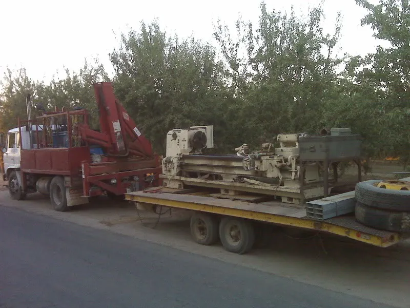

The lathe - I have owned it for about 20 years and was considering buying a new smaller one  - with nothing to pay for it with - so decided just to bring the big one up and make it work - it is still very accurate.
   Did you load and unload it with that boom truck?
   So now you have to get a motor or way to get-er fired up , D cells won't cut it eh  rofl :-X [frus]
