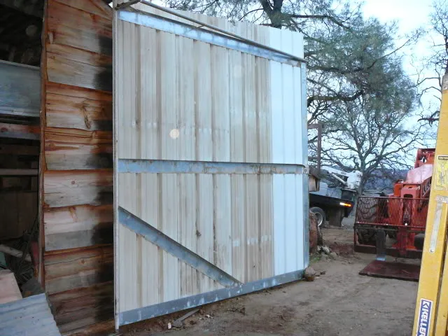

Well -- haven't done much around here for a while -- this year is the year of the prospector...but I decided that I wanted to work on keeping the shop a little drier in the storms as I have projects that could be done in there if the wind wasn't blowing through 60 miles an hour carrying rain halfway across the shop.
Shop floor is even with the peak of the roof of the kitchen area, then its about 16 feet down to the floor of the great room.
My point of posting this is that I made a door for the shop today - worked a bit on it yesterday.  Yeah -- it looks like crap but it was free.  Sheeting was left over from a building job cleanup.  6x2 1/2"x 12 ga. angle was from a medical building floor.  Pipe was pulled out of a water well. Screws left over from a job.
The door measures 12'4 x 12' with the top cut at a 1 1/4" / 12" pitch to match the roof.  The pipe at the top is a torque rod to keep the far end from tipping in or out.  The entire left vertical 1 1/4" pipe is a hinge - pivots on a spacer over a 1" pipe- set on a plate for easy removal if repairs are ever needed.  The top pivot is a 1" pipe welded to a plate.  I shot a laser to the top from the bottom pivot point for center linup.  The bottom mount is welded to a concrete stake driven into the claystone and a 1/2" wedge anchor into the concrete.  It is very light -  everything supports everything else.  Sheeting is used as a diaphragm to keep the door square.  Corners etc are welded.  Sheeting stiffens the triangle brace to the bottom and the ribs in the sheeting transfer the strength to the top frame member.
1 1/4" .065 tube steel makes a great hanging sliding door frame and would have worked on this but I didn't want to buy anything, and there was no room for a slider.  Framing could have been the same though.
There are strawberries growing on the sloped roof behind the door.
