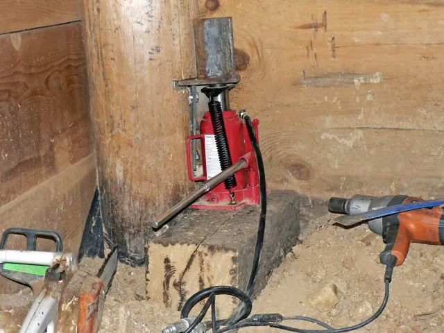

While nearly none of the posts supporting the roof have any problems where they are pinned above the ground surface, sitting on a thin vapor barrier and a couple inches of concrete, there are 3 posts that do have a problem.
In trying to stay away from preservatives, Mike suggested charing the bottoms of the posts and putting plastic garbage bags around them to preserve them.  This may have worked without the bag, but it will get a break in it and once it does water can enter or the water in the log will drain to the bottom and wet the bag inside.  This begins an apparently long cycle of decay as the moisture can't leave and more enters staying in the bag.
In 5 years I noticed the doors at that post begin having alignment problems.  My first thought was diagonal bracing and that I didn't have enough, but that wasn't it.  The post was decaying in the bag and getting shorter - I would estimate about 3/4 of an inch in 5 years although I think this loss will start increasing  soon.  With the design of the Underground complex repair is not a problem.  Only the affected post(s) need be repaired.  The rest of the entire structure is hinged through the rebar pins holding the logs together so can move up or down freely.  Mis-alignment does not show in the garden on the roof as it would in conventional housing.
The post can either be jacked up and the footing repaired or replaced.  Only the bottom is damaged so I chose to jack it up and repair the footing.  I welded up a bracket to support a sufficient amount of the post and allow the repair work to be done.  I used a Harbor Freight 20 ton air assisted jack ($69.00 on sale) but used it manually as there was only about 8 to 10000 lbs on the post and I didn't have far to go up.  Total time so far is about 1 hour.  Probably a couple more to complete the repair.  The post went right up and the doors are back in alignment.
Note that this post is in the corner under the bridge near the kitchen.  Doors affected were 1 French door and the door going from the kitchen to the uphill patio.
#529
Water's always the devil.   >:(   Handy little lift bracket there. Slot by chain saw? I'm waiting to see what you do about the bottom end/support.
(gotta go back outside and do more painting. )
Yup - I extended the plate into the wood a couple inches to get plenty of meat in case the lag bolts wanted to stress the wood fiber more than it wanted to be stressed.
I made a similar bracket with a 1" jackscrew and put it on the near side.  I think I will probably end up concreting around the bottom and building the post into a rock foundation.  I think I will try to support it from both sides after the jack is out and separate any fungal growth from it's source of moisture - It will then dry out and remain solid above the damaged area.  After it is stable i will put a reinforced footing under it.  It will have to bridge the original hole.

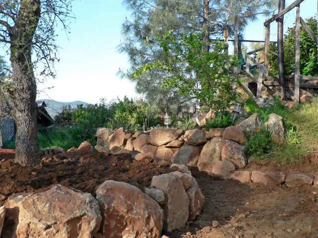

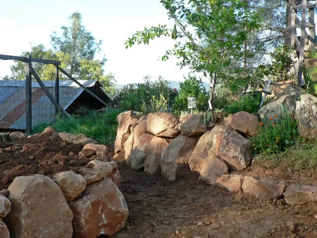

Suns up so got pictures to prove I actually did some work.   It was dark on completion last night.
Sassy wanted walkways and raised beds so here is the walkway.  Wall on the right is about 24" to 30"  tall.
I used a timber peavy on the biggest 5 or so rocks to help roll them or stand them in place.

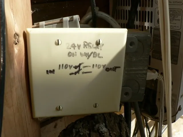

This is my relay setup using 2 Ford car relays in series to get a 24 v coil then they control another 110 v relay that can be triggered from either the overcharge dump load on the wind generator or from a cheap 15 minute increment timer to turn the pump on and pump water to the storage tank.  We pump about 500 gallons per day for the garden drip irrigation system and a sprinkler.  This uses excess power for pumping rather than burning it off with a heater and wasting it.  The wind generator cannot be taken offline or it will over speed  - excess power must be used or burned off.
