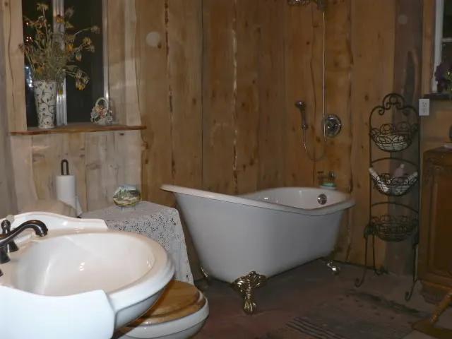

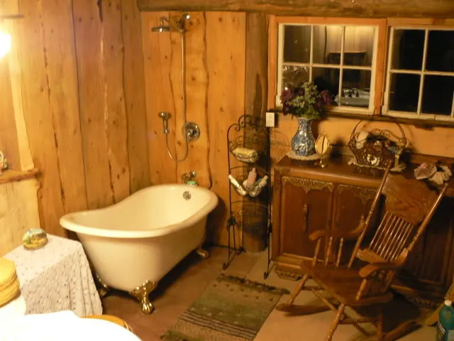

Sassy made me work on her bathroom so I am posting a picture of what we did -- actually I wanted to get something done there too--- just the little problem of getting around to it.  I can't finish the walls till I finish the wiring, the plumbing, the floor etc-etc.
The floor is once again the India style plunger pier floor -jute reinforced 1" thick concrete- I added extra piers in the area of the legs of the tub although it would likely have not been necessary, but being one of those rush jobs where there is never time to do it right, I thought it would be prudent.  I put piers every 6 inches around the edges since the existing floor was not joined to this one.
Color was added on  the top layer only- dump and smear technique -- rocks were simulated with the trowel.
The new floor is only in the area under the tub - it was originally going to be a shower but Sassy found a tub she wanted.

That looks awesome (especially the paneling)
#356
Thanks, Bart.  The paneling is White Fir logs, sliced 3/8" thick and untrimmed both edges.  It is done board over board (one down- one up like board and batten) with enough lap to keep the underlying edges from showing.  They are nailed down with 1 3/4" brads and the seams are also kept tight with brads shot in as necessary.
The area around the tub is waterproofed with DEFY.

That is a neat tub. Not everyone would have the right place to situate something like that. looks like you did well again!

Sassy found it on the net at a reasonable price.  It is a reproduction .
Sassy decided that the best faucet was a nice brass hose bib - looks a bit old - couldn't do much about the shower valves without selling an arm or leg.  Besides - I already plumbed it for a shower.

Cute tub.  Is it 4 feet long or (the much more common) 5?
Amanda, it's the 5ft model - I wanted to be able to stretch out my legs - my feet just touch the other side so it's just right - any smaller, I'd have been cramped up.   :)  I'm really pleased with how the bathroom is turning out.   :)

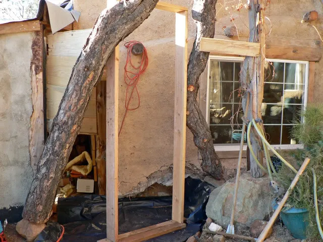

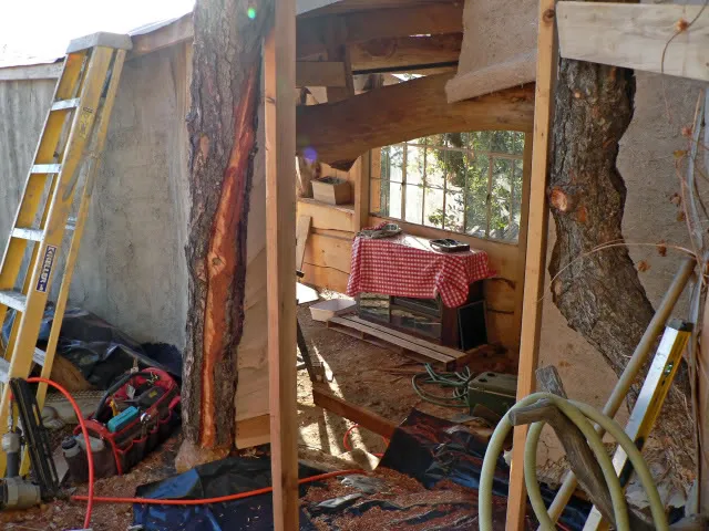

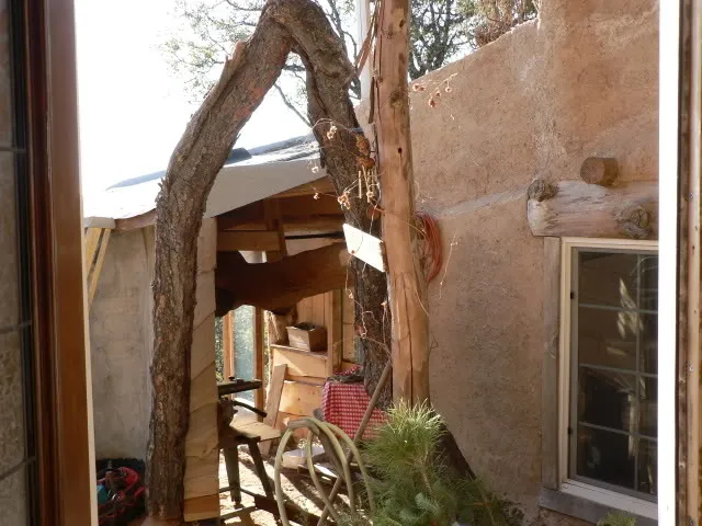

Here's what I've got.  Sassy has given me a deadline of the December 16th barbecue and family/friends  get together (you are all invited BTW) to get something done on the cabin so it doesn't look the same as it did last year.  We don't want people to think I've been sitting on my bum for a year.  Her dad asked if I had it all closed in, so I thought that might be a good thing to work on before they make their pilgrimage to the underground command post.
This is the shortcut archway and door frame from the front main entrance of the cabin to the laundry room which is now in the lower level entryway.
I leveled the ground with a pick, shovel and my 4 foot long Big Johnson.  This was rather like work.  After putting down a vapor barrier I put the PT wood door frame down.  It was nailed directly to the hard clay with four 60d nails -6" long.  I tested the ground at over 200 psi with no problem - that works out to 28800 lbs per foot.  Who needs concrete?
I wanted to try to leave the bark on the trunk but in case it comes off later, I am grooving it down to wood with the chain saw.  This is actually a tree that grew about 10 feet then got it's top broken toward the ground and it kept growing.  The leg on the right is actually the top of the tree.  It is about 6" dia.  The trunk is about 10" dia.
Looks pretty cool, Sweetie - oops, forgot that I wasn't supposed to use endearments on a public forum, sorry, Baby...  ::)  Thank you for not keeping me in suspense for several days until I get back up to the underground command center - at least I will get some sleep instead of wondering what in the world you are doing... very Hobbity... I like!

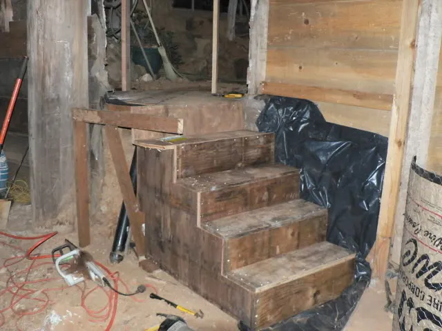

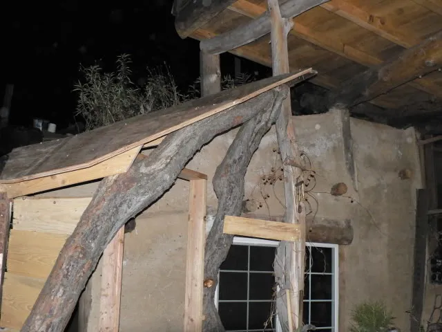

Sassy's working and demanded another update so she made me go out in the dark and take pictures.  She gets to look at break time and can't stand the suspense. :-/
Here's what happened today.
The roof sheathing got put on.  Full 1" plywood - I don't care for plywood but it was given to me free - pallets of half sheets - actually fruit bin bottoms near half a sheet in size.  Free makes me be within my guidelines of not being expensive or recycling. :)
The steps and landing are made out of it also.  I got treated wood from a cleanout sale at the lumberyard so used it under the plywood but still put plastic below it.  The entire stairs and landing is going to be covered with colored stucco.  Since I found out that stucco is an ancient art invented and used by the Romans, it is allowed also.  It minimizes materials used as far as concrete goes and is a pretty final solution.  Not much rework ever needed (ferrocrete if you don't want to call it stucco.)
Elevation was such that I either had to add another step or make a bit of a steep stair.  8 1/4" per step.  Steep stair it is - this is just an alternate way down to the laundry and great room.  If I can't do those steps I can go around. :)
There is a 12" or so diameter tree overhead as you go down the stairs -to the right that I had to allow clearance for plus get the person low enough to get under it without hitting their head.  Fred tried it out and it was a success.  He's about 6'6" and didn't hit his head - I have over 6'8" in all locations overhead.
