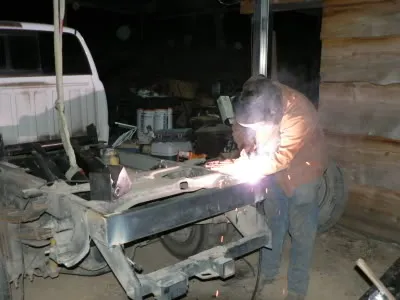

New toy at the Underground Cabin.  I got a new (used) 1999 Dodge 300 HP 24 Valve Cummins 4x4 dually with a 9' flat bed and beefed up overloads and main springs.
What does this have to do with the Underground Cabin?  Lots.  The 4x4 part will get me up the hill in the winter when it snows and muds ...   or else get me stuck so bad I won't get it out until spring. :'(
This picture shows me welding -- thanks to a camera timer and the Gorilla Pod a friend gave me-- wrapped its little legs around a piece of steel and shot myself-a photo.
"What's significant about this?" you ask.  Well -- its welded, cut, fitted, bolted etc. using 100 percent solar power.  Not hooked to the grid and I can still do pretty heavy duty jobs with my own power.  I added four 40 watt panels today.  They didn't seem to be helping sitting on the ground by the side of the shop.
Today I am making the flatbed into a dump bed by adding a hoist --squeezing it in with only fractions of inches to spare.  This will dump loads of dirt, lumber, blacktop - nearly any thing I want to dump -- well --- maybe not those bad burritos I had the other day but everything else... :-/  The hoist is rated at 14000 lbs -- hope I don't overload it.  This thing will be handier than pockets in my underwear. :)
For others interested in this sort of thing, I bought a new saw the other day -- It cuts steel the way you would cut wood -- a few seconds slower but not much -- It cuts cold - the blade runs at 1300 RPM and will cut 4"x 6"  heavy steel tubing or anything smaller - does 45 degree miters on smaller stuff.  I cut 5" standard channel tonight.  A piece that I cut off is in the saw.

Wow Glenn, I could sure ask a lot of questions but I will keep it brief. Is that a 110 volt wirefeed or do you have stacked inverters to give you 220 volts? What do you have for battery storage? Seems like a welder would draw it down fairly rapidly. OK, I will stop there for now.  :)
#327
No problem, desdawg.  Ask away.  It is a 110v wire feeder -Miller 135.  The miller 110v wirefeed is MUCH better than the Lincoln.  It welds on longer cords with less trouble and most important is the motor frame is aluminum -- Lincoln is plastic and it breaks -I broke 2 before I learned my lesson-- good thing - the Miller is so much better I consider the Lincoln a toy for people who don't know better.  I am doing 1/4 inch welds.  I used it for a couple hours last night.
I have 12 L16 batteries -375 amp hours at 6 volts each series/parallelled for 24 volt system.  I pump 600 gallons of water per day and run a freezer and refrigerator full time too plus everything else most places have.  Not totally camping out here.  I run 2 Trace 4000 watt sine wave inverters stacked together to make 220 also for my standard 1 1/2 HP pump pumping from 320 feet -Static water is 169' -draws down to 320 in about 40 minutes at about 10 gallons per minute rate.  Has to recover as well produces 1 gallon per minute.  I have a 1000 watt wind generator -seldom producing over a couple hundred watts or less, and about 2000 watts PV panels if I remember right.

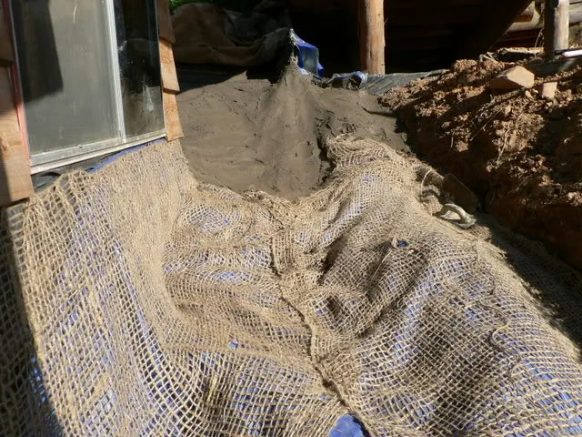

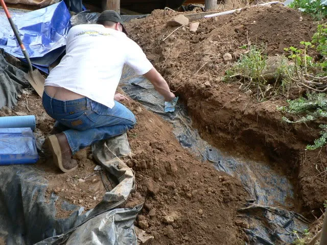

If you follow Mike Oehler's revised  instructions and use EPDM or his simple shed roof structure you are not going to have too many problems, but if you get weird like me you may have an occasional problem creep up.  One thing I have noticed is that as Mike stated, the gophers don't seem to bother the plastic but they will scoot right along it merrily digging their trails.  They think that nice plastic floor feels good on the little ones feet, I guess.  In my case, there are a lot of rocks in the covering soil so inevitably, there are a few punctures in the plastic.  When the soil is tight against the plastic capillary action pulls the water away from the hole or at least keeps it from running through.  It just creeps in and out through the hole-- but get a gopher hole over a puncture and things get wetter.
This year -- the 4th year, the little ravine where the lowest point of the twisted ribbon roof and the corkscrew roof come together had a leak.  My wife said I should fix it so I didn't look like a failure to all the people on CountryPlans.  She has this way of twisting the facts. :-/  Maybe she could get a job in Washington D.C.
So I did it.  I used the help of Fred - my associate in my various ventures.  You remember
Fred.
Fred and I dug fairly carefully down to the upper moisture barrier on the roof.  Here he is sticking Bituthane or Grace Vicor patches on the plastic where we punctured it digging out.  Yeah -- I know -- Vicor is a bit high tech but I didn't have much time and it was given to me free, so doesn't violate my policies.  Next we put a double reinforced poly membrane into place (read that we stapled a Costco tarp to the wall)  and we left it fairly loose then sealed the entire upper edge to the good existing moisture barrier on the roof with strips of Vicor.
On top of that we fastened jute erosion control fabric then plastered it with stucco to make a more permanent surface similar to the Indian light duty concrete floor.  If the UV is kept from the plastic it will stay for years -maybe hundreds.  Since this is an area we walk on it was more susceptible to damage.  Landscaping will make it look like a mountain stream bed and things underneath will stay dry.
Repair time was about one day.  I have a few more improvements I need to do before winter sets in.
Just checked it a few minutes ago and --- Yup - it's drier than a popcorn fart. :)
