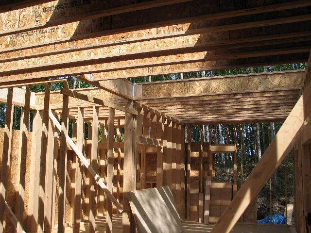

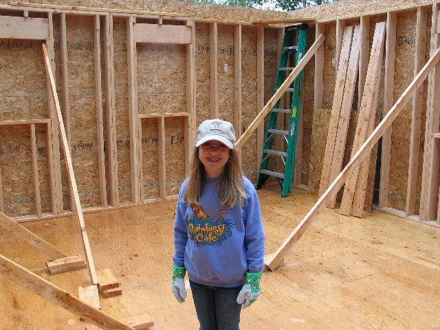

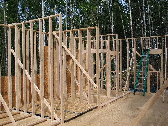

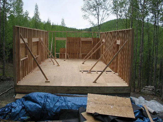

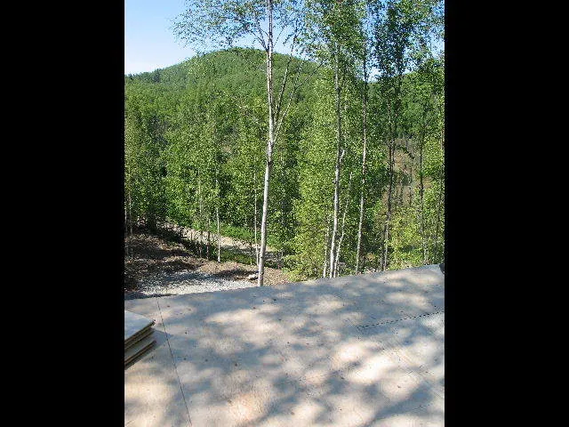

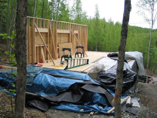

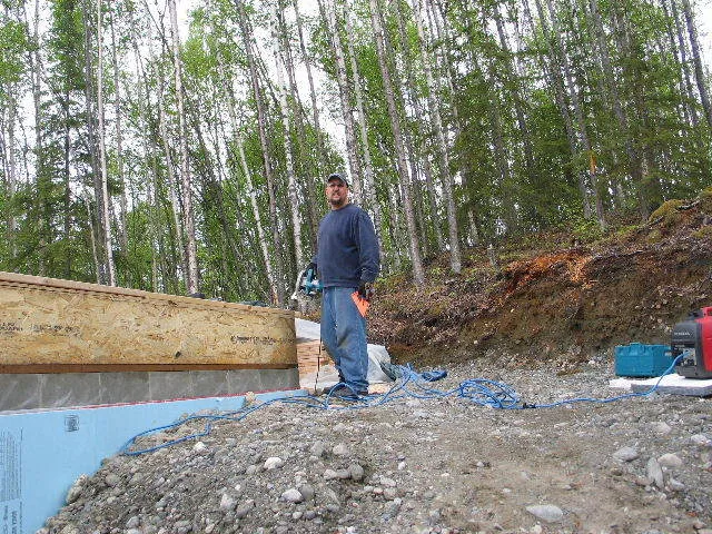

Finally some pictures :) I hope, sorry they are out of order, but at least you can see the progress we are making.  We have the second floor deck (or third floor if you count the walkout basement) on and get our lumber delivery for the second floor walls this friday.  I have the roof trusses scheduled for delivery the week of the 4th of July.
Memorial day weekend
Daughter testing a door opening
second/third floor joists
first floor walls yep they are 10 footers!
Daughter just loves the ladders
interior walls
wife helping out finally!!
view from the back
view to the pond/wetland where the moose hang out.

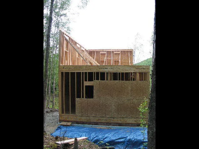

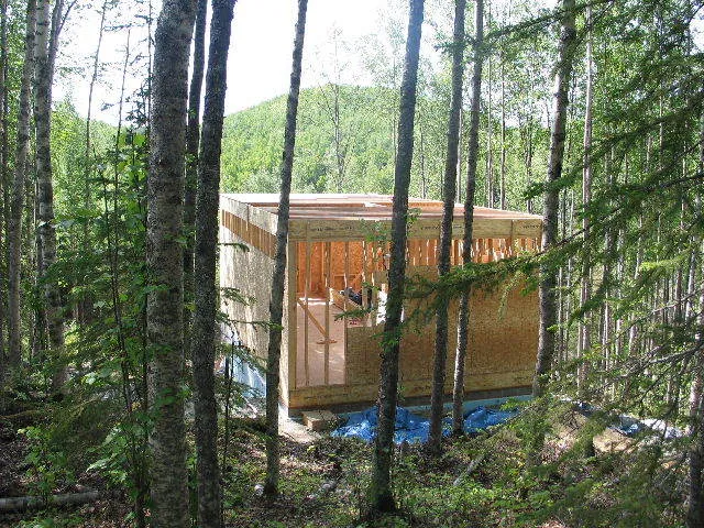

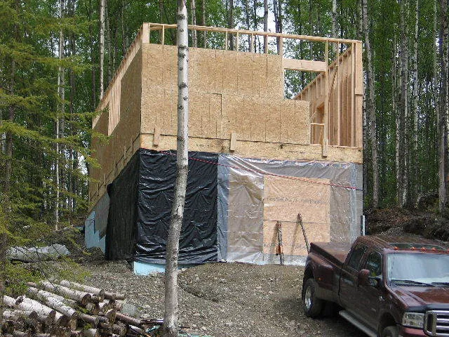

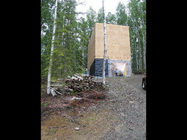

here are some recent photos
The first two walls on the second floor.
my little helper
the tower from down below
