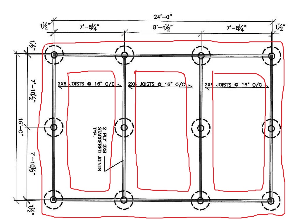

Long-time lurker here, who is finally starting to plan his first build. So far, I've intended to build a very similar foundation to this:
What I am wondering though, since this image suggests piers, is that if I wanted to maintain the same support points both on the perimeter and the center two piers, How would I build a full foundation?
I am dealing with a code frost depth of 60" in northern Minnesota, so I have to go down a ways. I am NOT dealing with code however, in the area I will be building. State-wide soil survey data suggests surrounding areas are clayey-loam so I have assumed a 1500lb/sqft soil bearing capacity. The water table is a good 10 feet below the build site.
My goal in asking is that many users on here seem to try the pier foundation method, and there are ample warnings of "doing it right the first time" with regards to piers being less stable than full foundations. I want to do it correctly so nothing moves.
What I've imagined this entails is building a perimeter footer of concrete down below the frost line which is 16" wide and traces out the 16x24 and cross-members. Then, attached to this are 8"x8"x16" cement masonry units, hollow, which I build up to grade. The footer is crudely represented here in red overtop the original pier image...
Understanding that this is probably the most backward way to get support to that center floor area, and that I could do with just a perimeter, is this the "right" way to do a full foundation that is sturdier than piers? I understand with the concrete continuous footer as is, I would have ~144sqft to spread out the weight of the cabin onto. About 550#/sqft for the cabin if soil capacity is correctly 1500#/sq. I do not plan to use the foundation as a basement due to flooding concerns: I'll backfill around the perimeter with gravel and the inside will be filled back to grade minus enough to leave crawl space. With soil inside and out of the cement walls, do I need to fill the CMU's with rebar and cement or can I attach them with mortar and have a strong enough structure?
Any pointers or pictures? Going to ask lots of questions as I soldier forward before doing anything dumb or costly here... I want my final cabin to stay standing!

Yeah, definitely want a continuous perimeter foundation. On the interior, there is nothing wrong with piers to support loads that can't span the 16'.
The diagram you have doesn't really make sense to me once you convert it to a perimeter foundation, though. You would want a built up beam to run parallel to the 24' wall, and want your joists running the 16' length.
That beam doesn't necessarily need to be midspan, either. If you have a second floor that would need support from posts, you might want those posts offset from center to not interrupt the space downstairs. For example, in my house, the posts that support the second floor are located at the corners of the stairwell (this is just one example of why John Raabe's plans are a great starting point for your home or cabin).
Sounds like you are planning a crawlspace. I would set the beam below the joists, and run the joists straight across -resting on top of the beam- the full 16' feet.

Good to know. Continuous Perimeter is much more stable to frost and earth movement compared to piers as I know. Running the cost on it all doesn't come out too much ahead of piers either, which is encouraging.
Is what you're saying that as the image shows, the beams span the short length and what I should do is instead only have built beams span the 24' length and joist between?
I want to avoid spanning the full 16' as a continuous piece of lumber so I can use 2x8 for the joists instead of 2x10 or 2x12... I can still do this if I rest the joist on the beam and not at the same level as the beam, I think.
Any reason why joists shouldn't run the short direction? I see this a lot on here and can't figure out why other than convention...
I am okay with the posts in the middle thirds where the piers are in those images mainly because I want to run a post to the ridge beam of the roof. I understand this will reduce the already manageable wall thrust from my planned 12/12 sloped roof.
Back to the foundation though... I will definitely run around the outside 16x24. Is it okay to leave the hollow-core CMU's unfilled and still have enough structural strength to hold up the building? Or do I really want to fill those cores? Do you suppose frost can get a hold of the sides of the walls and still heave the structure? I have 0 intuition on what would happen, other than that I know there will be some deep frost most years.

NathanS has described exactly what  I was thinking about the perimeter foundation and having the support beam running east-west rather than north-south.  Putting your joists on top of the beam means you don't have to mess with joist hanger brackets, although you will want to tie the joists to the beam and sill plate.  For your interior support beam and piers, you can also break it up into two separate beams if that helps for wall placement.  That's only useful for when the walls are load bearing, but if you're looking at a loft or 2nd floor then having bearing walls makes things a lot easier.  You'll want to bring your CMU wall about 18" above grade to keep water and pests out of the wood framing.
ChugiakTinkerer
For standard floor loads you can run a 2x6 on 16" center with a span well over 8', almost up to 10' for most #2 graded lumber.  A continuous 16' 2x6 joist supported by a 6" beam in the middle and resting on 6" sill at each end only has an unsupported span of 7' 3".  No problem with a 2x6, and would be much stouter with a 2x8.  Without that support beam in the middle then you would be looking at a 15' span and that would take some very tall joists.

A lot going on here. Chugiak offers some good insights already.
The reason to run a built up beam the 24' length is because it is much less work to do it that way. You just have to dig/pour a couple piers and then nail together your beam. Just for this example, if you went with 2x6 joists ( actual height 5.5") you could set the top of the beam down 5.5" and simply run a 16' 2x6 the length of building (the bottom of the 2x6 would rest on the beam where they cross). This is faster than running joists the other way, because you will have to do piers for two separate beams and then you are also going to have more than one piece of lumber for your joist span. It's not a huge deal, but it is definitely faster and easier to do it the way I am saying.
As for leaving the CMUs hollow, this will vary somewhat with local conditions. Hollow CMUs have the compressive strength to easily hold virtually any 2 story house. The reason you would fill the CMUs is if you have rebar reinforcement in them. The purpose of the rebar is for shear (horizontal) strength. In a basement, you might have soil piled against the wall 5 or 6 feet higher than the floor - that weight is horizontal pressure that usually requires rebar, which requires filling those cores with rebar. Rebar also gives a building a better chance of surviving an earthquake.
If you are going to do a ridge beam, you'd likely need a post or two to support it along that 24' span. In that case, you'd want some piers centered under your foundation.
It may sound like this is a lot of stuff to think of, but think of the process as something iterative. Roughly design your foundation, first floor, second floor, roof. And see how one impacts the other. Go through this process dozens of times and eventually you will have a cohesive plan. Posting it here you can get some useful input, but keep in mind we are all amateurs as well. It is very wise to keep you building as simple as possible, and stay within the prescriptive code even if you don't have a code officer stopping by every once in awhile.
