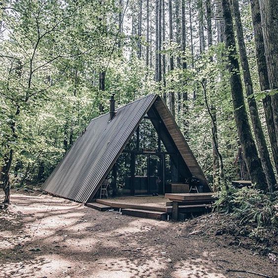

I echo the concerns that KenHill mentions. Also, in the image, note the way the roof to ground connection leads to water soaking into the rafters and floor framing. This is never a good idea.
Hi John!

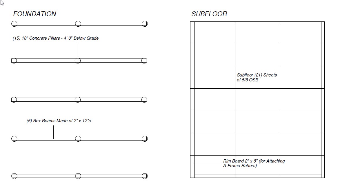

Agreed. I am in the process of putting something in place for my own protection financially, and with respect to liability. As for the one pictured above. That was more of the inspiration to build this design, and will almost in no way resemble my finished product. That was my first thought as well. Seems like that design leaves itself very vulnerable to moisture underneath. I will be resting the dwelling on 15 4 foot cement sonotubes. Here is the foundation design I plan to use. I looked at many options(but would love to hear more feedback), and after speaking with many on the matter, it seemed the one pictured below was a solid design, without going too expensive. 2x12 doubled up box beams, 2x10 green treated joists, finished off with some 5/8 treated plywood. Might have some lattice, but other than that, will leave the underneath fairly open to allow it to breath. Let me know what you think. Cheers
