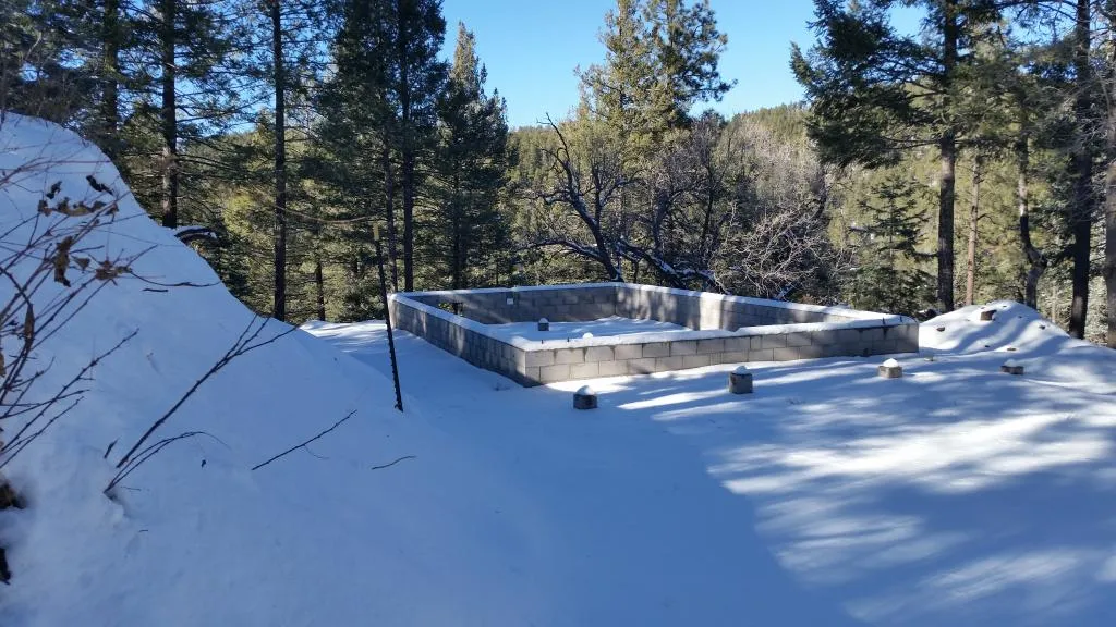

Bought an acre south of Prescott in the fall of 2013. It is fairly remote and at about 7000 ft.  Spent many hours reading this site and figuring out what I wanted to do.
Took me almost a year to get plans drawn, structural engineering, soil engineering, well and sceptic permits and finally recieved the building pemit in Oct last year. That whole process was far more expensive and painful than I dreamed it would be!
As soon as I had the permit in hand I was ready to break ground though and was able to get the foundation completed before closing down the project for the winter.
I will post a few pictures of my progress when I figure out how to do it ???
Cougr67

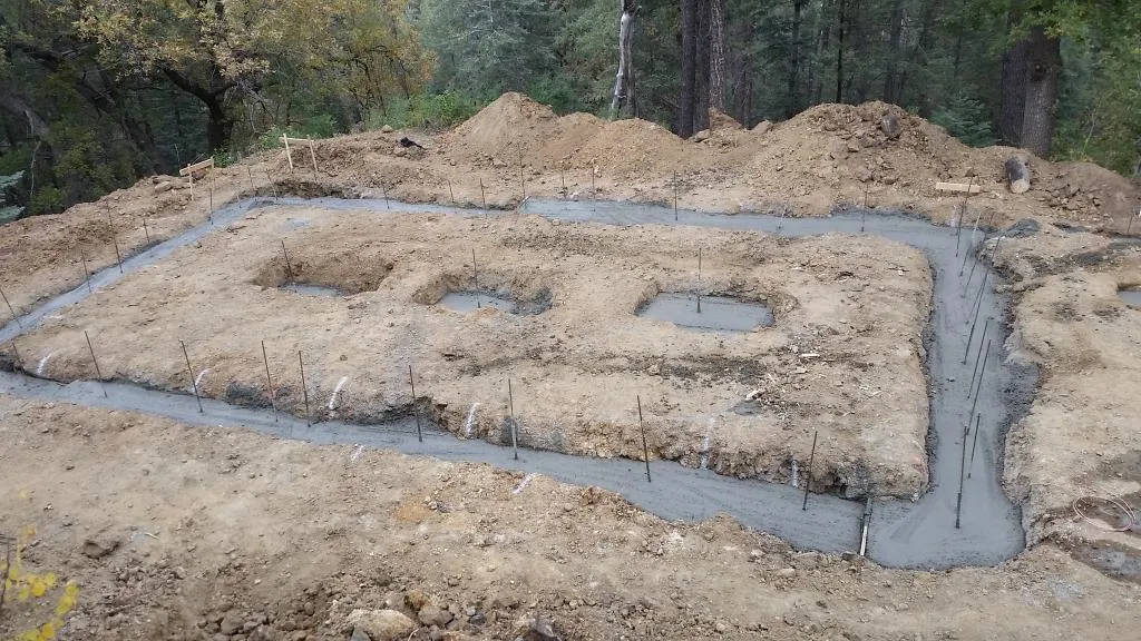

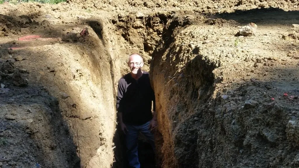

My footing ended up being quite deep. 7.5 feet on one corner due to the cut and fill. Had to dig until we reached native soil.
footings and rebar in place

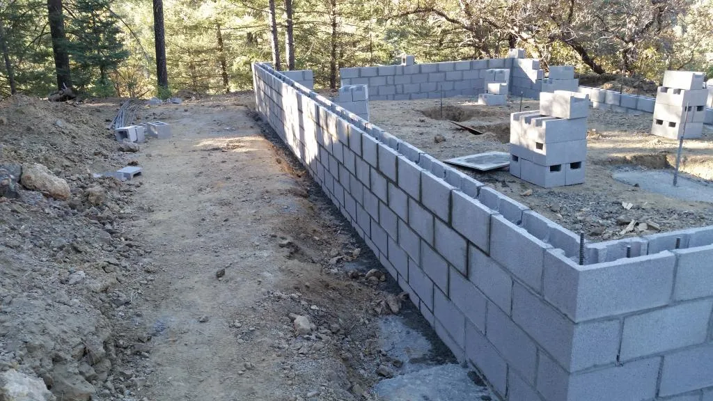

Almost done

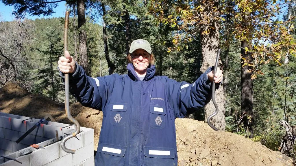

The engineer speced out these huge bolts to be placed into the block, extend up thru the sub floor and attach to the shear wall framing.  Sure hope we got them in the right place because they arent moving. 18 of them total
Done for the winter
Wow! That is some depth and some very healthy sizes anchor bolts!  Looks like a great foundation. Thanks for sharing.

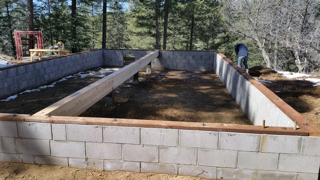

Getting ready to build the subfloor this next week and have a couple questions.
The foundation is not exactly square. On the front of the house the foundation measures 19ft 11 1/2 inch. So it's half inch short of what is was supposed to be. How close is close enough? Can I just let the sill plate Hang over the edge of the block 1/4 inch on each side on that end to make it an even 20ft?
On the north wall (36ft long) we ended up 1 inch too long. This seems like less of a problem, if the sill plate doesn't quite reach the edge of the block at least the entire sill plate is supported.  (This might make sheathing a problem though?)
Am I over thinking this? What should I be worried about? ???

Let me rephrase my real question and see if that helps.
How much, if any, can the sill plate hang over the edge of the foundation and still be OK?
It will only be about half an inch. What do you think ?

I would fudge 1/4" on the with of the building and then let it hang over 1/8"  on each side and call it good. I think you will see it all the rest of your life but no one else will ever notice.
You can cantilever feet over a foundation if you do it correctly. You are fine without having to worry about that though, put the sill down at 20' wide x 36'1" and roll with it, double rim if it worries you. Never underhang the foundation dimension if at all possible it'll cause headaches or a water problem later. Measure parallels and diagonals when the sill is down to assure it is uniform and square, correct there, check and keep correcting all the way up. The roof is more difficult to fudge so try not to.
I arrived at one job to see a foundation that looked like an hourglass, there had been a strong tremor just as the last concrete truck left. The corners held but the length of the walls had bowed in a bit. In the width of the building it was easy to just cantilever a little to keep the floor straight, on the length we stepped in a joist, turned the framing 90* and blocked, allowing a short cantilever where needed in that direction.
I missed the 2 story wall question earlier, studs need to run unbroken from floor to floor, floor to ceiling, or floor to roof... in other words they should end only at a point of lateral support, a sheathed floor or roof diaphragm. Tall walls can require deep studs, very good connections top and bottom and may need engineering.

Thanks for the reply Don. That was not an option that I considered. So, overhanging the sill plate by a full inch wouldn't be a problem? Is this something I should run by my inspector before I do it or wouldn't this even raise eyebrows?
If I needed double plates for support how would those be attached? The anchor bolts would not be long enough to go thru both plates.

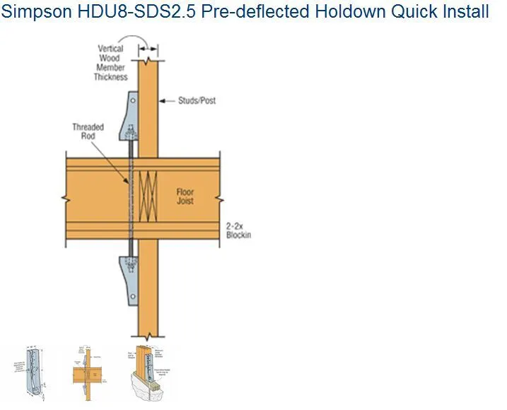

As for my tall walls without a floor for support was engineered. The engineer speced out 12 Simpson HDU8s connected in pairs by a threaded rod. Here is a picture from the Simpson site showing similar installatioin. Mine won't have the subfloor between the two floor though. Those brackets are huge, almost 18 inches long and the rod is 7/8 inch diameter. I have read so much on this site and others about "hinge" points between walls I hope the engineer knows what he is talking about ::)
Double rim joists, not 2 sill plates  ;) It moves the load path inboard over the foundation a little better. Never hurts to ask the inspector, every one has a different take on things.
That connector takes care of uplift, does nothing for a lateral load on it's own. I also don't know all the details so I'm not saying he's wrong.

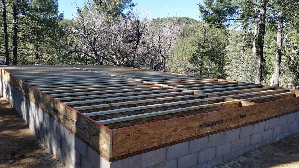

Got the subfloor framing done this weekend and bought off by the inspector.
I have had 3 different inspectors so far and they have all been great. Offereing advice on the next step. giving me an idea what will be expected on the next inspection etc. Easy to get worked up and worried about getting inspected but so far it has been easy

Yep, got the still plates square to the 1/16 of an inch. Remeasured at the point in the picture and we are now 1/4 inch out measured diagonally. Still not bad but I was surprised how easily we lost 1/4 inch. That could really add up by the time you get to the roof if your not paying attention. I will try to get back to square with the first story walls or at least not goo any further out.

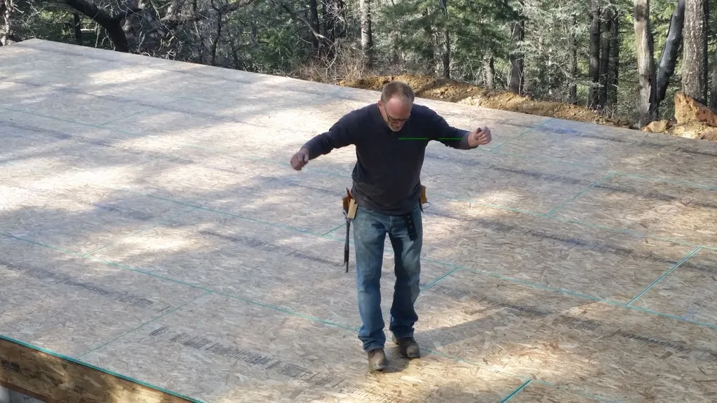

Haven't danced since by wedding almost 30 years ago but I think I can handle this 8). Decking going on tomorrow
Todd
Cougr67
My brother Mike was up for a couple of days to help with the floor and start framing some walls. No problem being the floor Dow and here is my obligatory picture of dancing on the finished deck.
dablack
GREAT JOB!

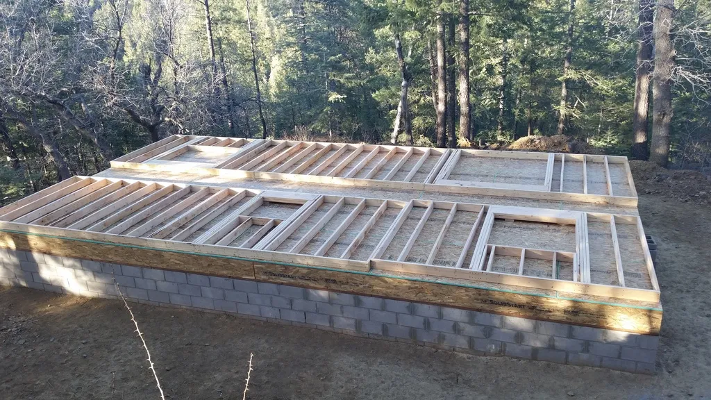

The day after the floor was done we framed up the long Walls. One of these days I will figure out that everything take longer than you think it will. It was a long day and several mistakes to get to this point.
Anybody see the framing mistake in the picture ? I didn't notice it until I was home and looking at the pictures. Sometime you are just to close to see the obvious.
