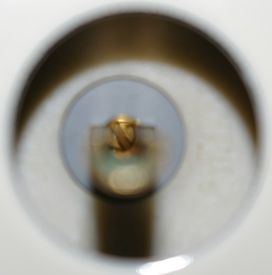

    After converting the range for AnnaMarie's Cottage from natural gas to LPG, ALL the burners ran hot.  THe lowest settings were all too high.
     Turns out there's a simple adjustment.  You just pull the control knobs off and right down the middle of the shaft there's an adjustment screw.
      Here's the article that explained-- http://research.rolfes.org/home/adjusting-the-simmer-flame-on-a-gas-stove/ .  Just like the article said, none of my screwdrivers would fit.  They recommend filing down a screwdriver.  What worked for me was the little 'key' that comes with a keyless interior doorknob---the thing you can stick in the hole if you need to unlock the door.  Some of them have a flattened end and they fit perfect to make this adjustment
