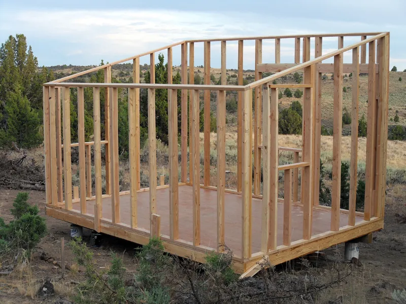

Been awhile since getting on; not a lot to do with all the snow at the lot. I have a question on shed style roof framing. These roofs seem popular, look great, but there's not a lot of info out there. Most of what you find is for... sheds. Not really adequate for a home.
My question is this: How are exterior walls along the two sloped sides normally finished at the top to support rafters? I've seen examples where studs are notched to support outer rafter, others run a horizontal top plate from the low side and put supports from there. My structure will be 32' in length, with a 3.5/12 slope running this distance. Right now, I plan to install a double top plate that matches the roof pitch and tie into the low end and high side top plate. This means all my studs would have 3.5/12 cuts at the top to slide in. Running a horizontal top plate from the low side doesn't really work, as I'm planning two stories at the tall end (tall loft), but maybe I'm thinking about it wrong...
Is that typical? I can post some pictures if that's helpful. You can go to my blog (www.ouridahocabin.wordpress.com) and go to "framing" for some help.

I would angle the top of the upper wall, ripping top plate edges to angle if needed.  I'd block between rafters, if vented use one dimension smaller blocking material. The overhangs could be cut down, plumb at the wall line then parallel with the stick to make the fascia smaller, else a double layer of fascia would cover that width with stock dimensions. I'd probably eliminate the rafter over the wall and run lookouts from the first inboard rafter across and bearing on the wall then out to the fly rafter. Then use the rafter over the wall to make blocking over the wall that fits between lookouts. That makes a much stronger overhang in snow country than flatways lookouts. I'd platform frame the loft area.
busted knuckles
#7
"angle the top of the upper wall"  Rather than have it flat with a birdsmouth cut in the rafter? I just want to be sure I understand what you are saying.
Like this? This is from this forum...

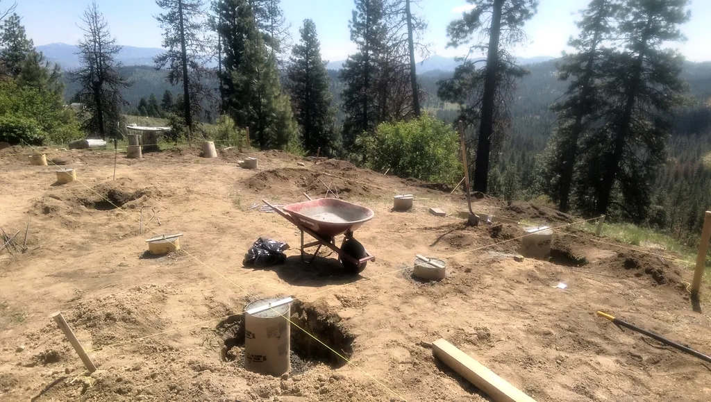

This past weekend I broke ground after finalizing the foundation layout. 19 different piers with a range of Sonotube (10" and 12") and spread form sizes... I "test dug" two of the 30" dia. x 3.5' holes by hand. Soil was great, but still a lot of work. Have a skid steer booked for this upcoming weekend to make short work of it. Here's a shot of the action (don't worry, this was a corner pier, and the stakes and lines are all laid out very well and sqaure - I understand the picture looks like I'm just digging holes  :D)
Hoping to get all the holes dug this weekend, forms set, and most (if not all) of the concrete poured. Would be great to have all of this done before Memorial Day.
So here's my question: All along, I've been planning to use Simpson ABU66Z for my post bases, but dang are they expensive! I'm looking at $25-30 x 19 for a total of ~$570. Seems crazy for post bases. I already purchased my anchor bolts, and I like the idea of the 1 inch standoff and flexibility that the ABU allows. Has anyone had luck with other post bases that use a pre-cast anchor bolt system? What about doing a mix of ABA66Z's and ABU66Z's? I could put the ABU's on the center and corner posts, and the cheaper, less sturdy ABA's on all others? Thoughts?
Here's another shot (bad quality) before I go. Take care, and thanks again.

Lots of progress this weekend. Foundation halfway poured.

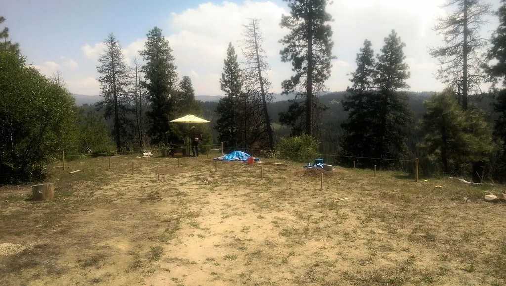

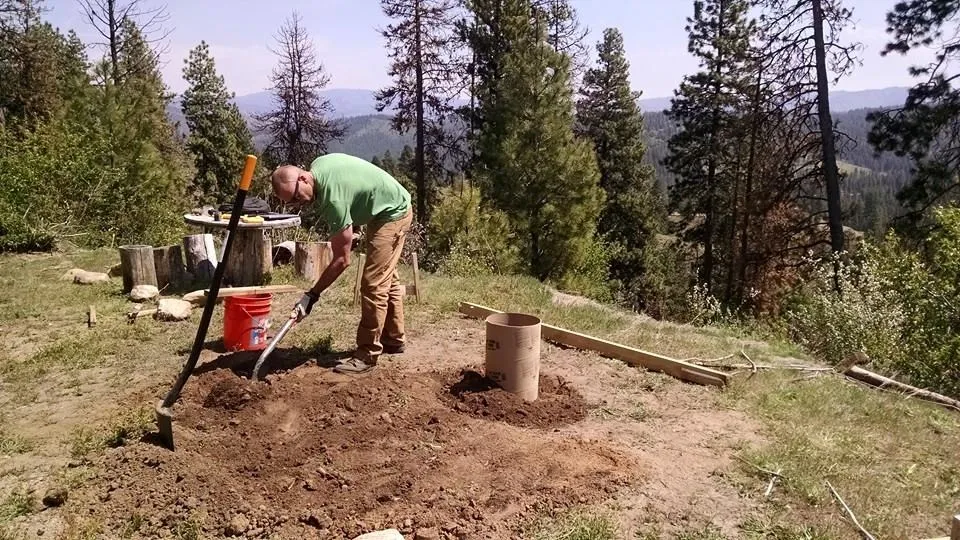

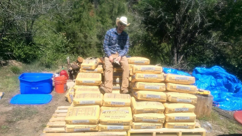

On Friday, I picked up the walk-behind skid loader with a 30" auger bit. Hauling it up to the lot went well and I was able to dig five of the 19 holes before dark. Up bright and early with a friend and dug the remaining holes by 10 o'clock. Perfect timing because that's when Lowe's was planning to deliver three skids of Quikrete. I have no phone, internet or cell service up there, so I had to coordinate closely with Lowe's. Headed down to the "base" and they were about 45 minutes late, but better late than never.
Here's where things went a little south... My hope all along was that Lowe's could get all the way, or at least part way up to the lot with the material. It was about 10,000 lbs. of Quikrete, so the reason was obvious. Their truck shows up, and it's massive. Basically an 18 wheeler with a loader on the back. Delivery guy hops in my truck to scout the road and on the very first turn, he says "no way." So, all the material was dropped about 15 minutes from my actual building site. Me, two friends, three trucks and a small flatbed made two trips, picking up all the bags, basically twice (once to get in the trucks and once to pile up at the site). It was pretty terrible  :-\
We soldiered through and here's a shot of a friend on the Quikrete mountain (sorry, my phone takes some lousy pictures):
After moving all the concrete, I had to drive the auger back into town, pick up the cement mixer and more water. About a three hour turnaround. The Quikrete move put us way behind schedule and only got four piers poured before nightfall.
Sunday was an alone day for me, and by this point I was approaching exhaustion. Lifting those bags up to the stand mixer, in addition to all other digging, etc. was just a lot. I managed to get 5 more piers down, including four of the bigger ones (corner and mid-support). These had 30" diameter spread forms 10" thick, so the base alone took about six bags a piece.
Taken at the end of day three:
I'm planning to go up Wednesday, and again this weekend, to finish foundation work. Overall, things are going well. Just really hard work so it will that much sweeter when the foundation is complete.
That's it for now!

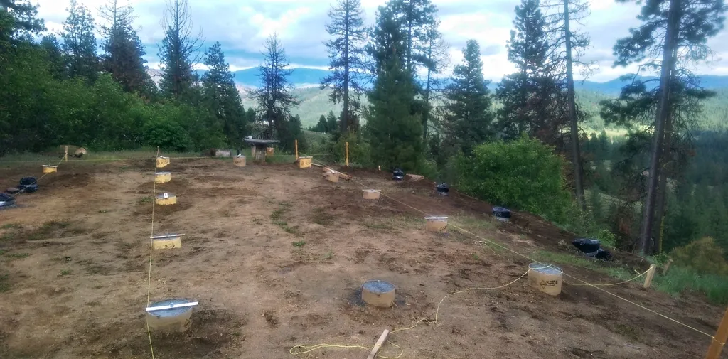

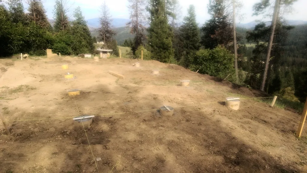

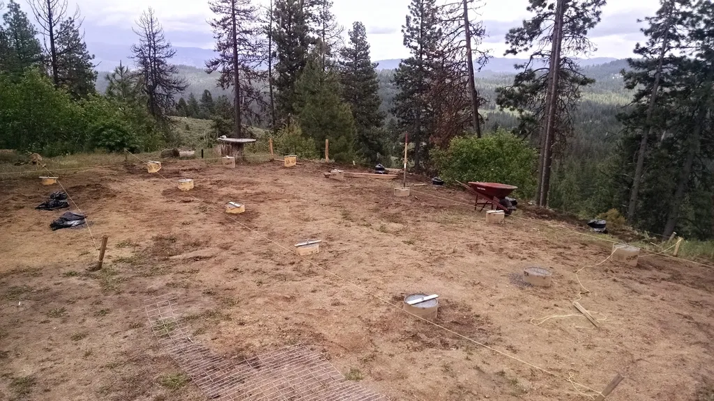

VERY happy to announce that all my concrete is poured. 11,200 pounds of Quikrete later, and I have what is hopefully a very solid foundation. The weather for the weekend was looking really poor (lots of rain) and I am planning to be out of town over Memorial Day. I wanted to wrap up the project before leaving, get the cement mixer home and just have less to worry/think about.
Yesterday, my wife and I drove up with the hope that the rain would hold, and sure enough it did. We were able to pour the remaining six piers, set the anchors and call it good. Here's a recap of the foundation work:
  • 19 separate piers
  • All piers are 40 inches deep
  • Six piers are 12" sonotubes on top of 30" dia. spread footings with cage installed
  • Six piers are 12" sonos on top of 24" dia. Redi-base kits
  • Five piers are 10" sonos on top of 30" dia. spread footings (just a wire sheet in these)
  • Two piers are 10" sonos on top of the 24" Redi-base kits
  • All piers have three sticks of bent rebar in them
Once all the dirt was shoveled back in, things really started to look exciting. In a couple weeks I hope to start cutting timbers and work on the floor system. Here are some photos. More to come.

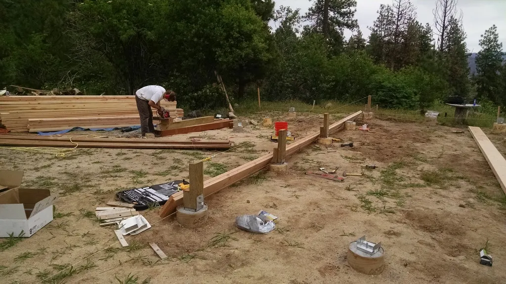

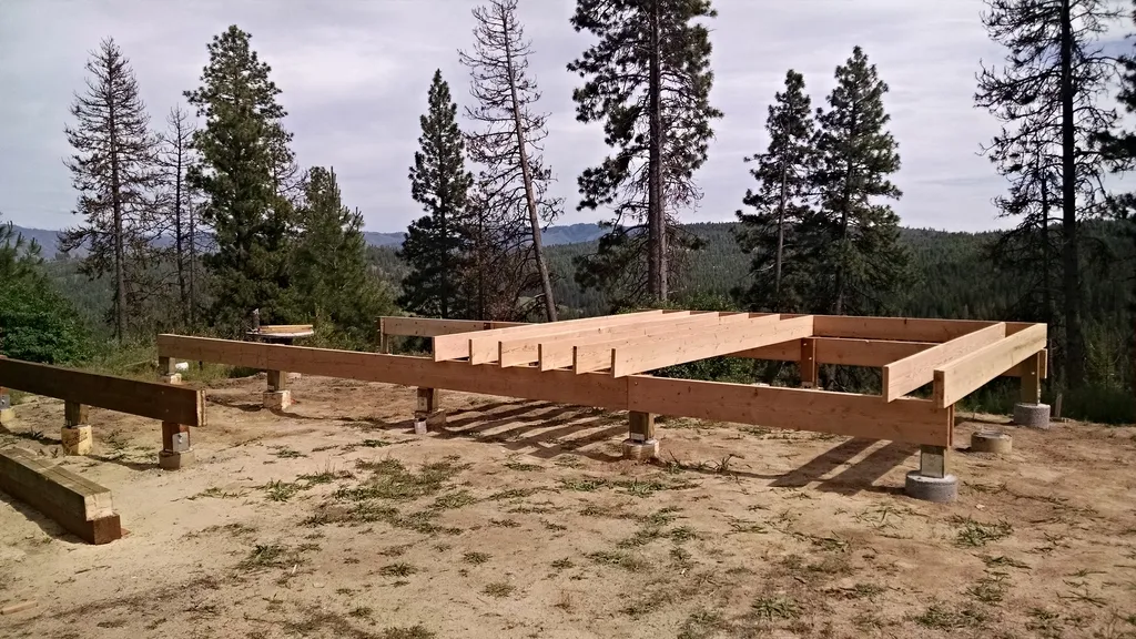

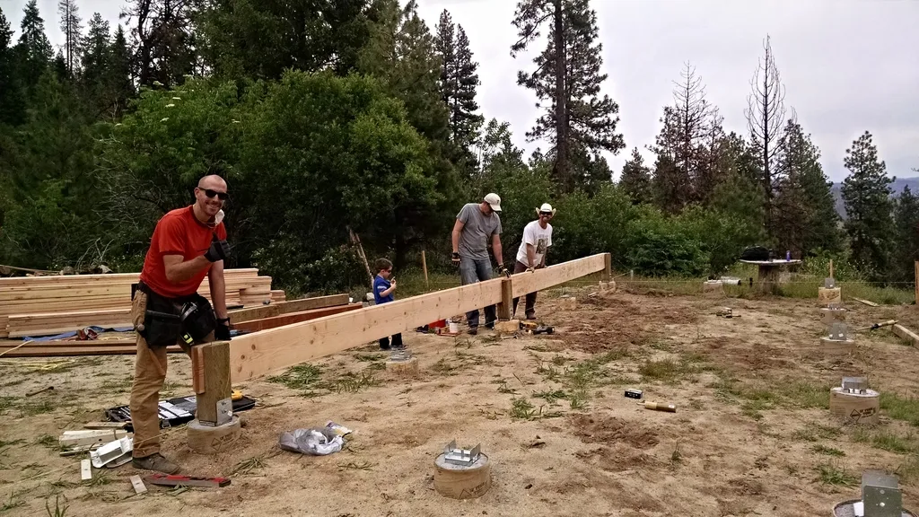

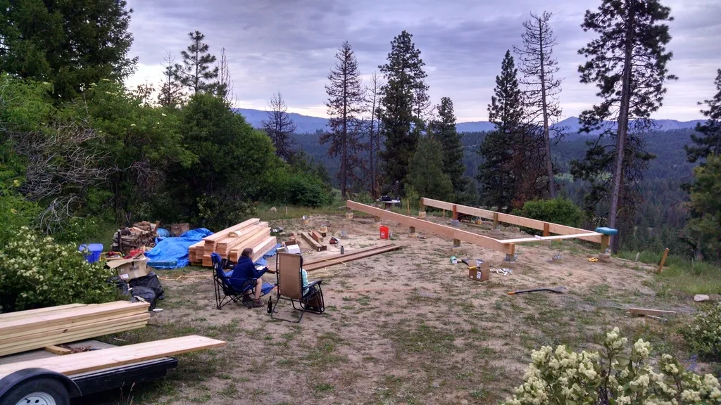

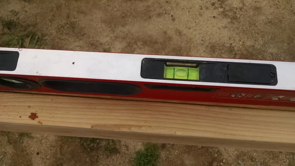

After a couple weeks off, I was able to get another weekend at the land. With all the concrete poured, the goal was to set the posts and beams, and if time allowed, start laying the joists. I'll just post several pictures and you can see how the weekend went.
Checking accuracy of first beam
My friend working on notching the posts
End of first day
More framing on second day
I'm going to attach a support to that post where the splice overran... Not sure how the beams got off there, but it's off by about a half inch.
Gotta love when that happens...
Big takeaway: The water level was amazing. I'm so glad I made that thing. It did an amazing job getting the posts spot on with one another.

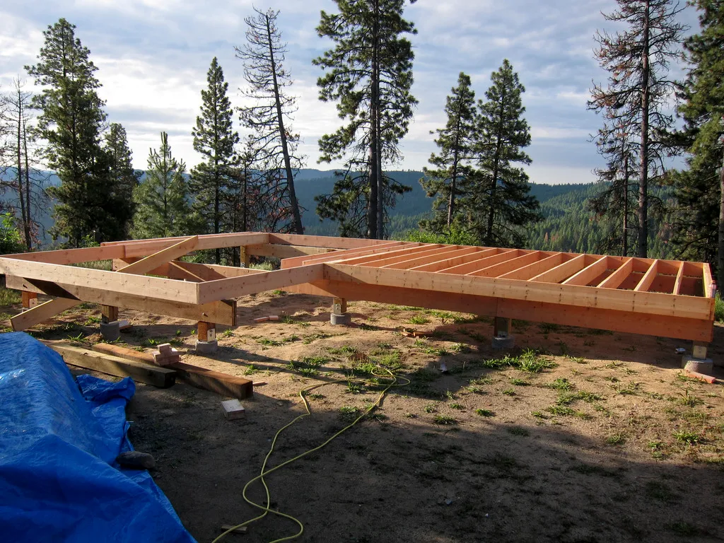

midrover170

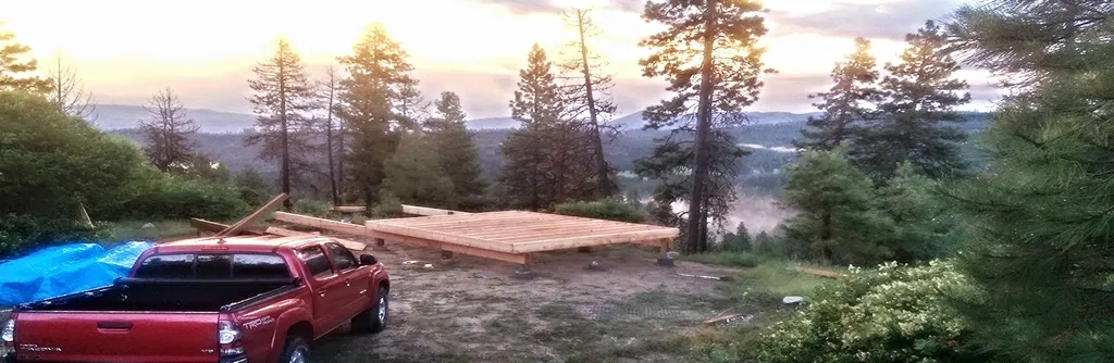

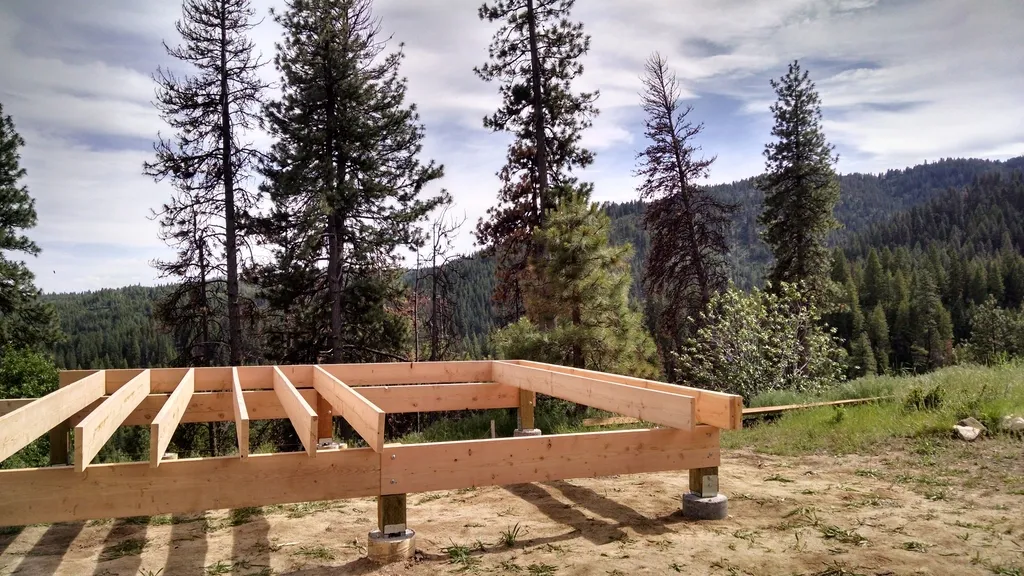

Snapped this last night (back to my less-than-ideal phone camera). After a big storm. Have about half the floor framed in.
Quote from: midrover170 on June 02, 2015, 10:24:06 AM
--------------------------------  snip ---------------------------------------------------------------
Looking good....  LOL though that was a big storm.....  we had just fine graded the yard and it started lighting over your way and a big thunderhead rolled up over us and then over toward Danskin Mountain and we were  trapped in between..... WOW it was roaring - and lighting was shooting over the top of us back and forth your way over to Danskin.....  then here comes an other cloud not very wide and not very dark but talk about getting dumped on.  Please do not send anymore of those our way after we fine grade the yard because looks like we will be doing the fine grading again when this mess dries out......

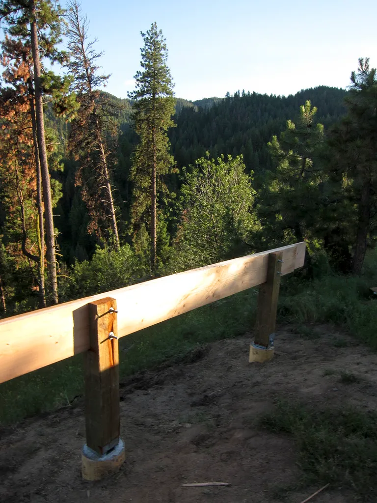

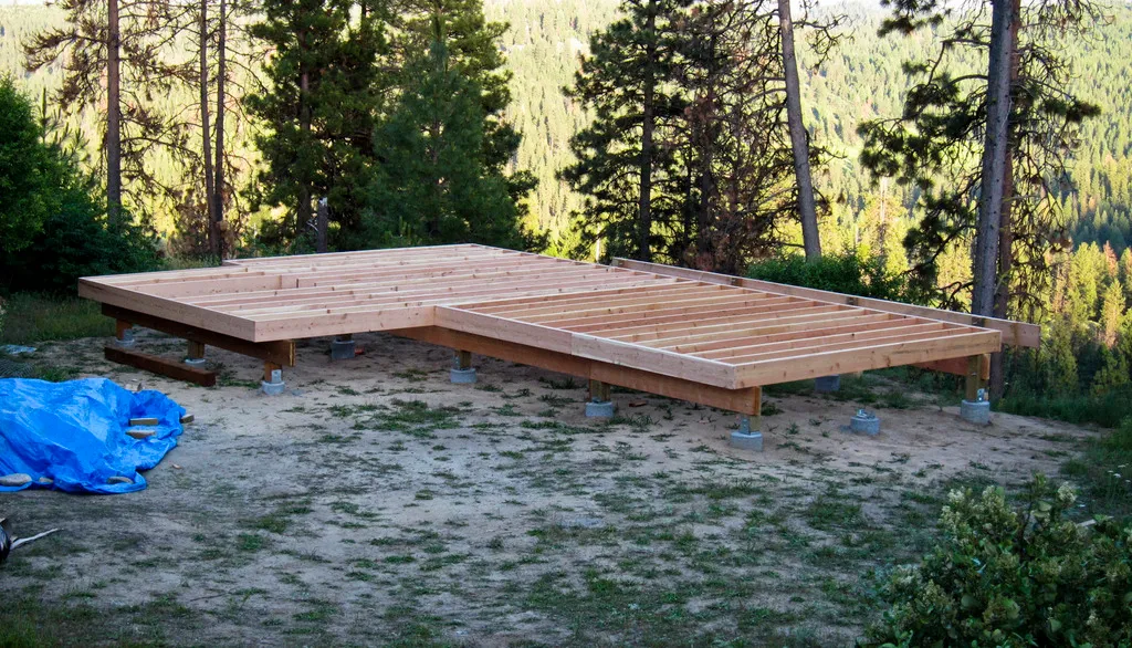

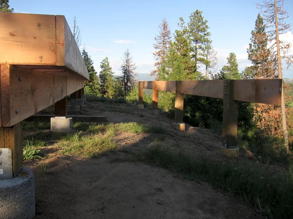

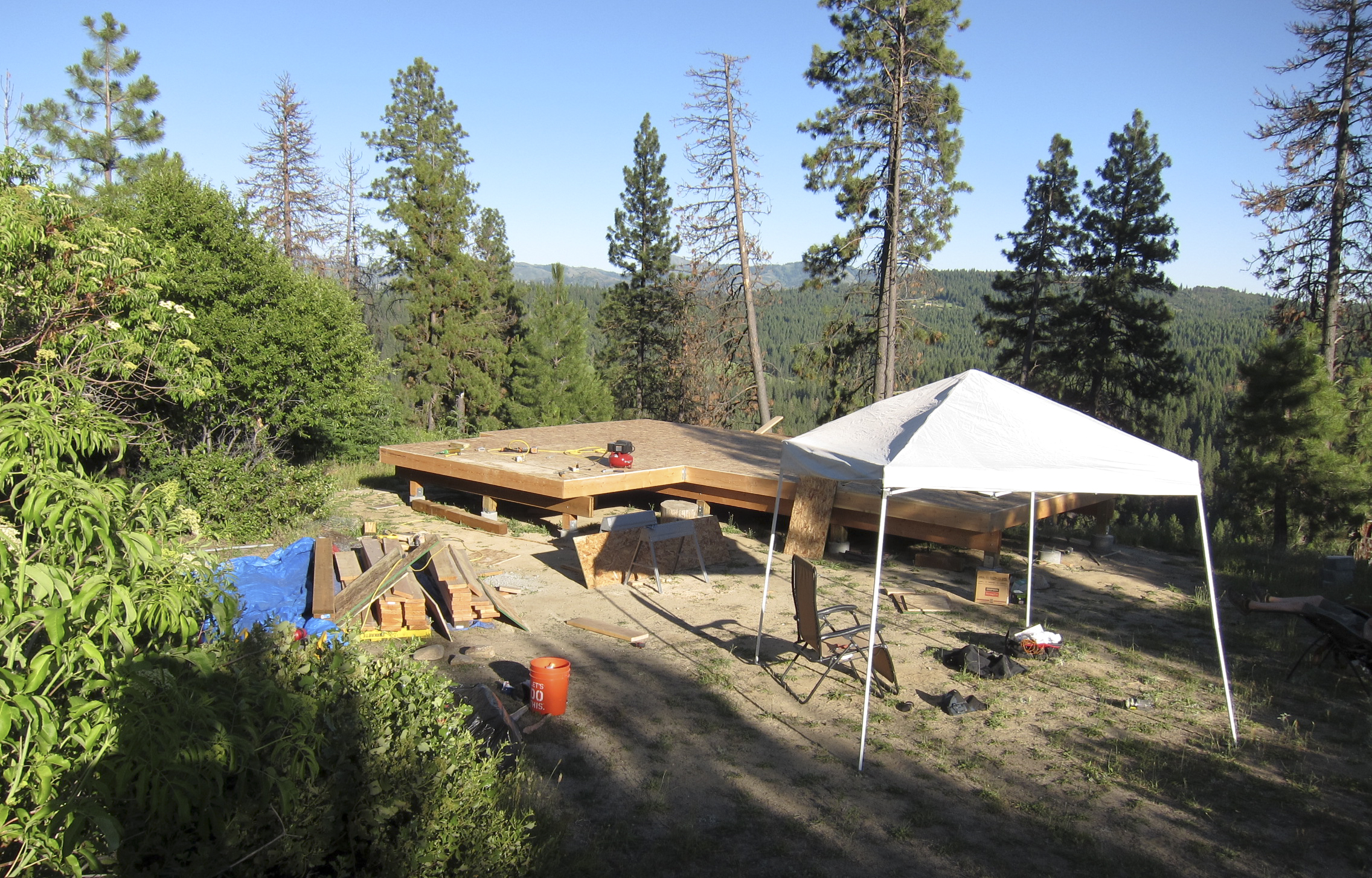

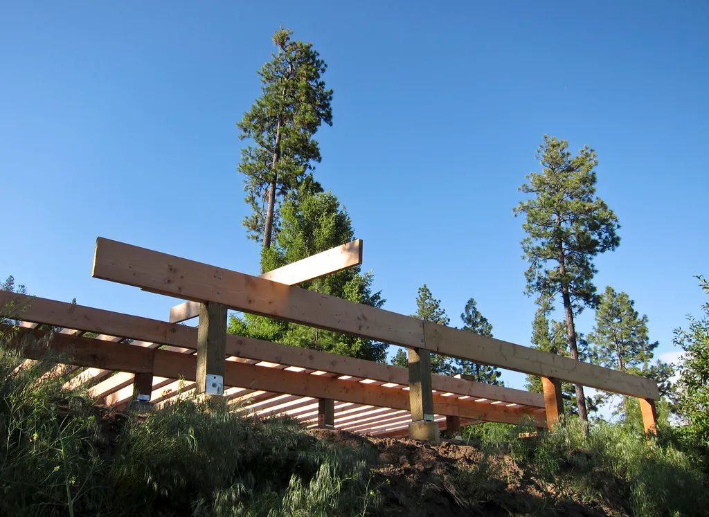

Just a day and a half at the land this weekend - ran out of material and steam.
Minus the posts and beams, I've done all this floor framing by myself. It's a great learning experience, but sure makes it hard going (especially nailing up those 16' 2"x10" rim joists...). Came home tonight with all the joists installed for the main cabin structure. I was really excited to also get the posts cut and notched for the deck. Next weekend I'm hoping to either start on the subfloor or frame out the deck, or both. More to come, but in the meantime, some more photos below.
Support system for the deck on the right. Will clean up the beam once the framing is finished.
Looking up from the hill
Taken as I drove off for the evening. The deck beam kind of makes an optical illusion.

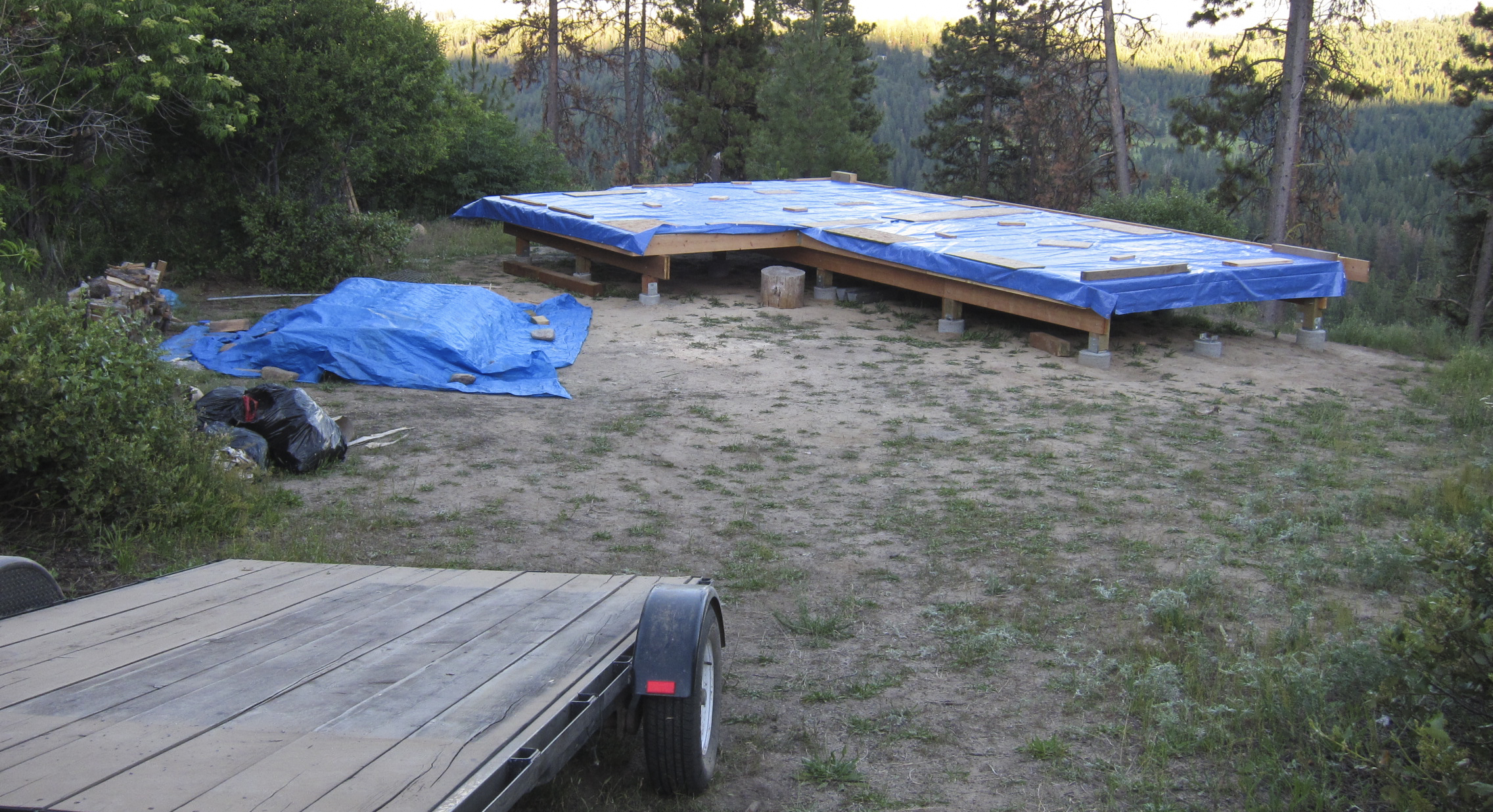

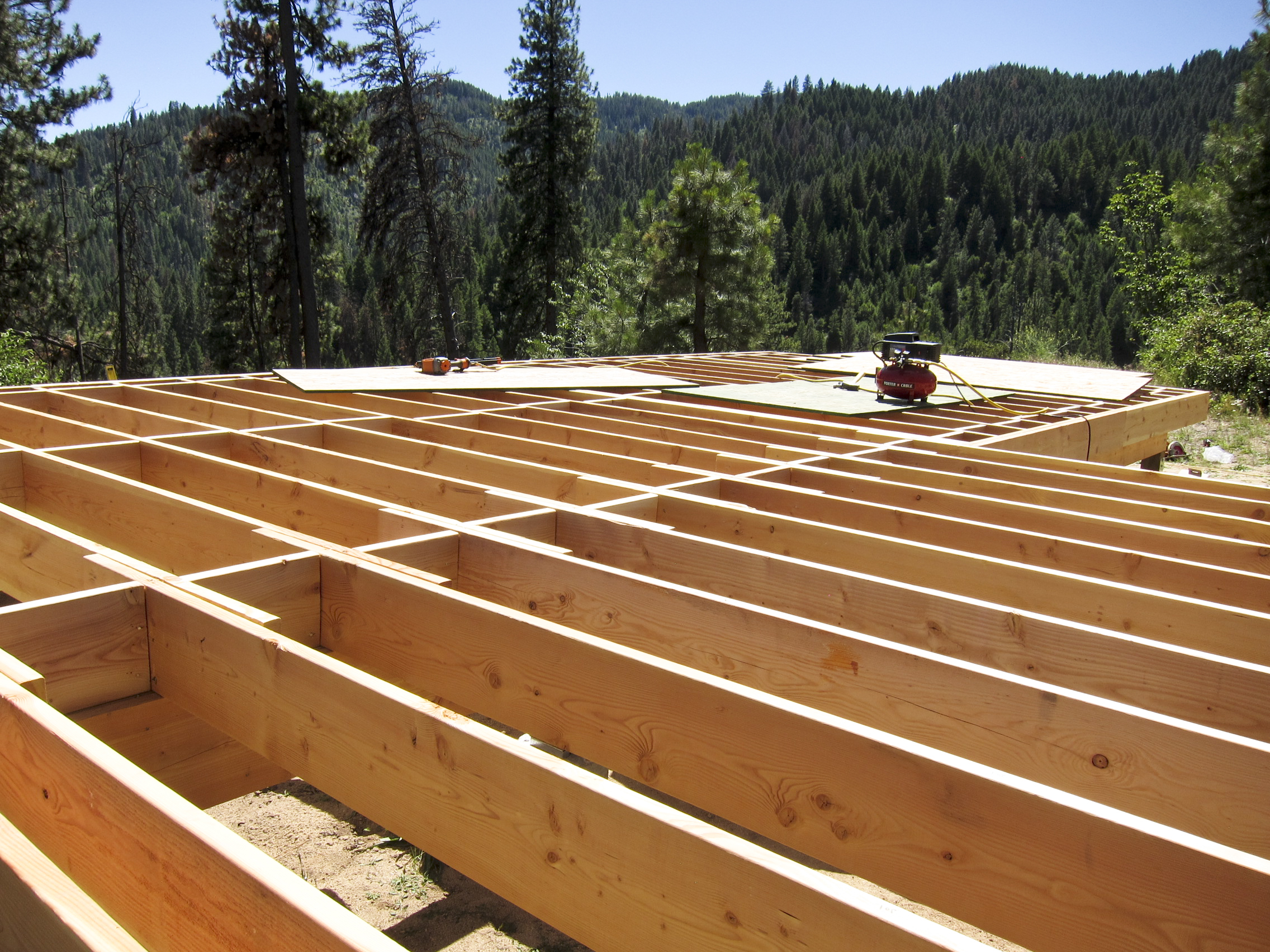

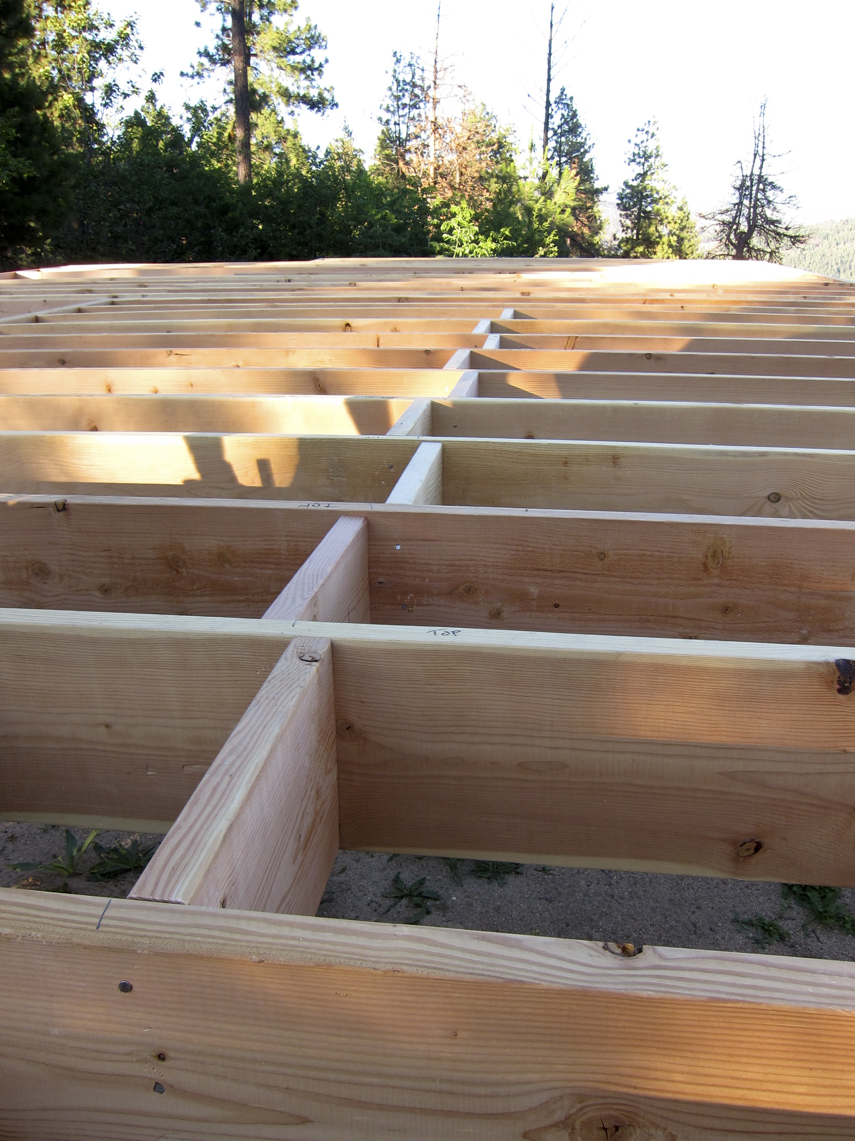

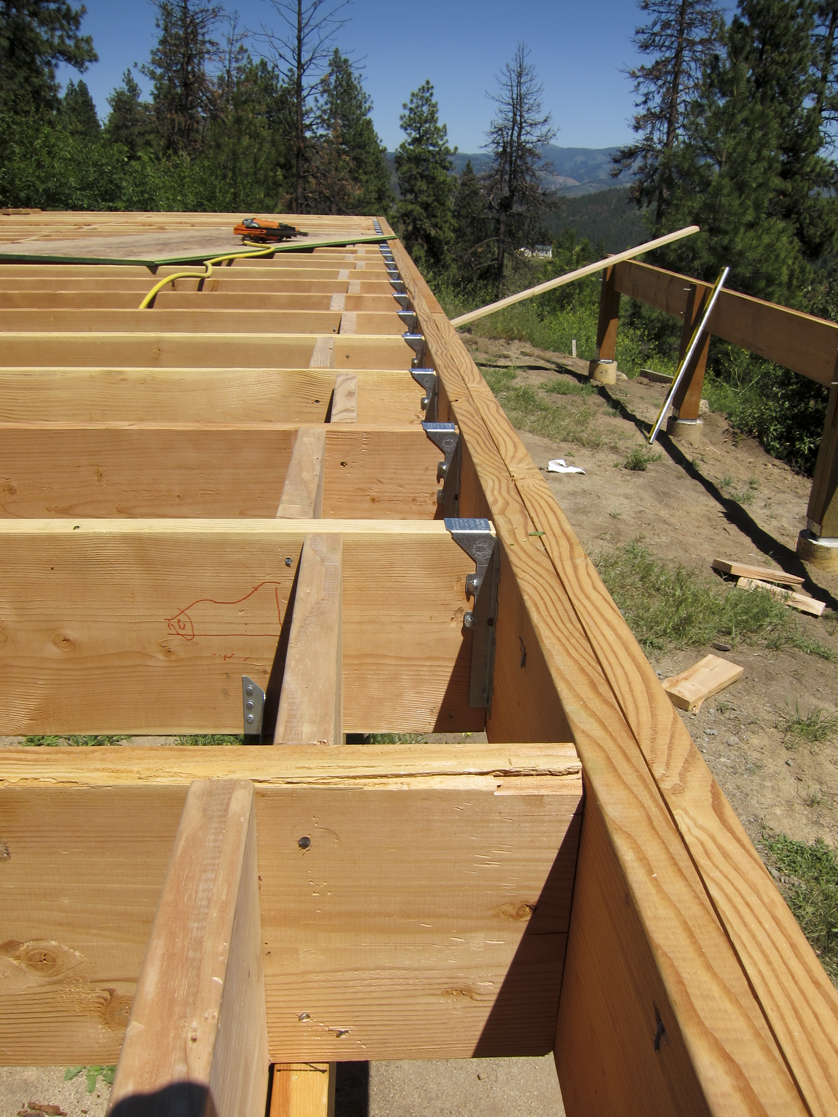

Installed the subfloor this weekend - ready for walls!
About 80% of my time was spent installing all the ties/straps/hangers and blocking before the subfloor went on. I had four different rows of blocking (three above beams and one mid joist span). Also installed H1/H2 straps throughout and upside down joist hangers along the edge that will have the deck ledger board attached. It was a long process, but I know very important and well worth it.
I was able to get all the subfloor cut and installed with 20 sheets (my lower level footprint is about 550sf.). It was great to see everything going in so square and straight. Made me feel good about all the work that had gone into the foundation and floor system. I'd like to frame the deck in over the coming week, and the framing crew may be coming up sooner than I expected to frame in the shell. Lots of progress. More of a writeup on the blog.
dmanley
The only question I have is why the up side down joist hangers? They are carrying no load, which is their purpose.
