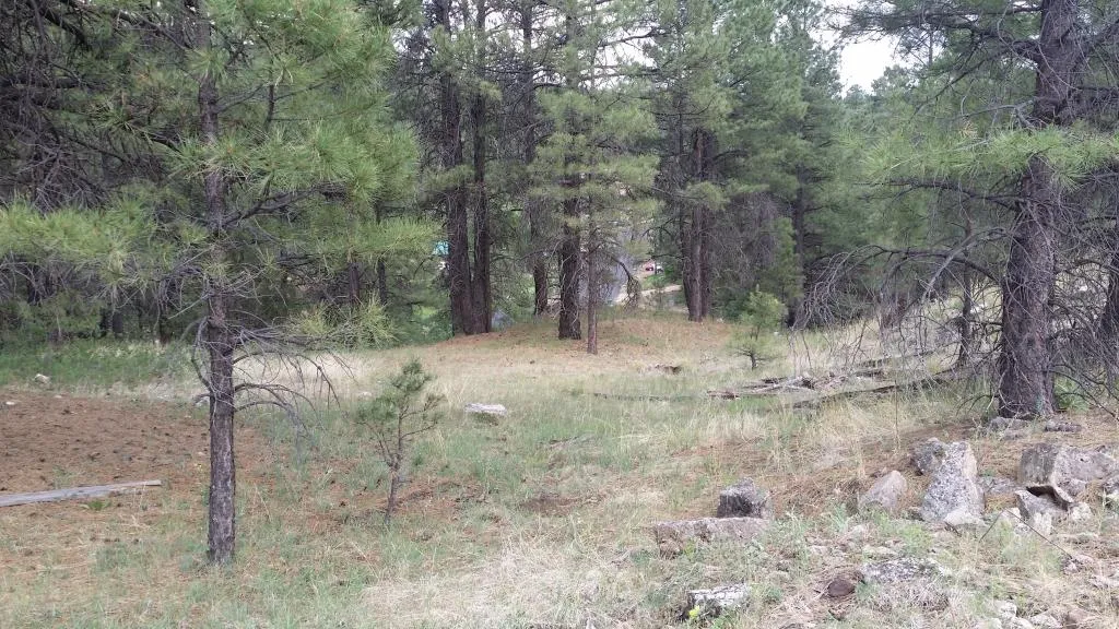

My wife and I decided that we wanted to build our own primary residence in our goal to become completely debt free.  After plenty of searching we decided on the 20 x 30 1.5 story plan.  We purchased property just outside the city limits that has all utilities available which will help the build in terms of simplicity.  Our goal is to be completed by the 1st of April 2015.  The county has so far been very pleasant to deal with in terms of permits as well as offering advice.  A few modifications to the plans had to be made to comply with local codes and snow loads here.  I will update as we go along.  Enjoy
[/URL][/img]

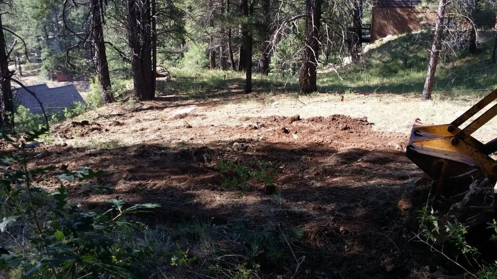

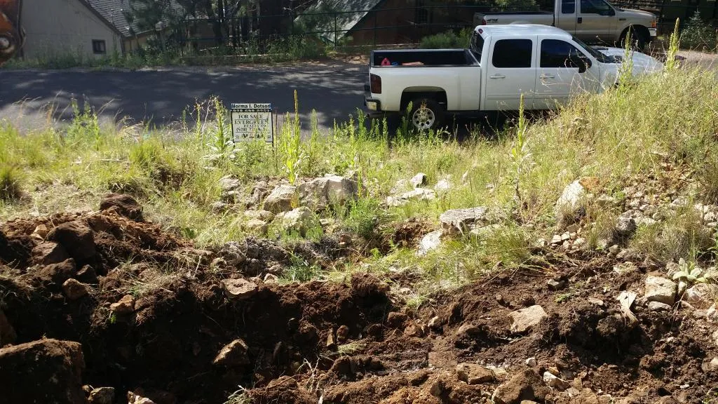

The new property ready to start digging

There is a lot of rock to dig through just to cut my driveway in, so we will see how this first week goes

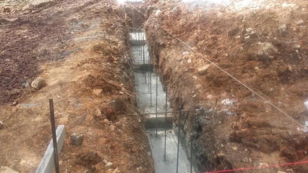

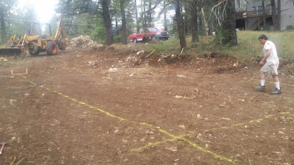

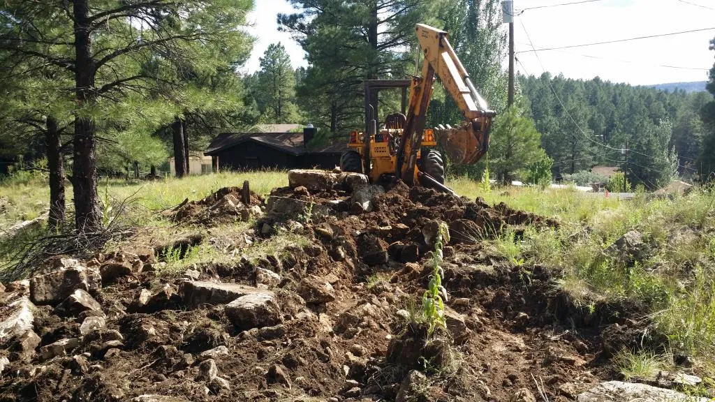

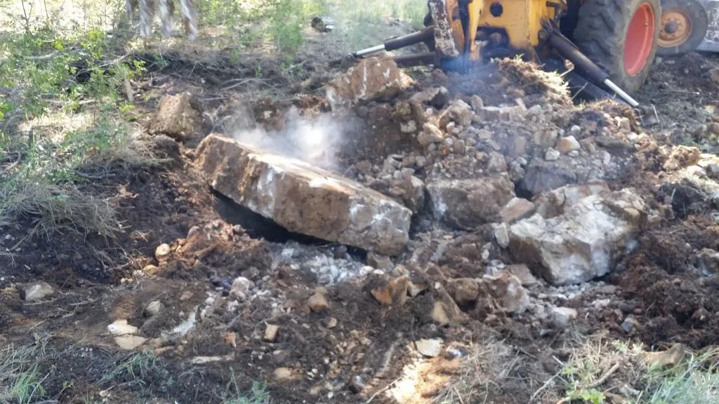

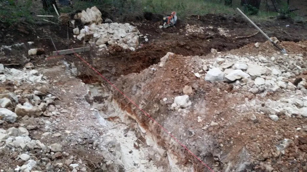

So its been a productive week.  Between working normal days at my job I found myself working on the property before work , after work and 13 hours a day Saturday and Sunday.  I was able to get to lot grading done, the house laid out and the footings dug ready to be inspected on Wednesday.  We encountered rocks, solid rock ledges on the last 20ft section of the footer.  That involved a lot of jackhammer work and hand digging out the crumbs.

This is where we ran into the rock ledge

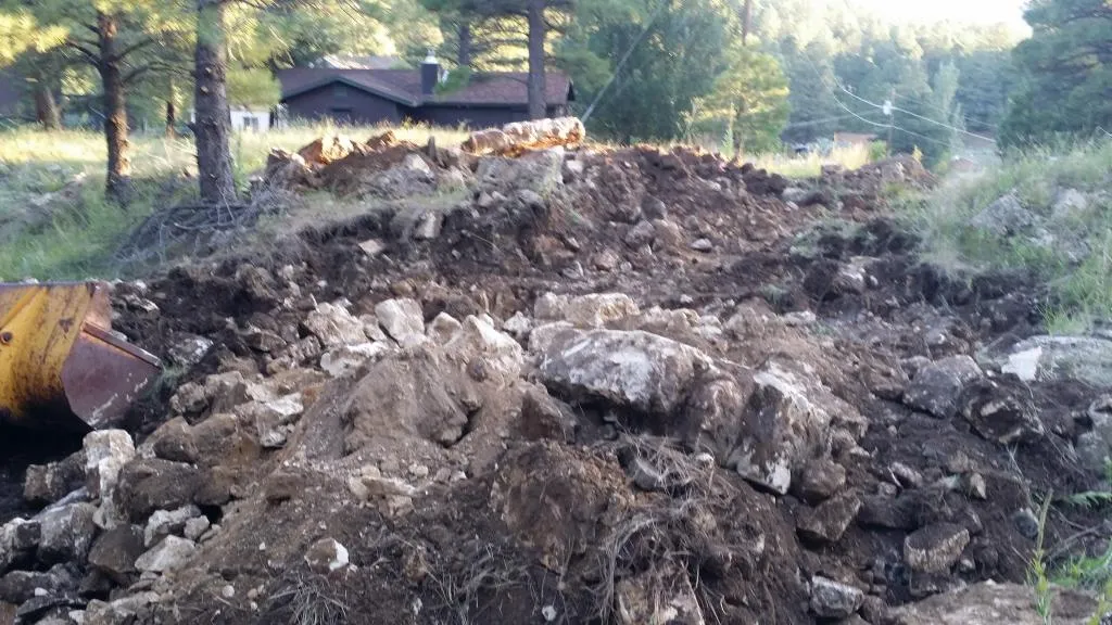

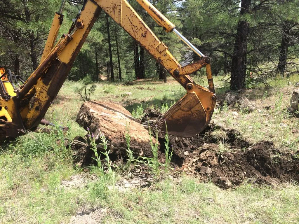

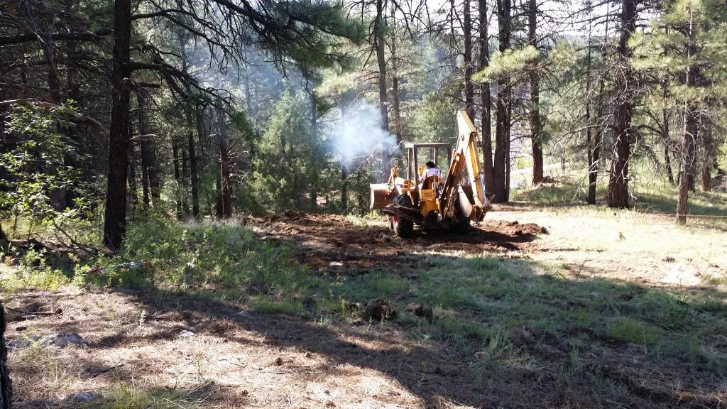

This is where I have to cut my driveway in.  Needless to say it was nothing but rock.  Two broken hydraulic lines and a lot of hours on the backhoe and I am getting through it.

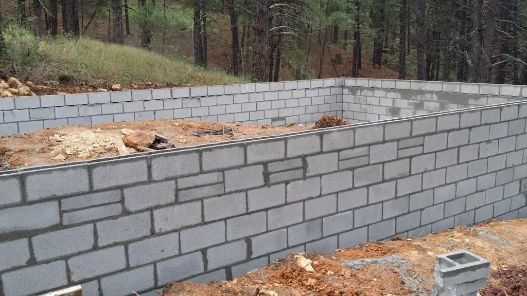

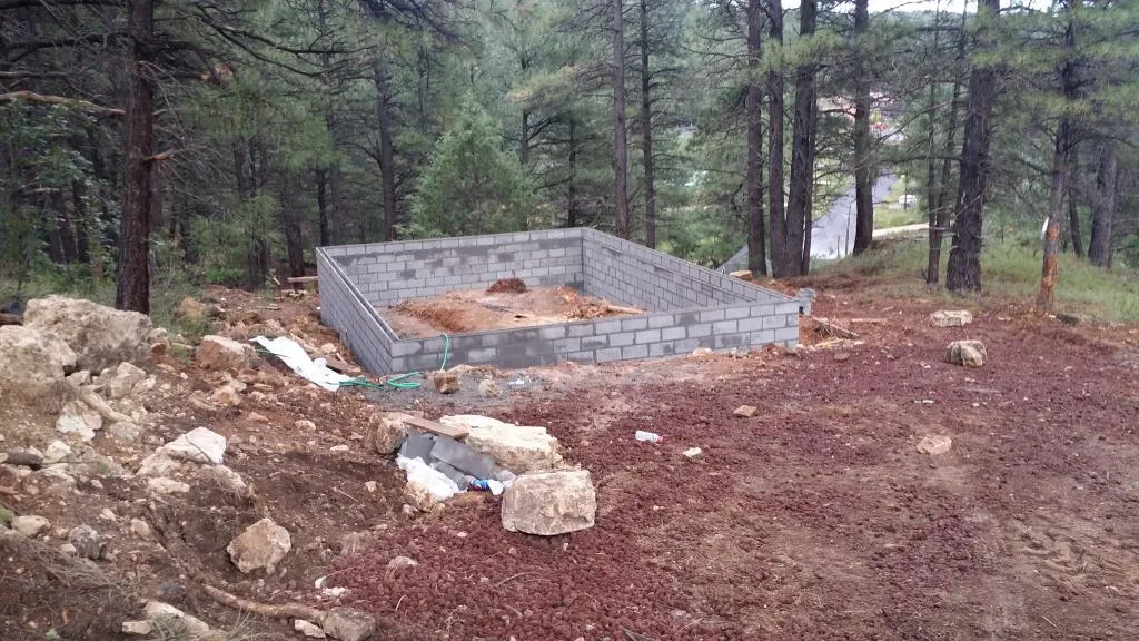

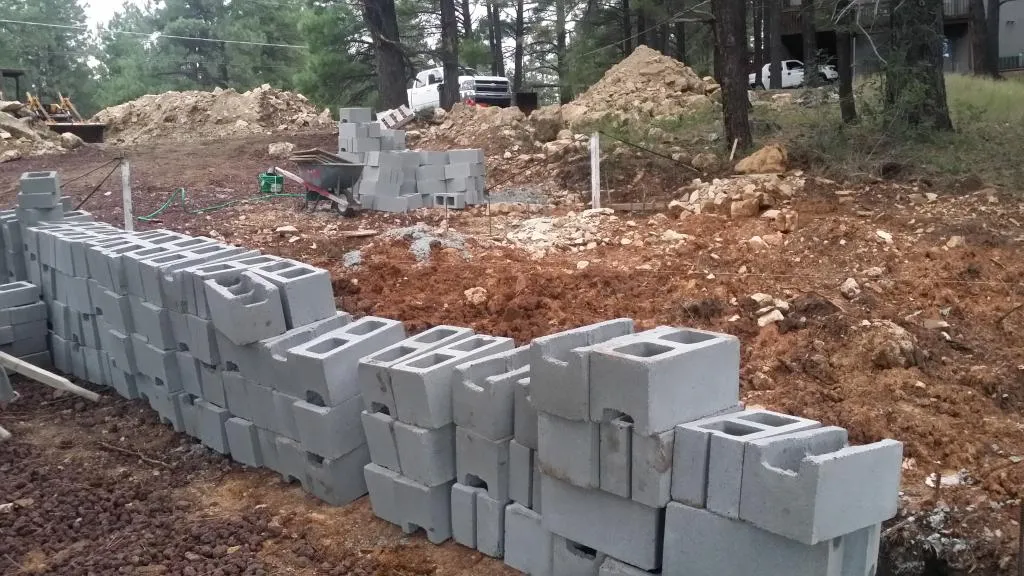

We have accomplished a lot this past week.  The footings are in and the stem wall is up.  My original estimates called for 4 yards of concrete.  That was not accurate once we were ready to pour.  It ended up being around 7.5 yards averaging 20 inches wide and 12-14 inches deep.  The block work came in around 580 blocks since I am building on a hillside.
