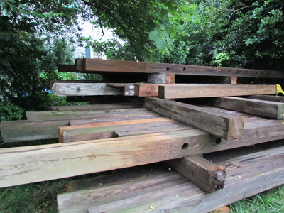

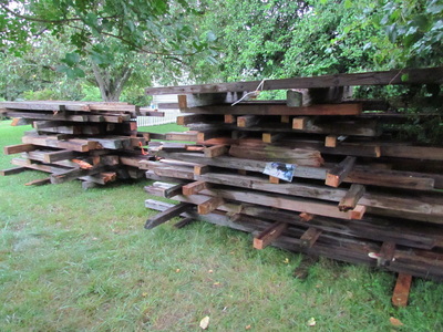

I got 2 26' Uhauls worth of 6x6, 5x5, and 4x4 posts (pictures attached)  Total $675
And 2 20' Uhauls packed with rough cut 150+ 2X6x16 and 250+ 1x6x16  Total $1300

We plan on doing a post and beam foundation 6x6 post 24"in the ground 24"-36" above grade with a 6x6 post as a beam.
The building inspector did not have a span chart for PT Southern Pine #2 6x6.
I have looked all over the web.  Any answers with legit documentation is much appreciated.

#2, yes that is a potential problem, the inspector should be asking for engineering on the pier foundation.
#1, a 6x6 post was probably not graded as a beam it is a vertical post for column loads. I do have design values for them but am leery of that use. Contact SPIB with all the information from the grade stamp and they should be able to provide clarification and documentation. Recycled, I'd say no go on using them as beams, use them as vertical members if at all possible.
