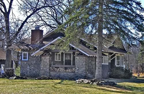

If your main concern is to just provide a bit of shelter over the door, the simplest solution is to sister on some porch rafters to the roof rafters to extend them out and over the door with a new fascia board on the front.  A small beam under the end of them and either posts or just  a diagonal brace would support it all.
This picture shows a similar arrangement on the side of the house, probably sheltering a side door:

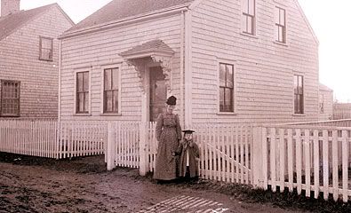

And heres a couple of victorian bracket hoods.
It wouldnt be hard to do the curved roof one with ribbed aluminum roofing over shaped rafters:
