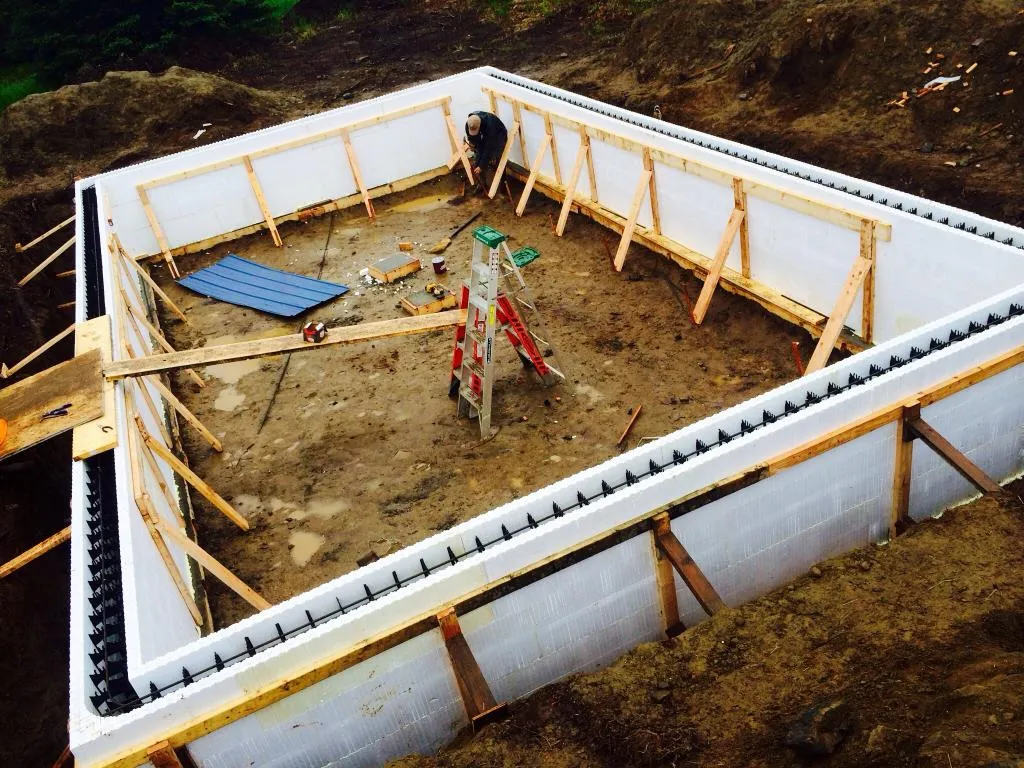

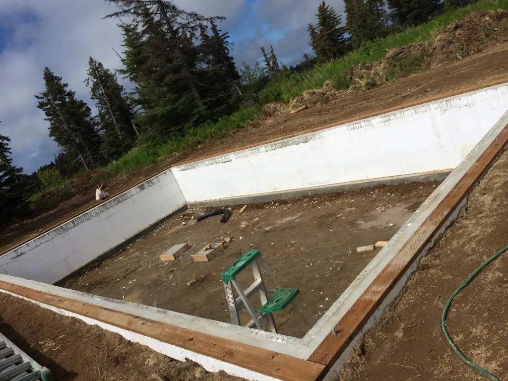

Update!  We have made progress!  Yesterday we had concrete poured for our footer!  We settled upon using Amvic ICF blocks to form a 48" crawl space foundation.  We felt that they are the most user friendly and since they're so lightweight, easy for me to help position.  Can anyone help answer a question though?  What would be the best inexpensive solution for bracing the ICF's?  I know that for full basement walls people use extensive metal bracing systems, but for only 4' I'm wondering if we really need that.

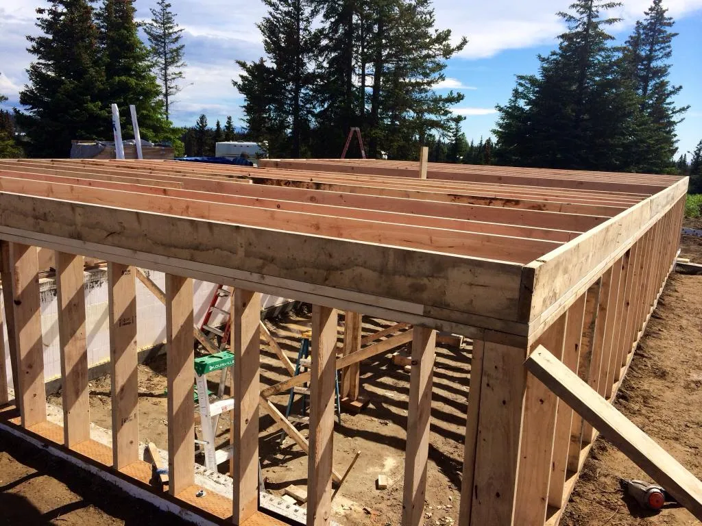

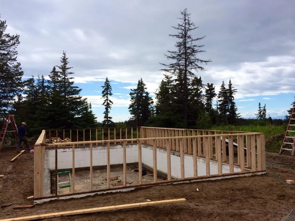

Here are some pics of our progress!  After our concrete pour we decided at the last minute that we would add 4 feet of studs for a future basement.  So far we've completed basement framing and first floor joists.  Tomorrow we'll be sheeting and then ready to frame 1st floor walls.  This is coming along nicely!  We have made a few adjustments to the floor plan.  First, we decided to have the utility room/washer & dryer down in the basement which will open up space for a breakfast nook adjacent to the kitchen.  We are also removing an upstairs bathroom, widening the master bedroom.

Lol yes, that's a pretty accurate description of him.  We got more done today!  Sheeted the basement walls, started 1st floor flooring, and stairs.  Tomorrow we'll finish the flooring and hopefully get started on some walls!
