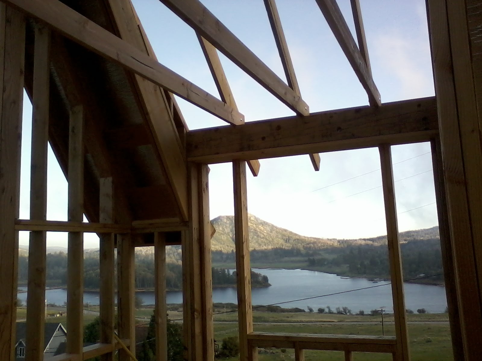

The cottage's bedroom had some ceiling joists (no trusses) that were off by as much as 3/4".   I just bridged it all with a 2x12 on top with pre-drilled oversized holes and screwed it in to the tops of each, mid span.  It pulled the low ones up and pushed the high ones down.   Bonus is it provided a nice way to traverse the attic without touching the insulation
   best picture I have of the joists, before the 'catwalk' (this note added after Don identified it as a catwalk)
We call that a catwalk, usually there is a 2x4 or 2x6 nailed to the side of it upright to make it stiffer, they are an excellent idea.
