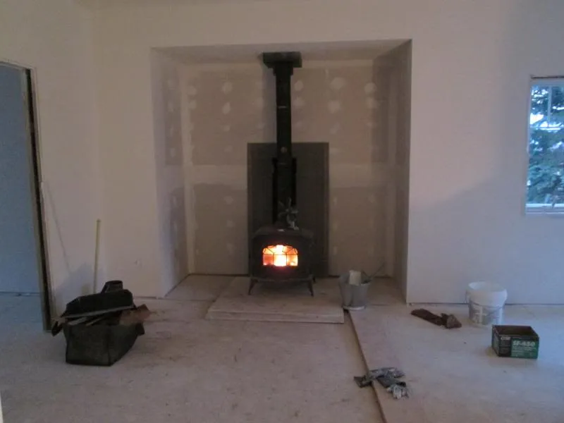

firefox
Excuse my ignorance, but what is the grey material that the stove sits on?

new land owner
The stove is sitting on Cement backer board.  I intend to tile the base at some point.  Tile backer board gives me a fire proof surface and it is needed for tile anyway.  Here is an updated picture with the stove pipe installed. I have found that it takes about two hours to get the stove to throw off a decent amount of heat.  Once it is going it heats my camp fine but you need patience, something that I lack.
firefox
Thanks for the explanation. It really looks nice what you have done.

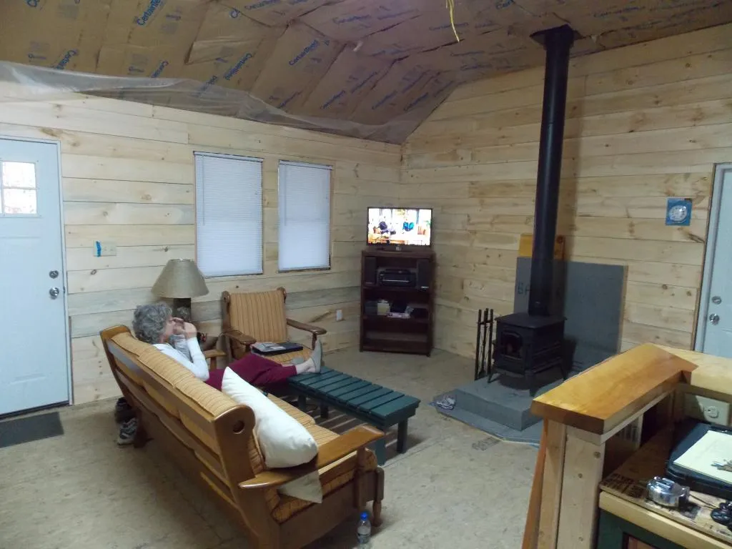

our stove is about 2' X 2' X 2' in size but it has heated our whole house (upstairs and downstairs) when the out side temp was in the 20's
Vermont Castings 'Reliant Acclaim'

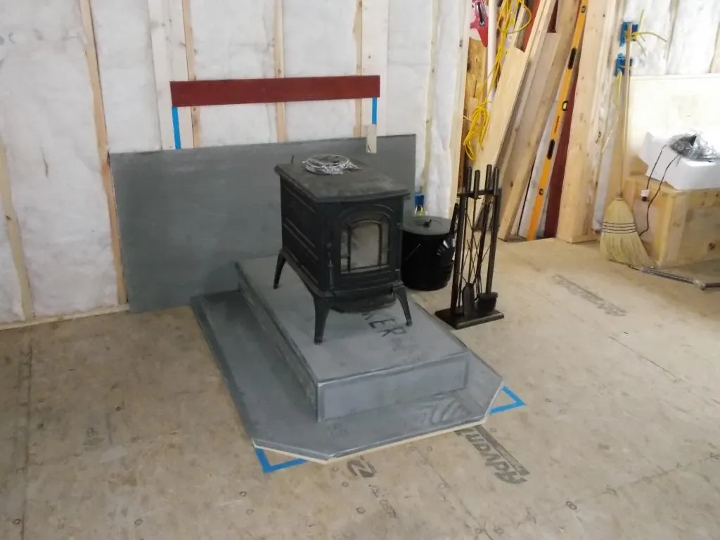

I bought my stove on craigs list for $35. heats my 20'x40' house in the Ozarks just fine. I installed the stove in 2005. still going strong.
I simply made a 2x6 base topped with cement board and covered that with tile. Behind the stove, more cement board and more tile.
No matter what stove you chose, Be sure to not skimp on the chimney. That's where the real danger is. I chose a concrete block chimney with a clay flue.
