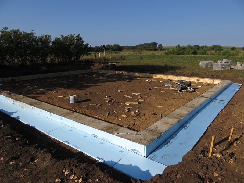

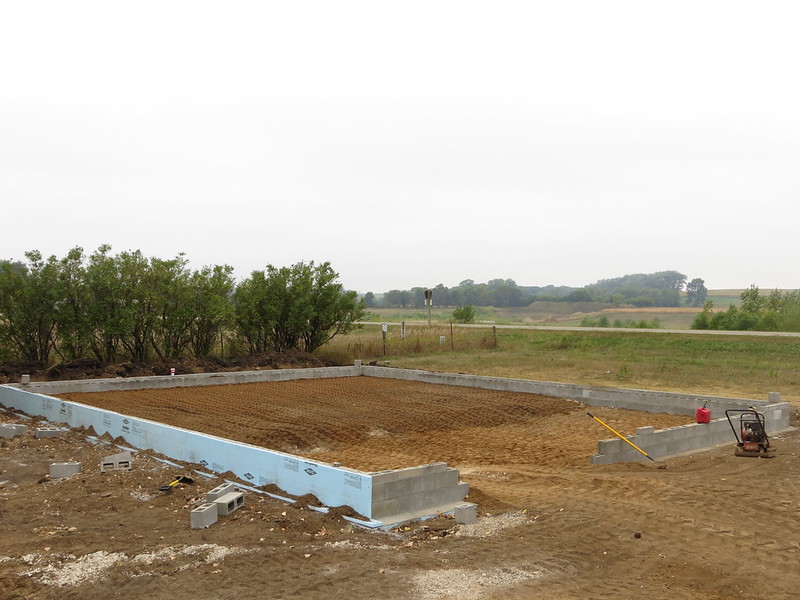

Doing a shallow frost protected foundation. Excavated it with my dad's tractor. What a handy tool to have around!
IMG_0305 by Alan  Gage, on Flickr
IMG_0308 by Alan  Gage, on Flickr
Took a lot more fill than I expected, about 300 tons.

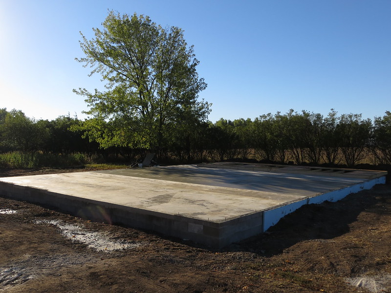

It took about 1 1/2 weeks from the time I was ready for concrete to the final pour being done. Felt so good to finally have that finished.
IMG_0326 by Alan  Gage, on Flickr
Didn't get a picture but there's 4" of foam under the slab.

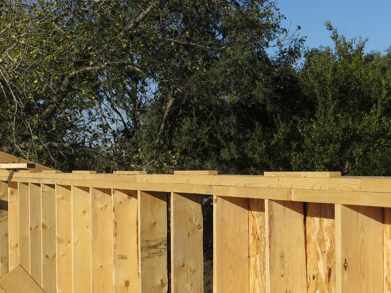

Spent the week getting ready to set trusses this weekend. We tipped one up in the middle of the week just to make sure it was going to be doable for 4 people to handle. Went up pretty well. PUt these 1x2 spacers on the top plate to use as stops for the trusses. I also built a whole bunch of spacers/braces for the trusses during the week. Cut a 2x4 to 22 1/2" long and stapled a 26" 1x4 on top of that. So when we tipped up a truss all we had to do was put the 2x4 in between the trusses and nail through the 1x4 for proper spacing. They worked out great.

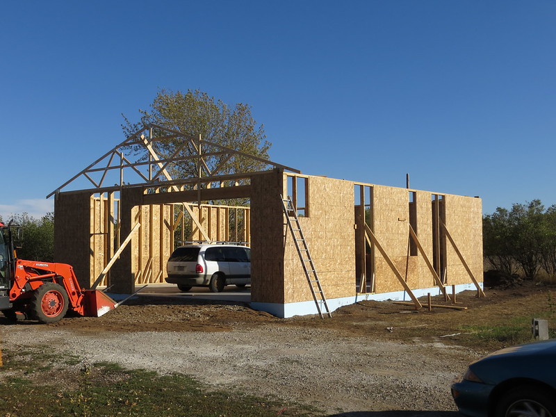

My dad and a couple other guys showed up this afternoon and after a few we had a good system down for setting the trusses. We worked hard and got them done in time for supper. Feels great!
IMG_0333 by Alan  Gage, on Flickr

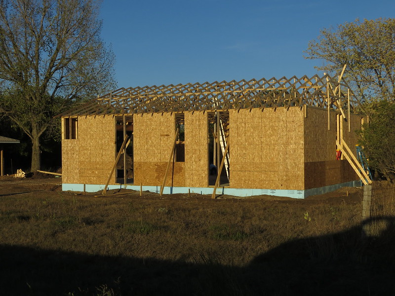

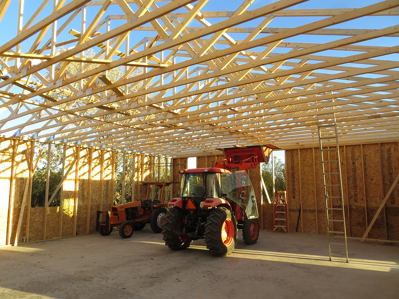

We built a platform on the loader bucket to support the center of the truss. We carried them in upside down, got the tails up on the walls, and then helped steady them with forked sticks as we tipped them to horizontal with the loader platform. This kept it well supported while we pushed it up fully vertical with the forked sticks. The other tractor has a platform built onto the back that came in very handy. The first truss tail was easy to get on the wall. For the second one we'd put the big strong guy up in the cage, hand the truss up to him and he'd place the other tale on the top plate. 12' sidewalls made this all a little interesting but no one got hurt and no trusses were broken. A good day!
IMG_0336 by Alan  Gage, on Flickr
I know from the pics it doesn't look like there's much bracing but there's quite a bit hidden up there in the webbing. It's pretty solid and sheathing begins tomorrow.
