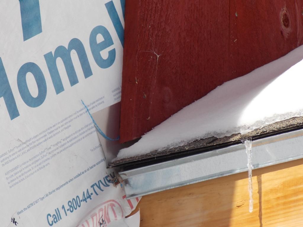

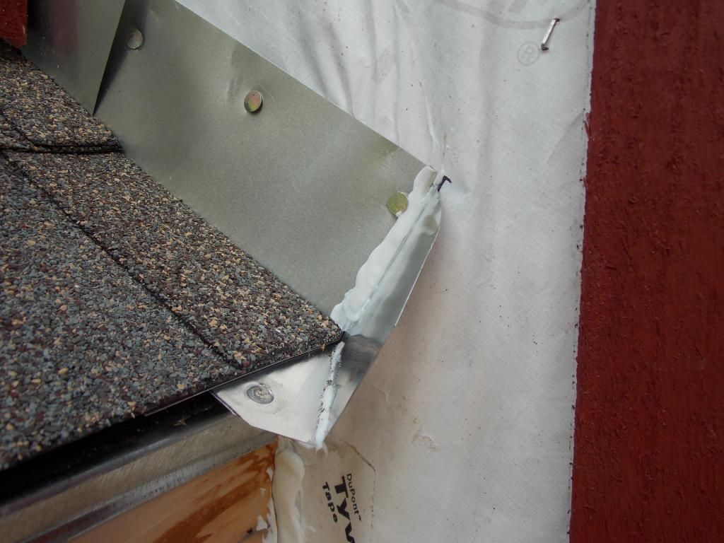

I just spent a week at camp working on more siding.  I solved my flashing issue by making my own "kick out flashing"

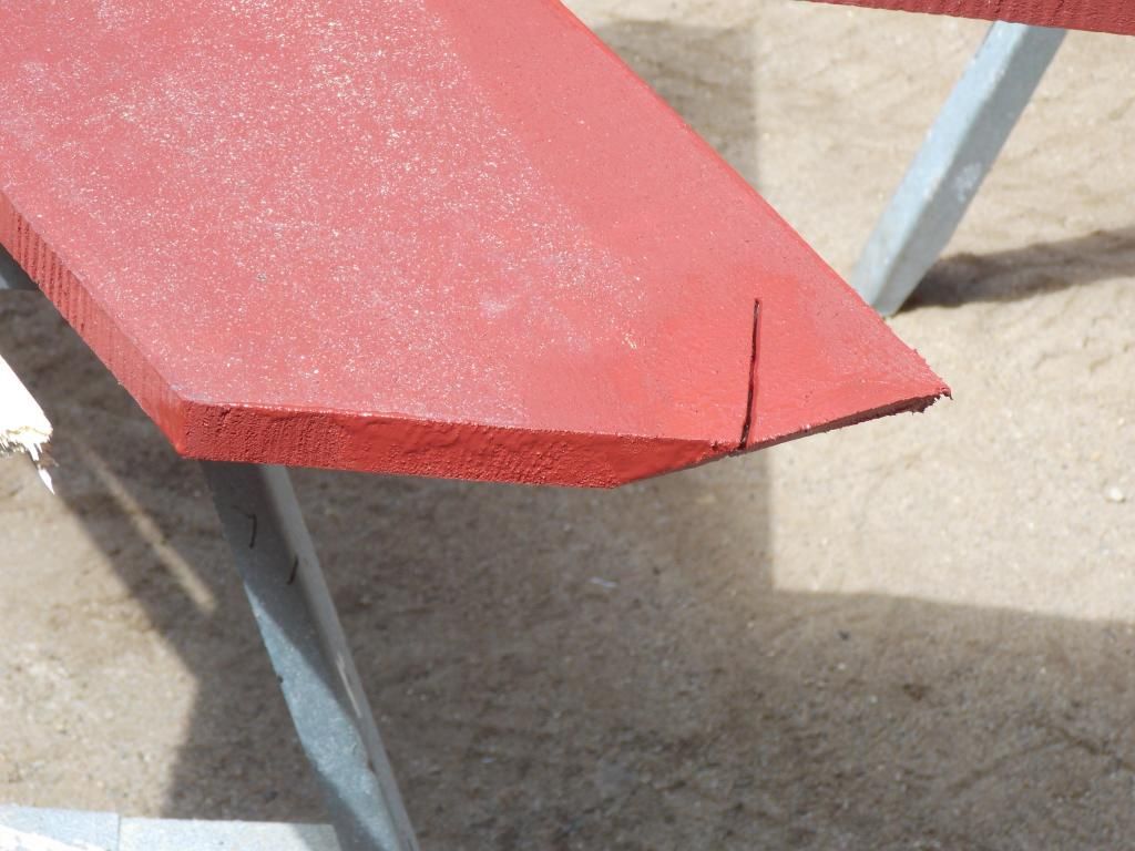

I then put a cut in my siding

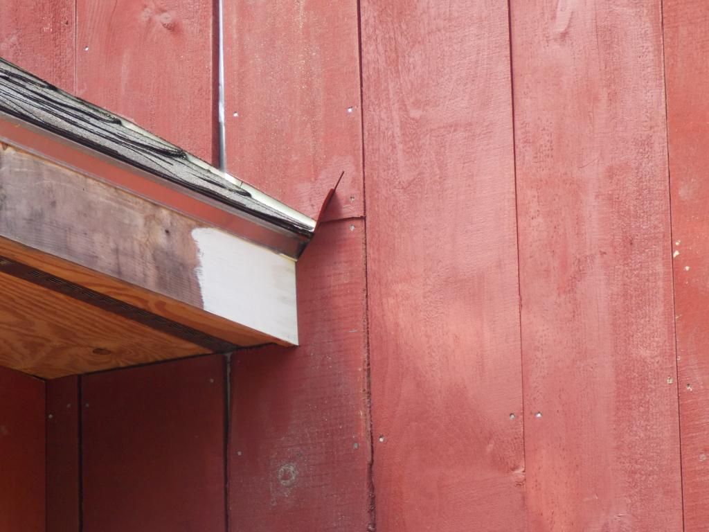

And this is how it looks complete.
We did have a small amount of rain while I was there and it seemed to work well.
Hope I am not nitpicking but better fill in the saw kerf with calk,  and fill in where the siding did not marry up real well.  That said WOW you did a great job on the flashing
new land owner
I have bought more caulk to do just what you said.  Thanks for the feedback.
