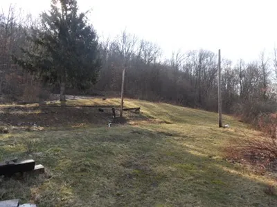

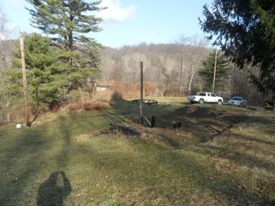

The first picture is a top view of the old foundation.
The last picture is looking up to the foundation site.

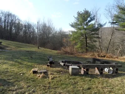

The second picture is looking to the top of the property.  It
does go into the woods about 50 feet.  Where you see the
pine tree in clear view begins a level area over the hill.  Nice
place for another cabin someday.

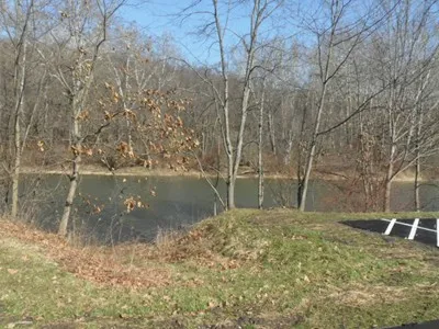

Third picture is a creek at the bottom of our hill.  Great fishing!
