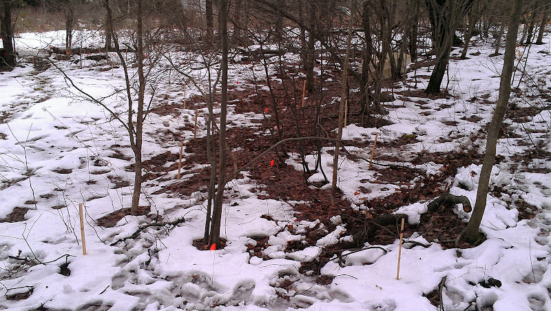

Before photo (April this year).  The wooden stakes are the edges of where I plan to extend the driveway into where I will build the cabin.

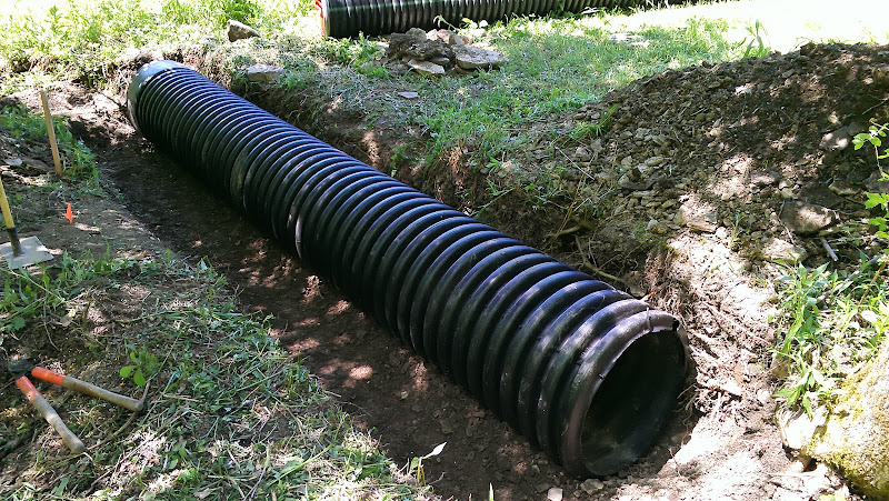

Another 90% shot.  This is two photos stitched together.  The culverts came in 20' lengths, but I cut them down to ~17' because the creek was already starting to bend at that distance.
First (24") pipe in.  I had to manhandle these in and out several times to make sure the walls were straight and the floor level.  I used native soil to build up under the bottoms to provide bedding once I got the floors and walls straight.
Another view of just the first pipe.  That was a lot of soil to dig out (note, two piles, second in back in the shadows is even larger), considering I had to essentially dig it twice - once to break up, and a second time to chuck out of the trench.  Some of the large rocks I dug out are on the right.
Second (18") pipe in.  Tight fit = good.
