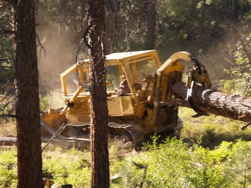

Looking sharp, that house oughta last awhile! That is an ingenious use of the loader, neat truck setup with the pup trailer. I remember them from out west but not sure if they run that setup over this way. This is a friends with the boom at the rear, he can haul a pup on the pintle hitch... when one of us gets an A license. I was using it to set up a hollow oak for a stumpkin that we'll probably fire up this week, we should have rain tomorrow.
Quote from: Don_P on October 05, 2013, 01:26:54 PM
Looking sharp, that house oughta last awhile! That is an ingenious use of the loader, neat truck setup with the pup trailer. I remember them from out west but not sure if they run that setup over this way. This is a friends with the boom at the rear, he can haul a pup on the pintle hitch... when one of us gets an A license. I was using it to set up a hollow oak for a stumpkin that we'll probably fire up this week, we should have rain tomorrow  .........snip.............
Thanks a lot Don that really means a lot to me coming from you.   [cool]  It has been a sort of challenge some of the stuff the Engineer Bob Peters 'dumped on us'.  I was not thinking a footing that large and and all the solid 4x6s and huge hold downs.  Then all the 14 inch LVL we bought and still 'miss calculated' and had too make 'another trip to town'.  We had the little lumber yard we use scrambling as well.  As you say it oughta last a while.  With a 'tin roof' - and a Hardie type cement siding and a nice sized 'green area' around it we hope to cut down on the fire danger from without.  Have not thought to much on the within.  ???  Hopefully our family will hold on to it.  If not someone will have a nice home on down the line.   ;)

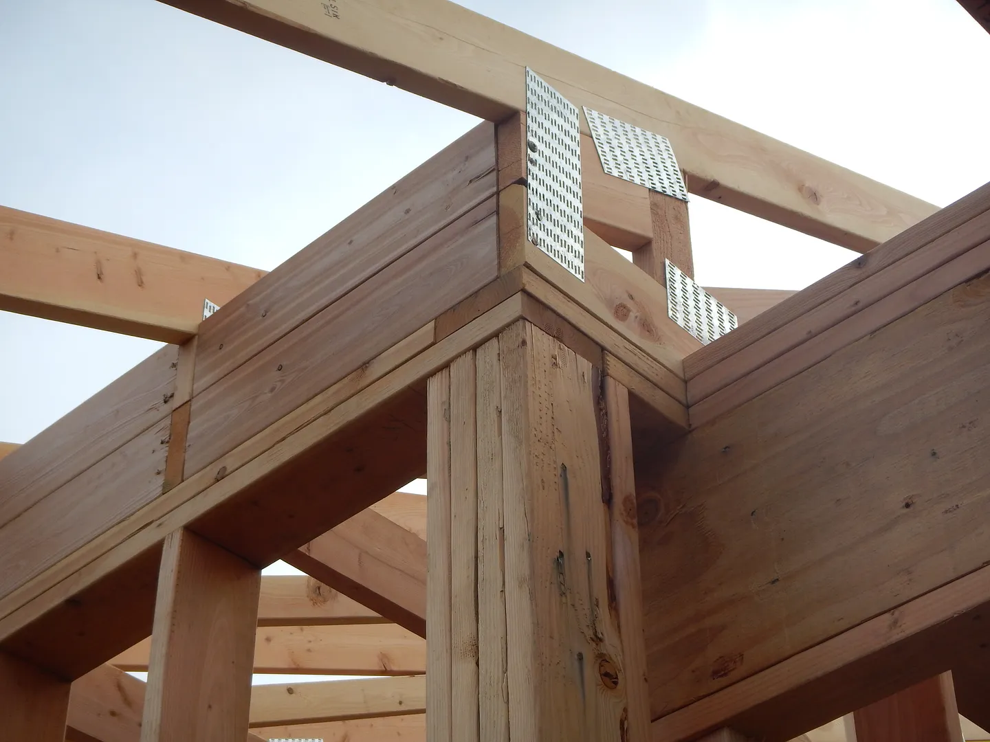

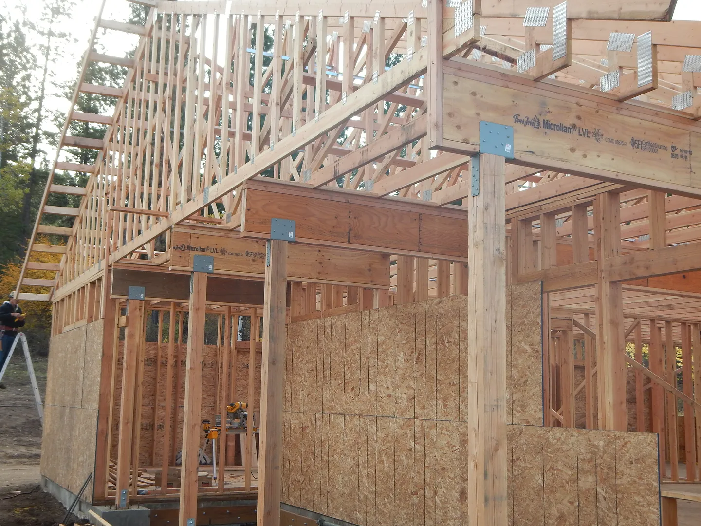

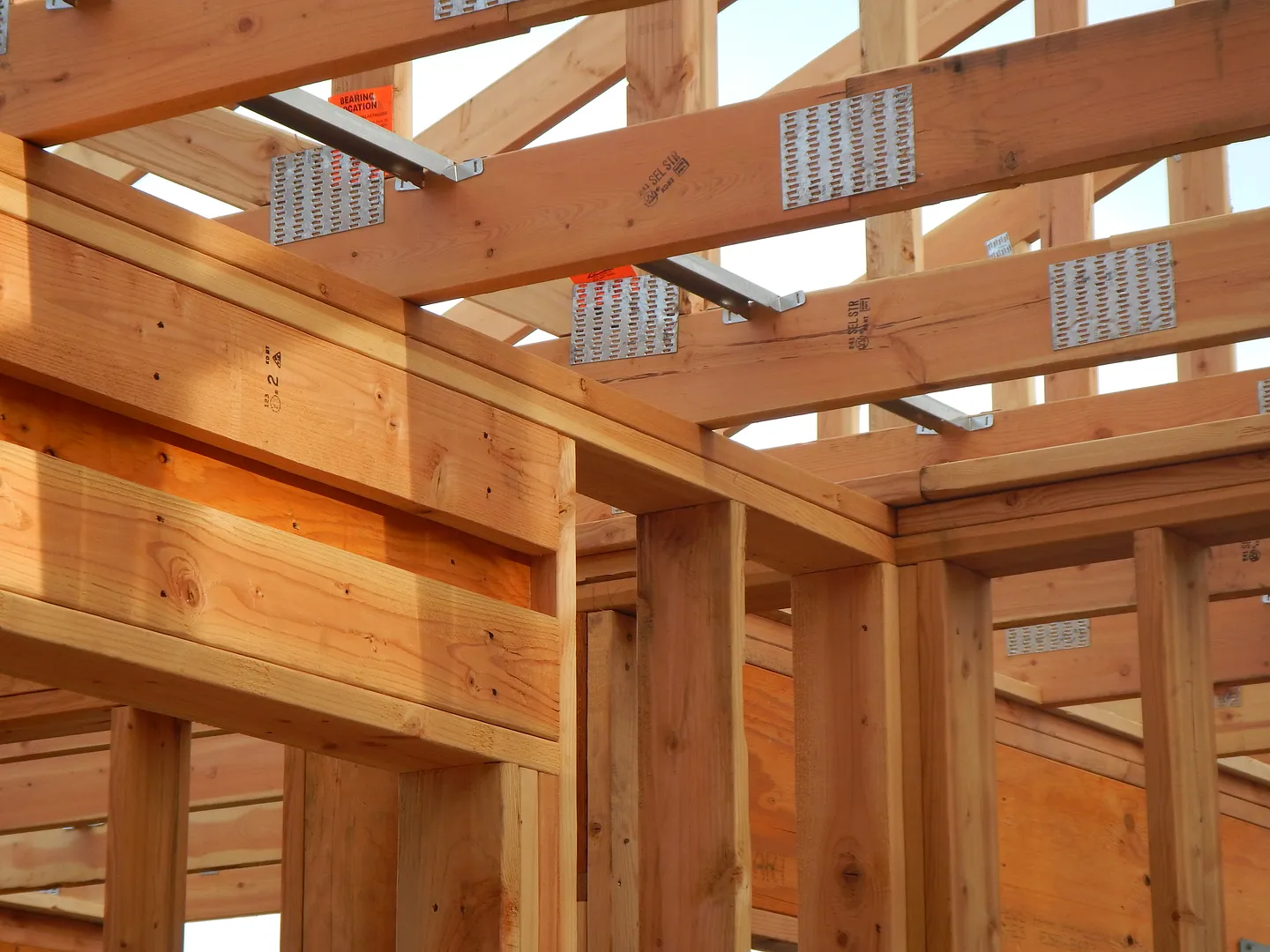

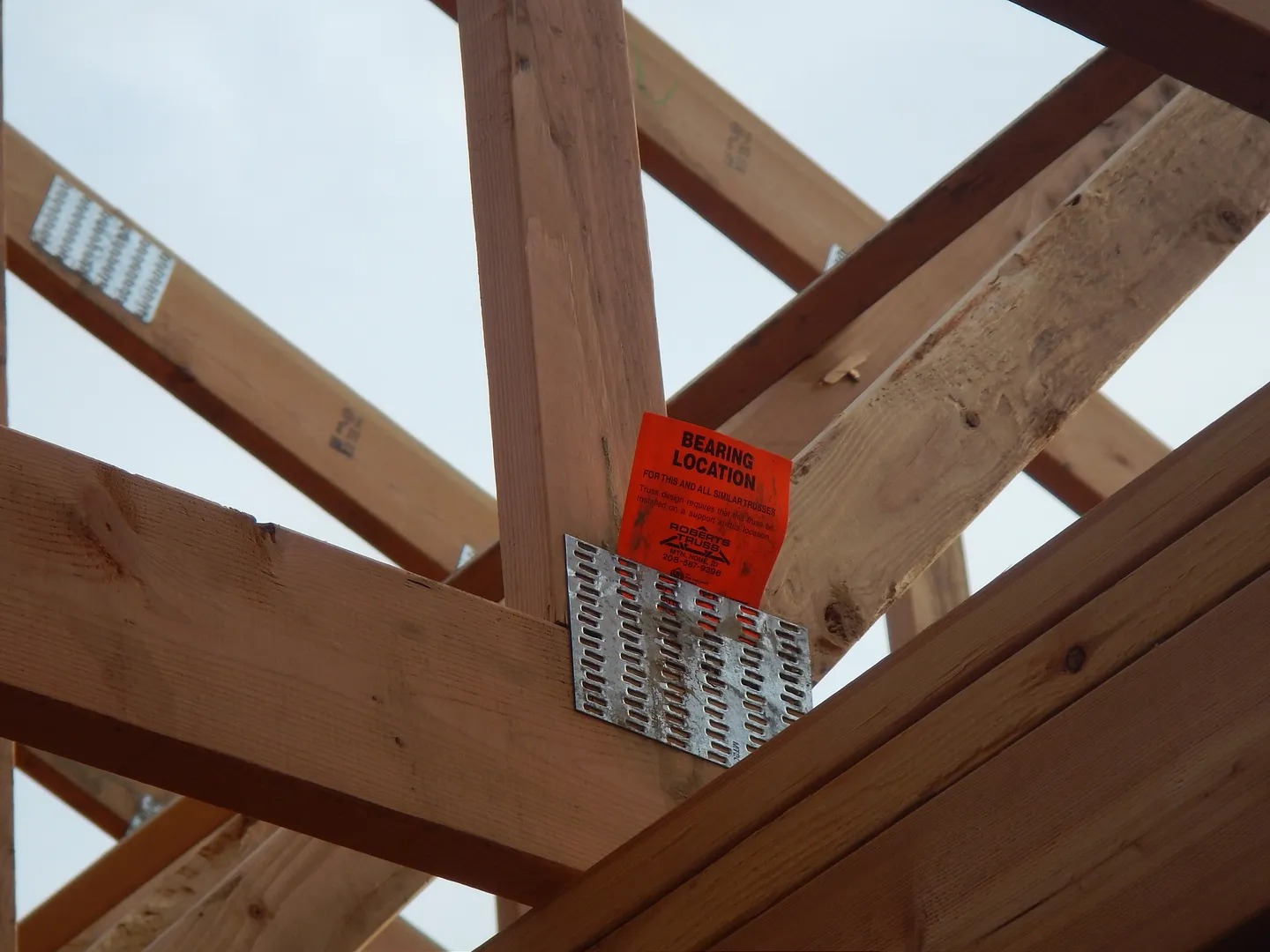

Well we finely got enough 14" LVL up here to finish the porch piers.  We were short three doubles of 95" in the front and one in the back after we set the trusses.  We had to slide them in under the trusses and horse the top plates in over them jacking and pounding and hammering on them.  But that is done!   ;) Still can not figure out where we were all so far off in ordering them.   ???
I have used this truss company before and they always seem to just excel heads above others in the valley.  From a great delivery driver, right down to the tags to make sure you understand where the bearing points are just in case one gets turned or 'stuff happens'.
They engineered all the bearing walls inside the house with 2x6s and LVL beams and headers
We got the trusses double blocked.  I ordered the bases taller so we would have more insulation where it counts next to the walls.

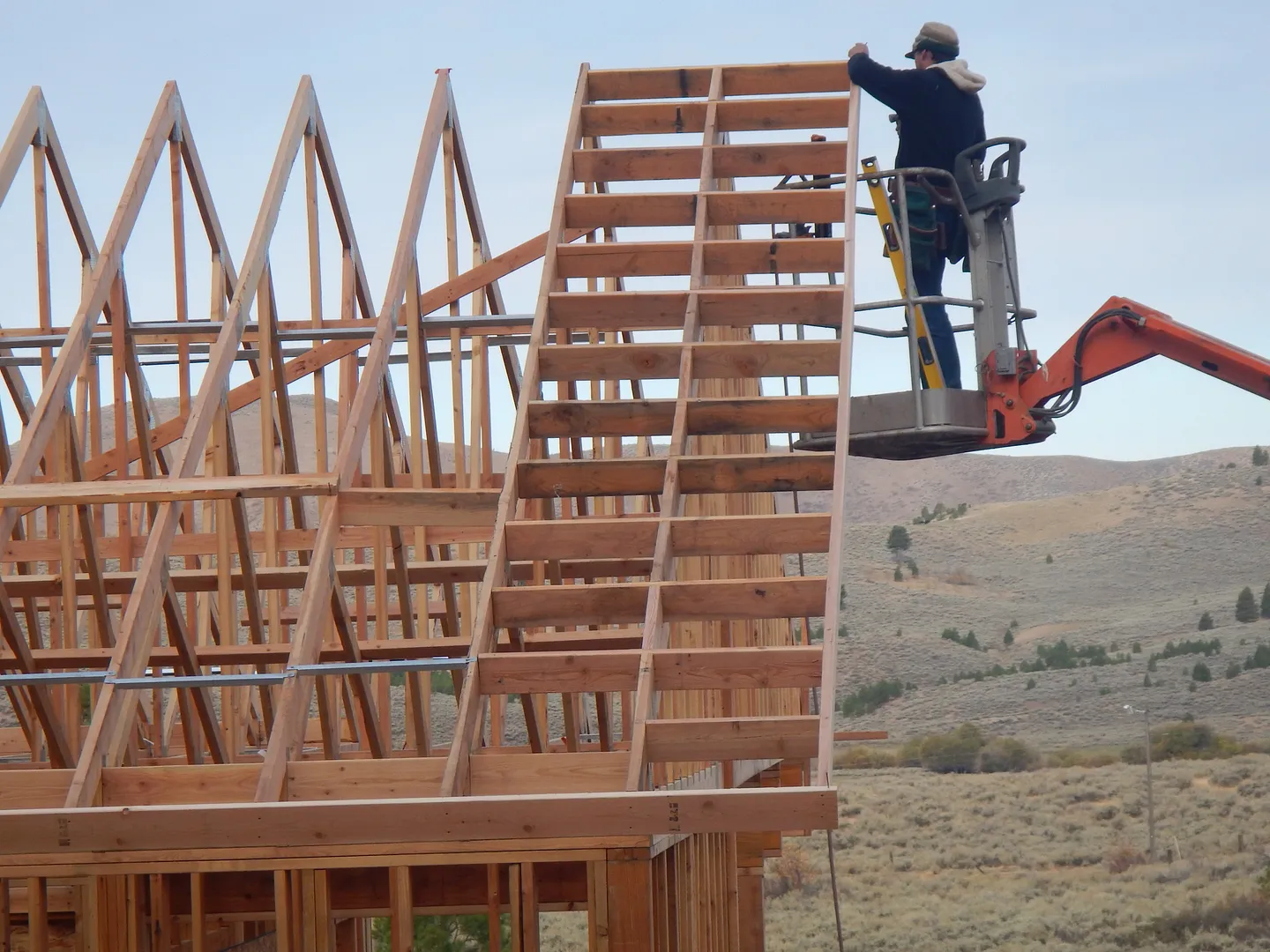

I rented a man-lift to do gable end blocking and some other duties.  They really speed things up and are so much safer than hanging them hang off the trusses..... ;D

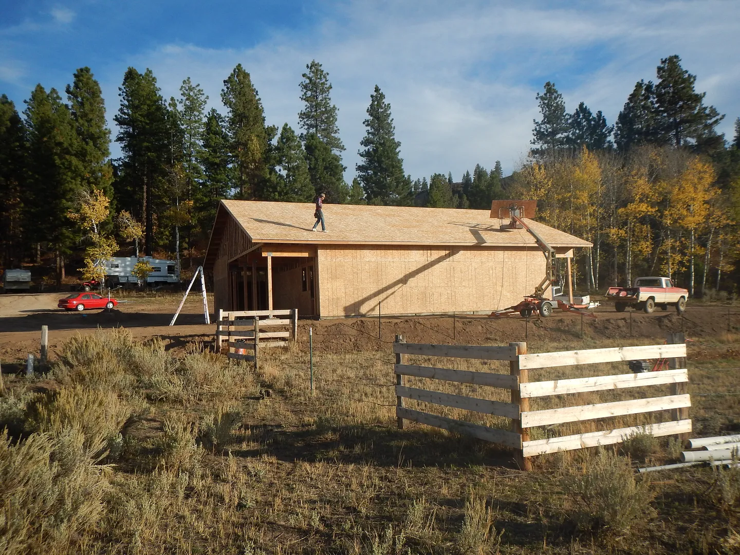

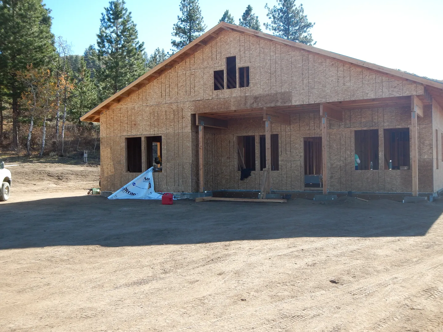

We were making great progress Joseph and I.  Then the man lift went down so we lost a day or two waiting for a 'tech' to come up Monday.  Joseph had to leave for meetings in Post Falls Monday got back Tuesday morning and was here Tuesday afternoon after the drive up from Boise.  And we worked until dark we and we really made good progress.  Today he showed up and he said we would have the sheeting on the roof tonight before Wednesday night  church.  I said no way could if be done.  We sheeted some more on the house waiting for the frost to leave the roof then at about eleven he got started.  We had over three quarters to do on the west side to complete.......  east side is all nailed off.

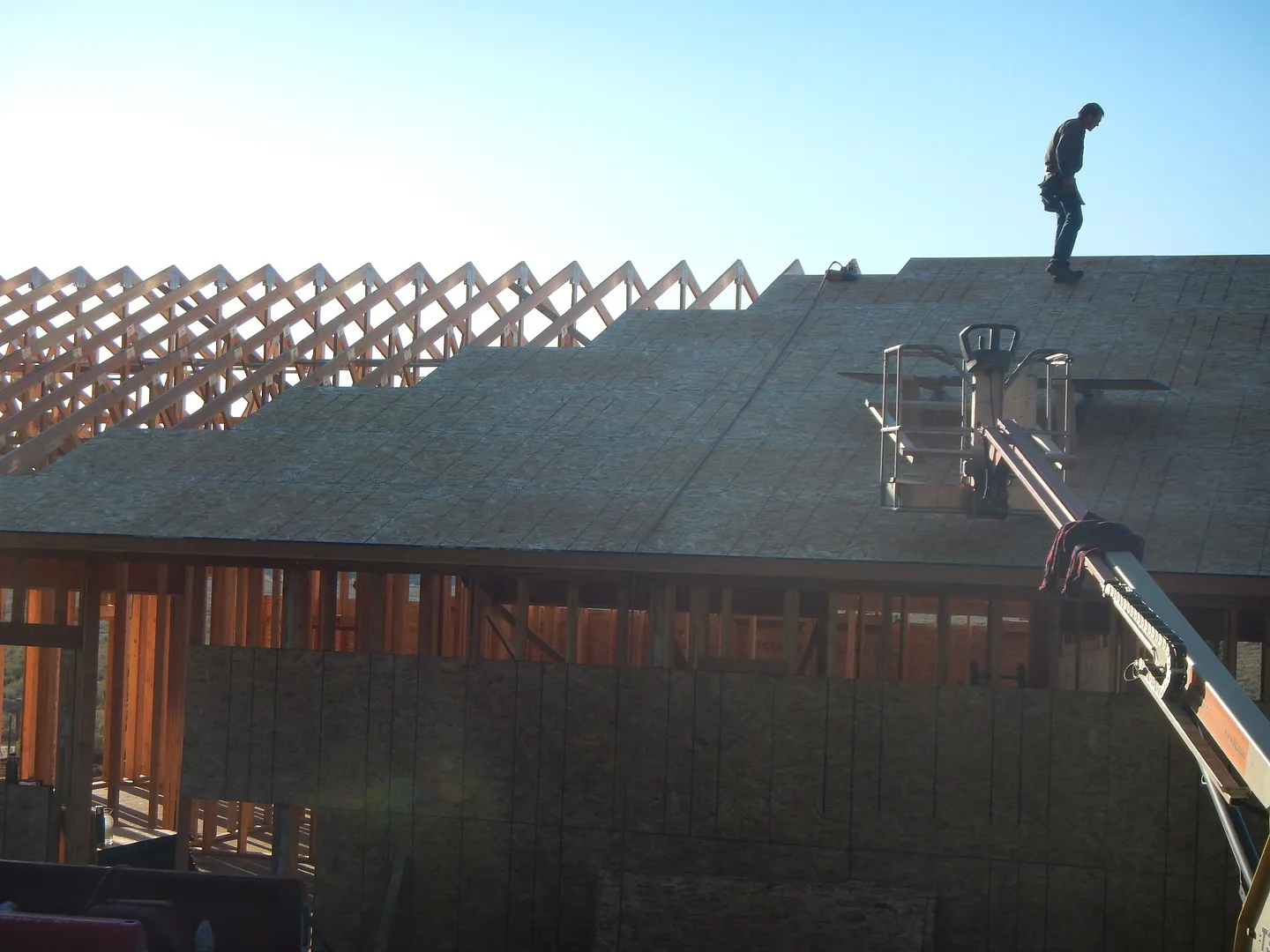

In the middle of our roof sheeting marathon the building inspector dropped by  [shocked]  but just to chat.  [waiting] He said he is amazed at the progress we are making on this with just the two of us work on it and neither real carpenters and what a good job we are doing.  But then as he says building a house for yourself is one of two things -- Trying to do everything as cheap and hurried as you can or they are very well built and a lot of attention to detail.  WE got an official  [cool]
Joseph 5:30 PM with the last sheet nailed down.   I might add no one got photos of me lugging sheets.  No body told me retirement was this hard on the body.   ;)

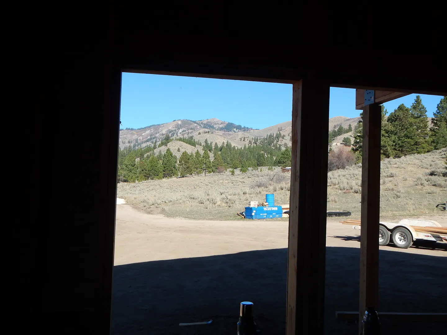

View from the kitchen....

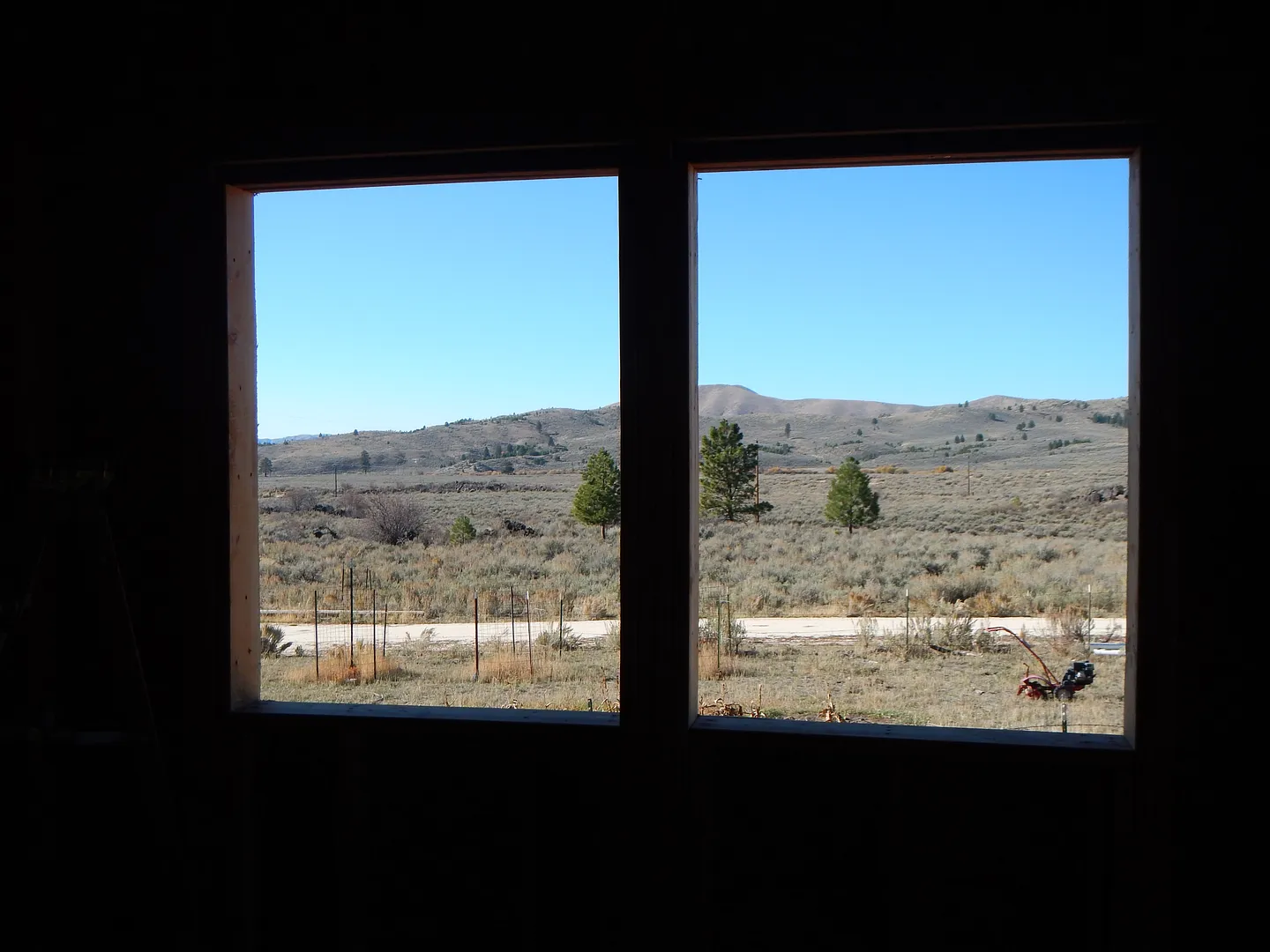

View from the front room

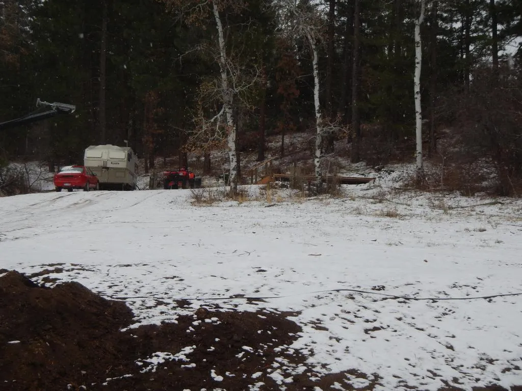

We moved the big tin cabin  (fifthwheel) down to the Valley to get it ready for winter as we are getting ready for the final push on the house and will be anchored here pretty tight.  Several issue were coming to a head.  One the furnace motor was going out.  Two the bottom the the bath tub which as in most this size is nothing more than a deep shower pan or a child's tub developed a crack down the middle which I crafty like mended with a combo of shipping strapping tape and gorilla tape. :D  But I found that combo can only last a certain length of time.   :o    Plus several other issues from the eagle dent from last years snow birding trip to Nv, Ca and Az.    (The one that Ellen says she will never do again.  Says you desert dwellers can have it - she is staying here.)  A couple lights were in need of  repair or replaced.  Plus the roof needed resealed and on and on.....  So we transferred a bunch of stuff to our little old Alpinlite that we keep around for company and issues like this one.  We were even going to move the little Alpinlite to the big fifthwheel spot so we could hook up to the phone and internet but decide we were busy enough with the house that we really did not need to be shuttling units around.
As you can see winter is starting to tease us a bit....

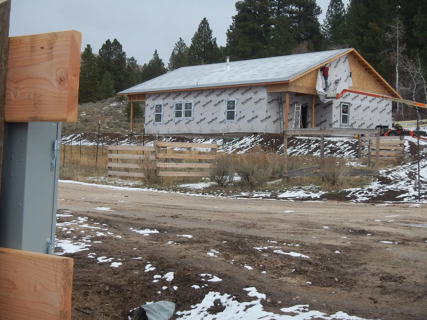

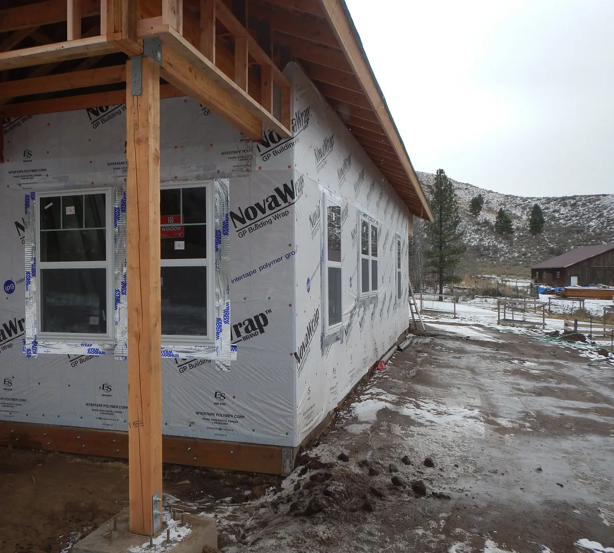

The windows arrived for the house and we got them in.

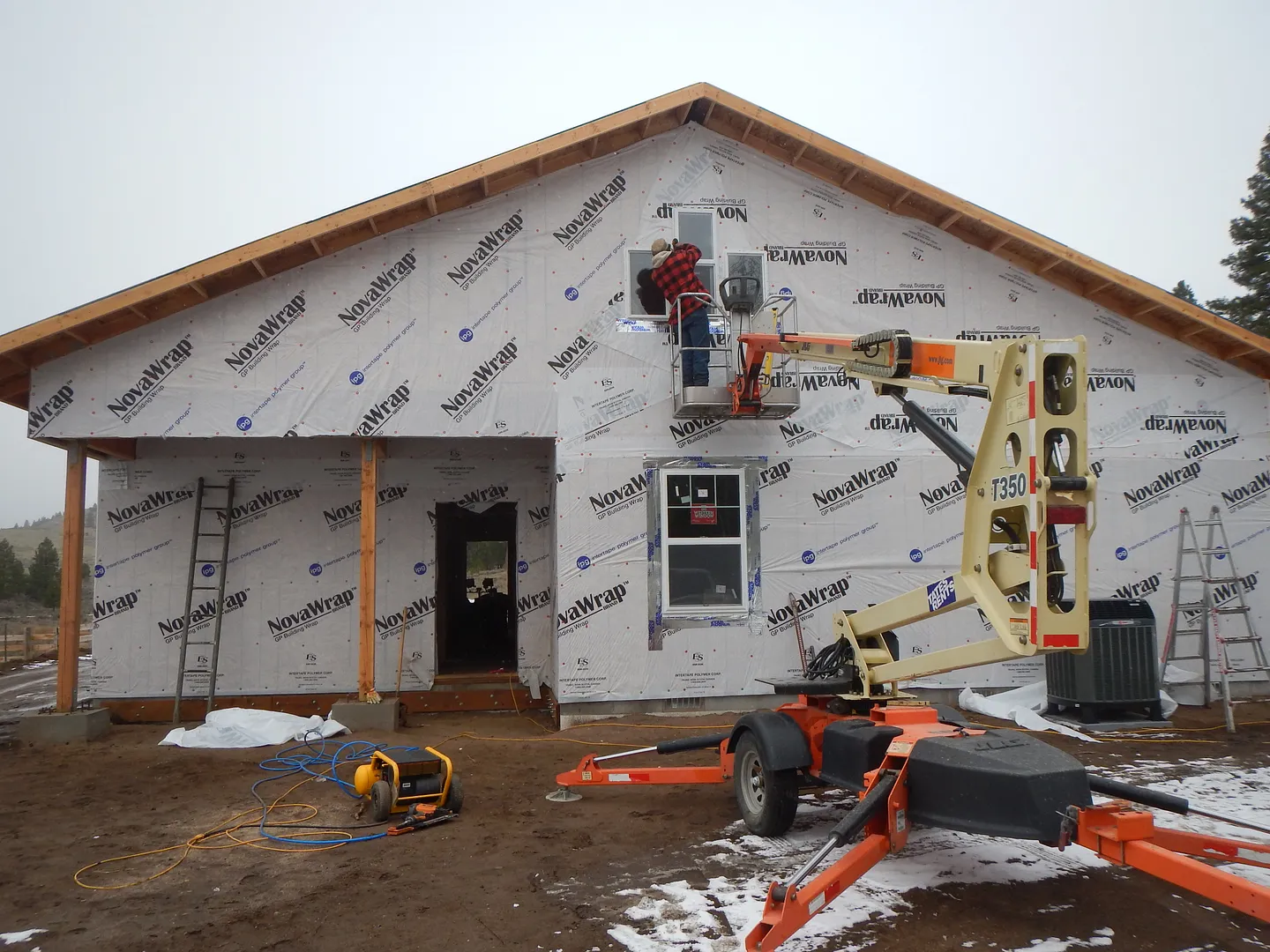

I went down and rented the man lift again as it is about the quickest and safest to wrap the gable ends and get the window lights in to the attic.  WOW are we getting spoiled
We got our final shear inspection.  The inspector has been amazed how well we are doing, for two guys - a retired locomotive engineer and a preacher.  I had him check our hold downs and framing while he was here as well just in case....

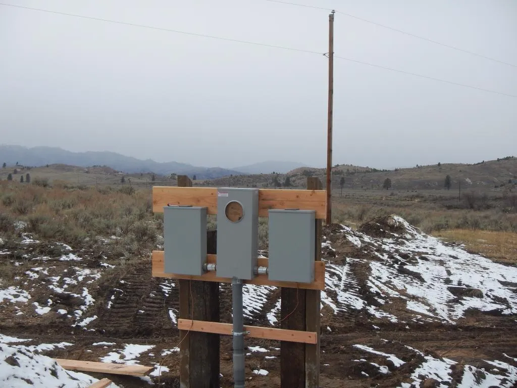

We installed a 400 AMP meter base and split it into two disconnects.  From there it is 200 feet of under ground 3 inch conduit and sweeps to the house.  The other side goes the the shop if I ever run wire to there.  That is another 200 ft or so and the conduit is buried.
We got the big fifthwheel back up the hill into its spot - no small feat with the current weather patterns...... and I hooked up the internet satellite tonight as this is the last night in the little fifthwheel.  We will get everything put back and I will winterize it and most likely move it down to the valley for winter.
