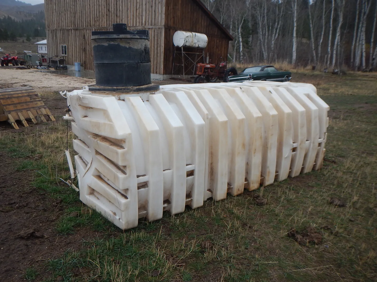

One of the small  homesteads here had a large tank buried and it started giving them trouble.  My buddy with the equipment was hired to dig and see what was the matter.  Both ends had collapsed and cracked.  They had him remove it.  My place was close so he tossed it out here in case I can use it.  Nothing goes to waste like that up here at Prairie so it seems.
I am sort of thinking of chain sawing the middle out and using the top and bottom for raised beds or ???  Any ideas will be entertained.

Looks like two haves would haves would make good stock tanks.  I would paint it black to protect from U.V.

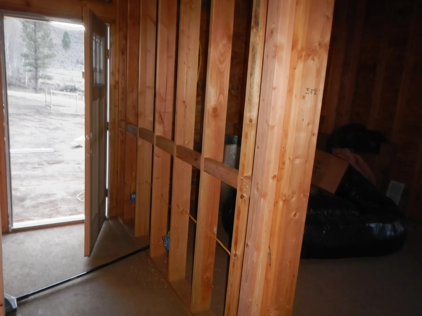

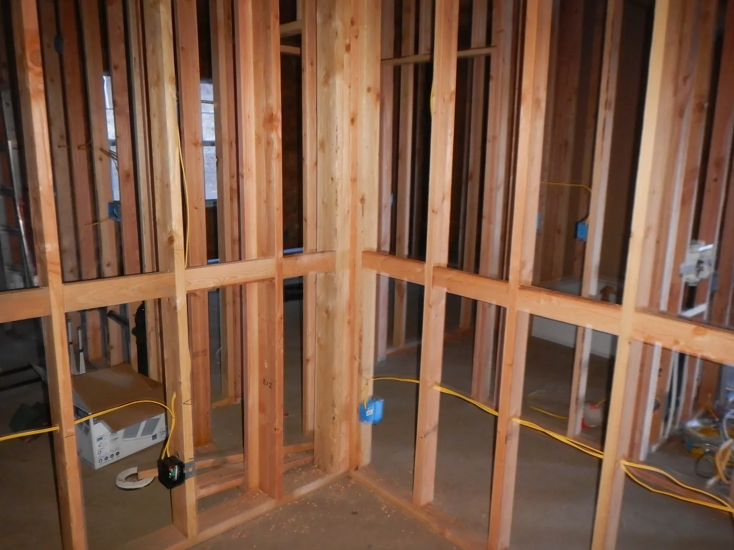

I spent a good part of a day putting in blocking for hand rails and such in the bath rooms, and the blocking for the wainscot in the house.  Sorry the lighting was not the best.

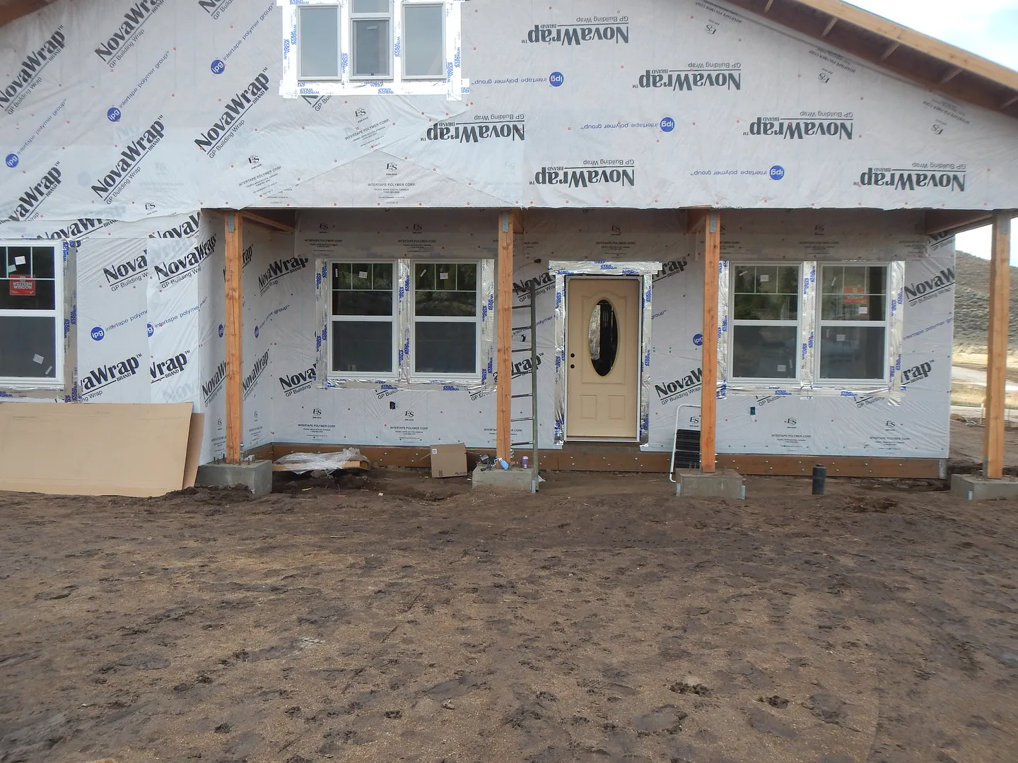

We got the exterior doors in as the siding guys are scheduled in
Front
Back

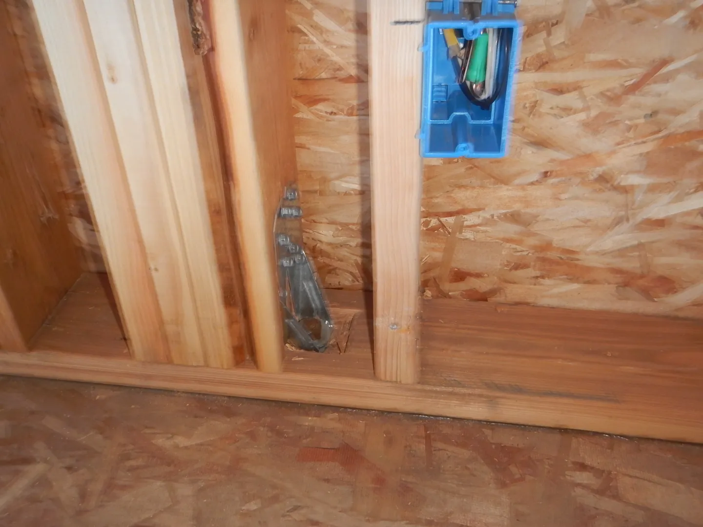

As we are getting ready to call for an electrical inspection and we then will be covering stuff up I thought I would show one of the eight heavy hold downs call for by the engineer.  Those bolt to and 18 inch j bolt poured in the foundation wall and bolt to a 4 X 6.

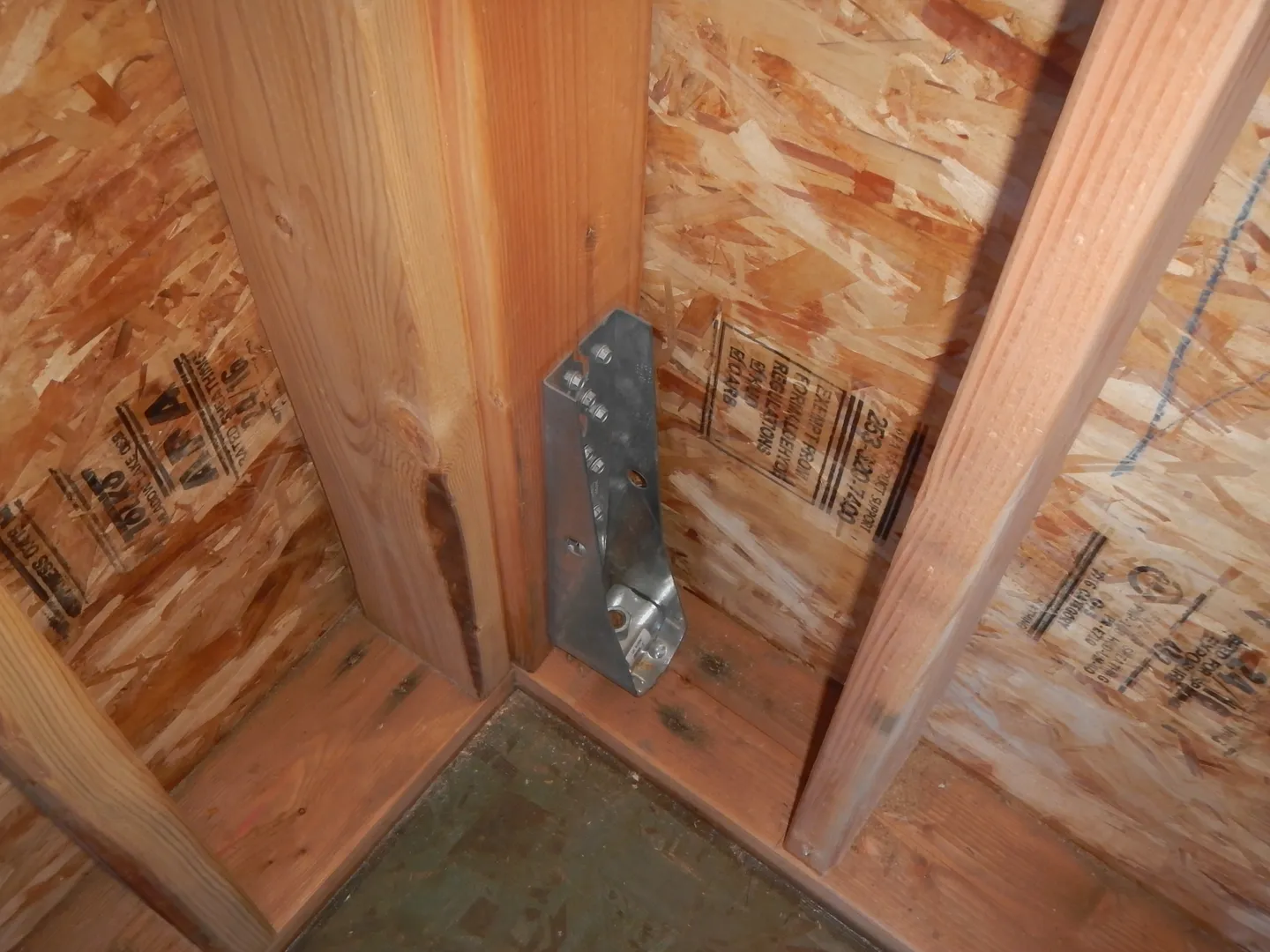

This is one of the two lighter weight hold downs. They were a smaller size j-bolt and on the opposite end of the house than the huge ones.
Engineering called for six of these on both sides of the house

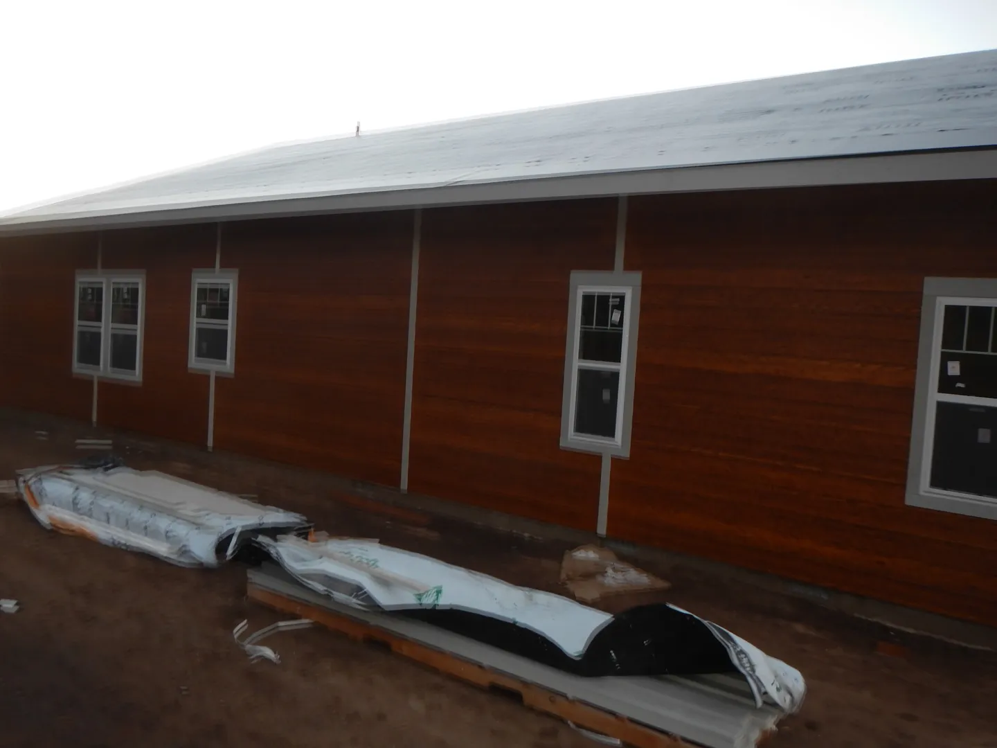

The siding guys got here today about noon it was getting late when they knocked off but WOW can those guys work hard.  Again sorry about the bad lighting but I/we sure liked how it is coming out.
Great progress
what kind of siding ?   it is looking good
those hold downs are impressive --- I did not realize Idaho was in a hurricane hazard area......
The siding is a cement fiber siding by CertainTeed with a Colorguard by Woodtone stain.  The stain goes on with several applications according to the sales people.  The first coat is a lighter color and cured.  Then it gets a darker stain and the machine squeegees it off and cures again. So they claim.
I think part of the reason for the tie downs as they are is because of the open porches on both ends of the house.  While we do not get hurricane hazards as such winter is a world to itself, and the reason many people do not choose to live up here year around.  120 pound snow loads and 90 mph wind load planing and or engineering is now required.

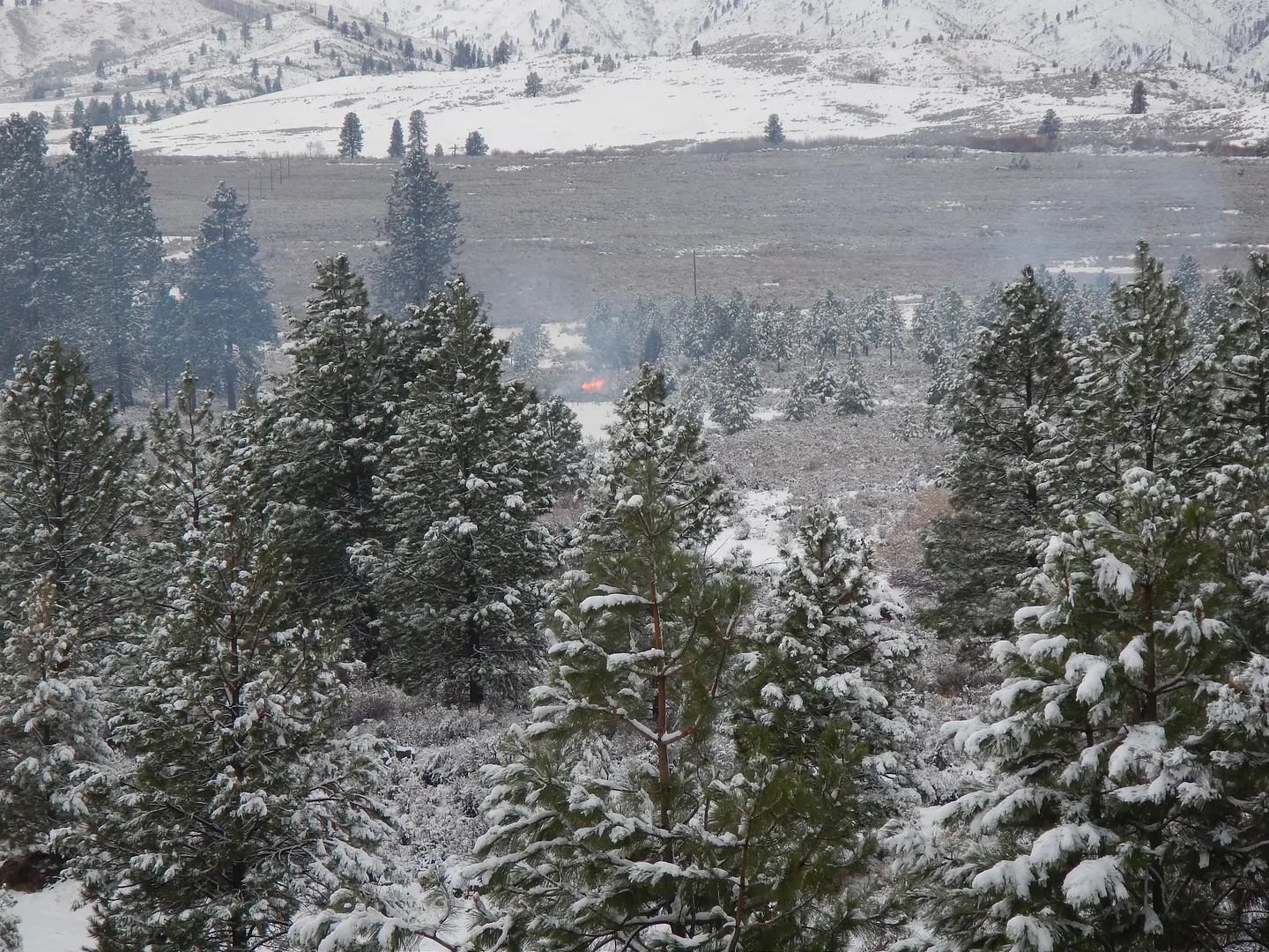

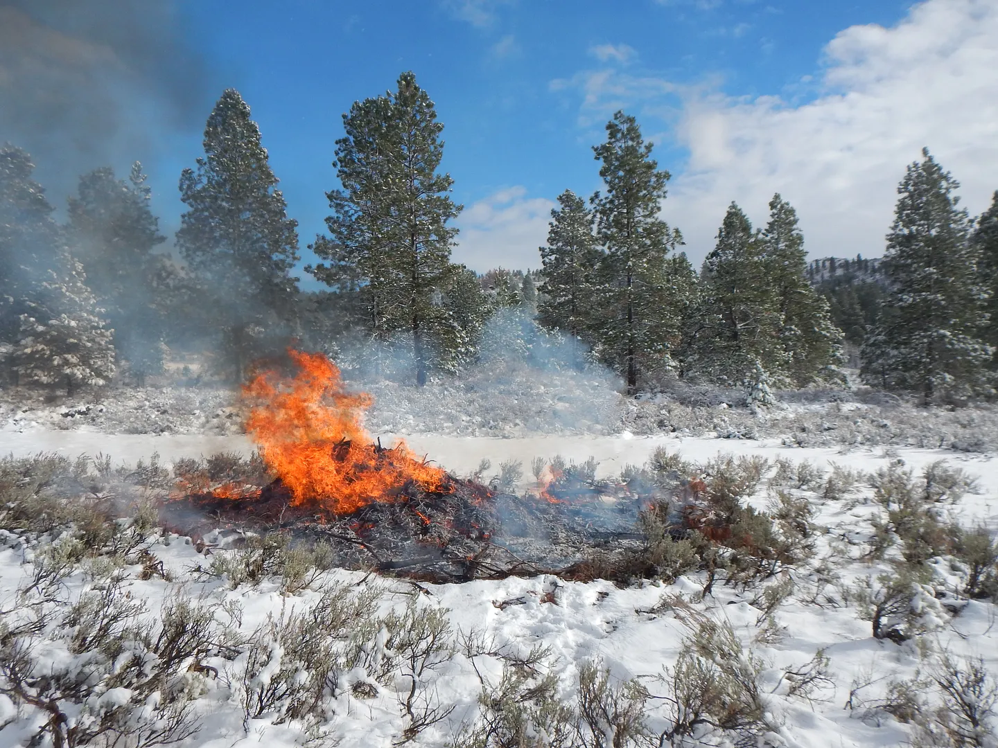

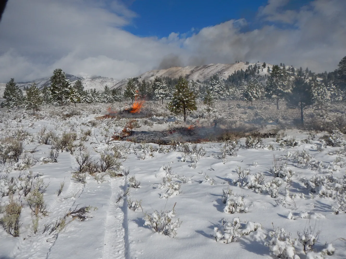

Today was our first heavy snow so I did my first heavy snow ritual.  Combined some gas, diesel, and was short any used motor oil so omitted it from my recipe and went a lot heaver on the diesel.  It is the day I always burn my 'green piles'.  Green piles this time of the year are hardly green and are usually very brown and burn with a vengeance.  We do thinning of pines and pile them in green piles when the pine beetles are searching for stressed trees.  The pine beetles sense the thinned trees and limbs in the green piles are stressed and are attracted to them.  They lay their eggs in them and  we burn those piles in the fall or early winter.
Green pile when I piled it this spring - summer
Now a pile of ashes

I like pictures of burning crap in the snow.  ;D
#119
Quote from: MountainDon on November 16, 2013, 09:43:04 PM
Yep to me there is just a couple things about it.  It signals winter and two I have yet to have one to off and get away and go out of control.  I hate the thought of having to call 911...  for something I have done. ;)  And the next snow it is all covered up again.
I was glad to see the rain here night before last. We had been in the smoke for 3 days with a wall of smoke coming over the Nat'l Forest to our north. It was dry after leaf fall and something got out of control. I haven't heard the cause or damage yet. To be honest up there fires historically went through every 5-15 years before smokey the bear. Since about '28 we have supressed them and one of the pines has become rare because of that. The neighboring mountain had a large prescriptive burn a couple of years ago, but without prep and all the duff on the ground now I wouldn't want to be the one to have a hot fire get out of control. For us fire would help control some of the thin barked weed tree species but if one of my fires got away it would endanger several neighbors... one of the reasons for Smokey the Bear. I've used the saw and one of Monsanto's more famous products to slowly work on them. 8 point Fri.
I read you loud and clear....  I have fallen back on Monsanto's claim to fame as well.  We tried some Telar on Knapp Weed this year.  My wife stewed and figured and refigured to not over dose.  She got the dosage right.  We sprayed and sprayed.   >:(  To bad the Knapp Weed did not know it.  It did wonderful this year for Knapp Weed.  Both the unsprayed and sprayed.  No one knew or could tell us why...  Me I think it was in the zodiac...... :-\
Here the USFS uses prescribed burns.  When we lived in town you would read in the paper where they were going to light them off from time to time.  Up here where papers are not....   Undoubtedly it is on the net somewhere.  I have never tried to find such.  Might even be on the Boise National Forest Homepage.   ???  I use the Prairie browser -  When I start smelling smoke of that type the best thing to do is ride the four wheeler over to The Y-Stop General Store and get a cup of coffee, a pop or a candy bar and ask as if you don't care really, 'Forest Service said anything about any burns?'  One of the rangers always it seems drops one of the notices off there.  Court the owner will as the Prairie Sage bring forth wisdom.  'Yep burnin' over in Smith Creek or Meadow Creek.  Sure stinking stuff up, be a couple days.'  Really don't know what I would do without Court some times.  He has visions of retirement or selling out.  He makes the best double cheese burgers with ham.  And his news is better than most any bodies around.
Might sound sort of strange but fires like that smell differently than a fires out of control.  Brush and the stuff they try to burn out just does not smell the same.  If that is negative nothing at the Y-Stop you can take a ride and look for smoke.... There are several great rides that let you look out on great vistas and are a great break for the day.

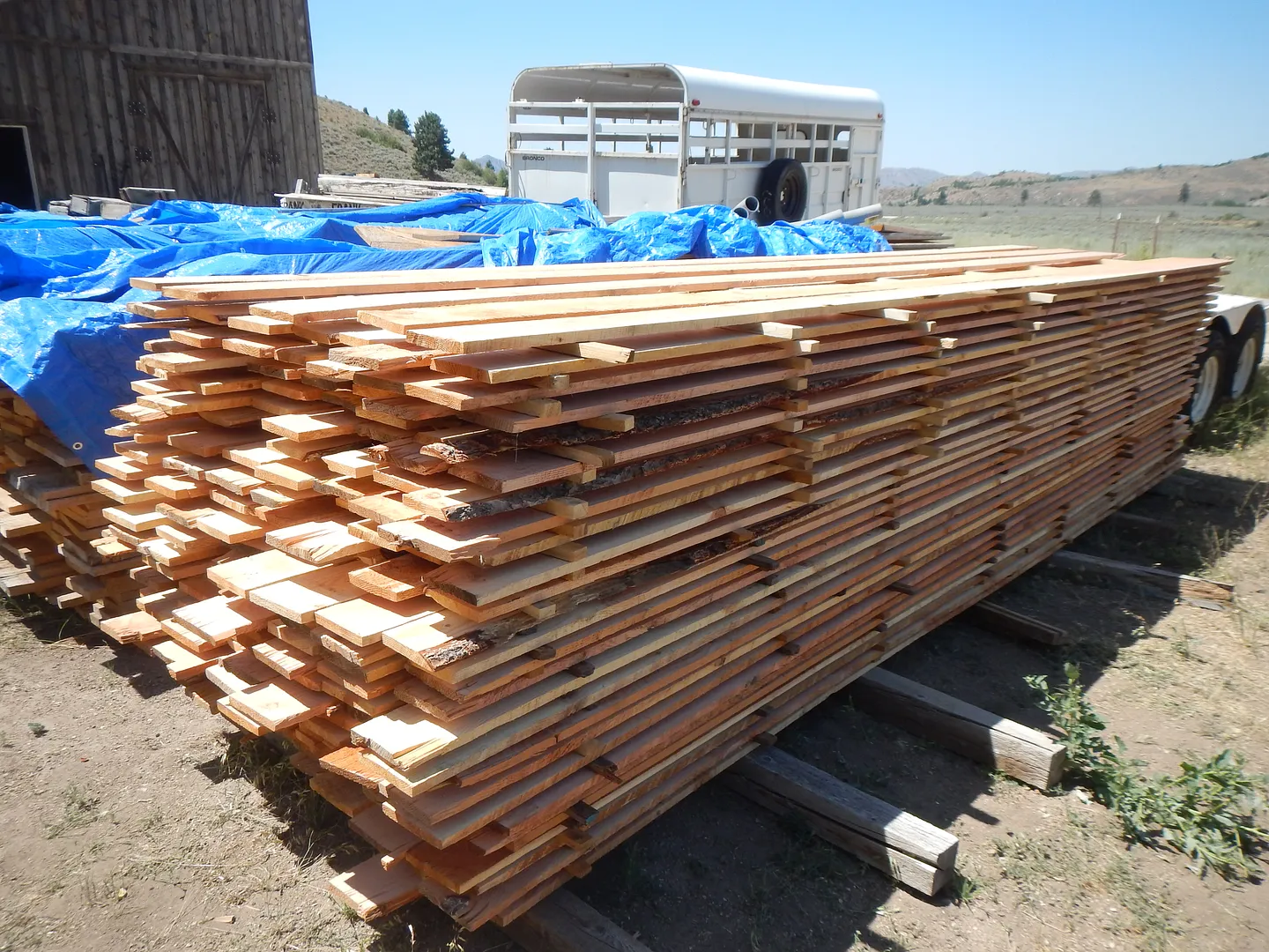

Remember the pile of 1x5 or 6s that I had sawed and stickered for the floor last summer?
Well its time is growing short.  I have wanted to finish planing it and tongue and groove it but it has been a little hectic for such.  With the house and all.   ;)
Now Ellen has come up with an idea that has worked for others up here.  She is wanting to hold it as wide as we can and not tongue and grove it but edge joint it.  Then counter sink screw holes and screw it to the subfloor then plug and sand it.
A very high end home up here we have never seen inside of has such and has worked well up here with fir.  Another has pine and it is great as well done much the same way.  We know the people real well and know they would love to show it off to us.  But I guess my question is.... ??? got any ideas pro or con.  How far apart would you countersink the screw holes and what kind of screws would you use?  Am I over looking something?  I have done tongue and groove hardwoods and been around even more being laid but this approach is a little out of my comfort zone until i get it screwed down........
i
Personally I would not go this route.  Chances are that there will develope gaps between them from just humidity changes itself.  It would be more likely to cup since there is no T&G to keep the face in alignment.  If I went this route I would make her sign a wavier that she is the one to keep the dirt out of the crack.  ;)
Ditto, I wouldn't, but I have. If it is intended to be fairly rustic I guess it's ok and that floor turned out fine and has never had a call back. Pine or fir are going to move less than a denser species. Is the wood quite dry now? Either way I would get it as dry as possible. If there is a shop with a molder anywhere within reason I'd take it in and have it T&G'd, screwing and plugging takes longer as well.
