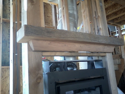

That's exactly what I ran into----since my fireplace is centered exacty under the ridge pole, it had to be diverted.  The manufacturer installation instructions spells out what's allowed.  The nice part is, when you box in the chimney out the roof, you can straddle the ridge so no runoff flows downhill to it.  Sounds like you're drafting a good long distance, all on the interior---this is a recipe for a well drafted fireplace.  Two 15 degree turns won't hurt things a bit---just makes sweeping the chimney a little harder.
We used a Bis Nova with the AC (air cooled) chimney so the clearances are only 2".
   I wish I took more pictures, but you can see the offsets here.  THe same chimney chase holds the gravity wall furnae flue as well.
   Here's the chimney chase.  The flue for the furnace is hidden behind it on this side so there are now through-roof projections on the street side
