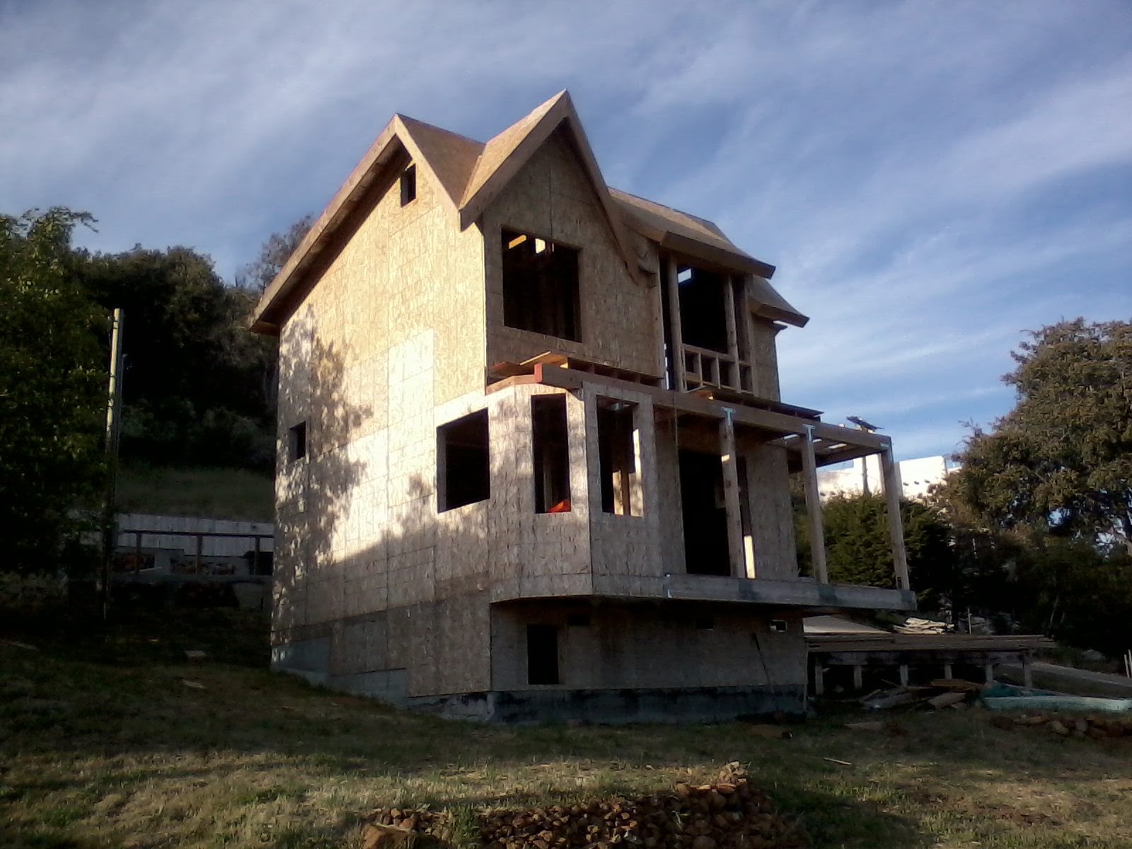

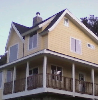

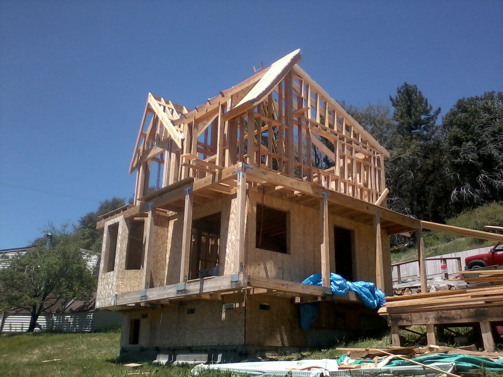

  Yes---the 20x30 footprint translates to 600 square feet of roof framing, more wall framing, sheer panel, longer romex.. The 20x20 is basically a cube and the fireplace and wall heater are in the center of the first floor---the heat radiates pretty even (the loft in the 1 1/2 gets pretty hot)  If you compare the volume of the structure to the exterior surface area, a cube is hard to beat (unless you want to live in a sphere)
   The perimeter foundation for the 1 1/2 translated to 120 linear feet (20x30 with a wall in the middle where the structure steps down) vs. 80 linear feet for the 2 story
So this one follows the slope.  I've got beams going every which way
And this one's the basic cube
So the framing was much more direct
  Plumbing runs were shorter, which not only saves materials but also gets the shower hot sooner.

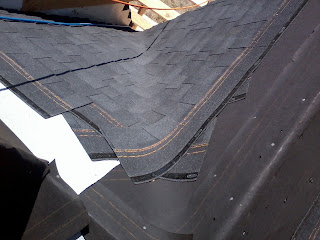

   I'm a huge proponent of designing exactly what you think it should look like, then figure out the best way to do it....   I also put the membrane down first, but in our area here (hot summers, lots of pine needles)  I won't put in the metal flashing---I've fixed other people's roof leaks too often.  No matter how far back you put that flashing there's still a downhill pathway you create with a roof edge right where water flows.  Metal under shingles shortens their life span, and when pine needles pile up there they find their way under that edge of shingles.  If you line the valley with EPDM and lace (or weave, if you prefer) the shingles, being careful they fully embed and no nails in the valley, it's pretty foolproof.
   It's a little hard to describe the downhill pathway I'm talking about, but if you fold a piece of paper to make a mock-up, and imagine a line angling off downhill from the crease that is the valley, you'll see what I mean.  You tear off roofs like that and see a classic corrosion mark angling down that metal flashing to its edge, then the water slips underneath back to the valley.  If someone had a roof leak inside anywhere near a valley, and that valley had metal flashing, that's where I'd find the leak.  Ugly blops of Henry's would get them through the season and give them a few months to save up for a tear off and all new roof.   The roofers I learned from felt that the less metal under composite shingles, the better
Also some cheap insurance----if you cut some scrap wood and bridge the very bottom of the valley, when you lay your membrane down, install the felt, and lace the shingles, they have something solid to rest on where they bend into that valley.  Later when you're walking up that valley you don't tear anything (except maybe your achilles)  If you look carefully you can see the strip in the valley there...Also in my earlier reply on this thread you can see where I learned the mistake of dissimilar pitches on the 1 1/2 story build---the shingles don't weave 1:1.  If Don drove through our neighborhood he'd no doubt spot that flaw and I'd have to dole out some mea culpas and a beer.
