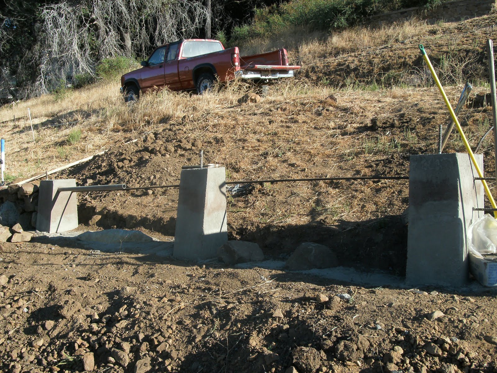

  First dug a trench for a footing and formed up some pillars... (The pipe you see there was set in place to give me a good place to bend rebar in the future)

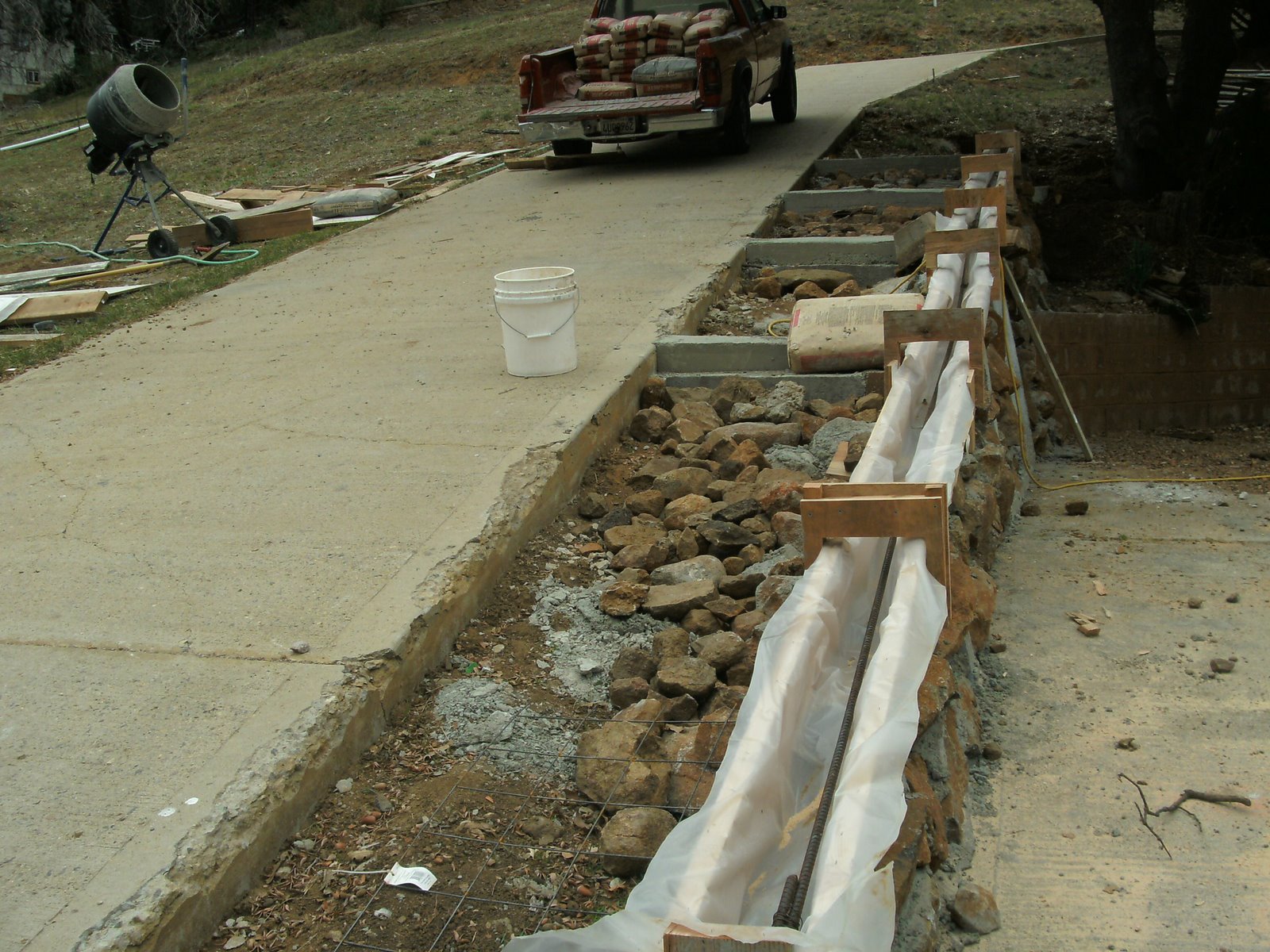

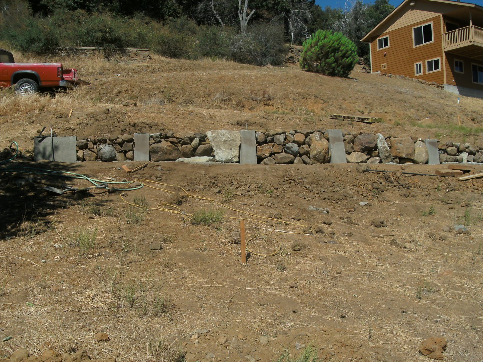

Then dry stacked stones between the pillars, being careful that every stone on the backside has something pointing towards the hillside.  Then I put a sheet of plywood behind it and dumped concrete between the drystacked stones and the plywood.
Then formed a curb across the top out of plywood, with an open bottom.  Lined the whole form with plastic so the concrete would conform to the upper edge of all the drystacked stone
  So that's the whole stone method.

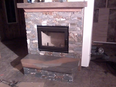

   Now for the veneer method---I bought a wetsaw on Craigslist for $50.  Best money spent on the whole project.
   I don't know what kind of stone you have---this is platonic schist and VERY hard so the cutting isn't quick.  I used this for the fireplace surround and to veneer the chimney so I made a cardboard template nad my daughter puzzle fit all the pieces for me
  Then used the Mapei adhesive that you mix with water to stick it to the hardibacker.  Up the chimney I used expanded mesh like you're talking about
I went with the expanded steel on the chimney so it could be stucco/stone mix.  All stone would have been nice but it was taking way too long so this was a shortcut

That's why I sent pics of the chimney----20x30 would be LOTS of veneer.  Just a standard diamond blade in a wetsaw will do it.  You could rent a big one for a weekend and just keep cutting, then do a mix of stucco/natural stone over expanded steel
