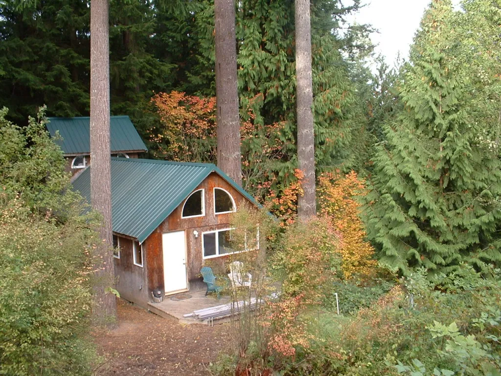

Several years back, while remodeling a house in the Seattle suburbs, I purchased some land in the outer suburbs/foothills to build on once I sold my house.  Ended up finishing the house and selling it, but then realized that infrastructure and building costs would be higher than buying a turn-key property somewhere else.  Not to mention, I hated the idea of a pressure distribution septic with a sand filter that required annual inspections.  Thanks, King County!  Ended up heading north and found a hardcore fixer cabin on a nice chunk of acreage in the foothills for a very reasonable price that was far less than it would have cost to build on property I already owned.  My new place came with a well, great springs and a creek, and a modern gravity septic with infiltrator style drainfield.  Sold!

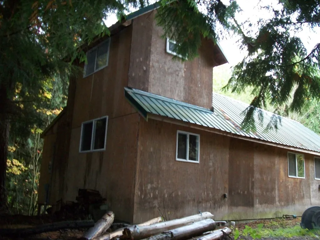

Now, for the cabin.  The cabin started out as a shack, and over the years it was added on to in various directions.  Hence, the "remuddle" part of the title.  I'm friends with the person who did most of it, and they'll freely admit that it was their learning experience.  Some things were done well, and others...um, not so much.  I've been here a while now, and have been picking away at little stuff while contemplating the larger projects.  I like cheap, so I'm a big fan of making do with what's already here and remodeling via Craigslist.
Before closing:
Big Doug Firs-When they shed branches or drop big chunks of wet snow, it gets one's attention inside the cabin!

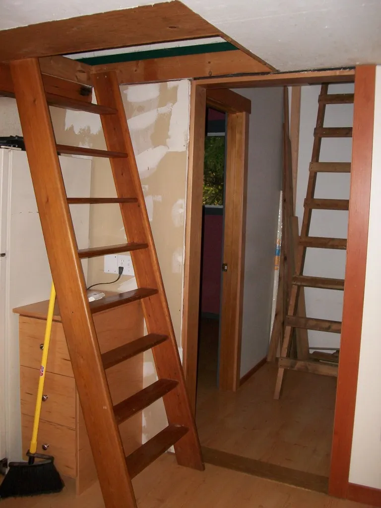

What used to be an exterior window that's in the wall between the two loft areas.  Note that the floor level of the two lofts is off by about a foot.

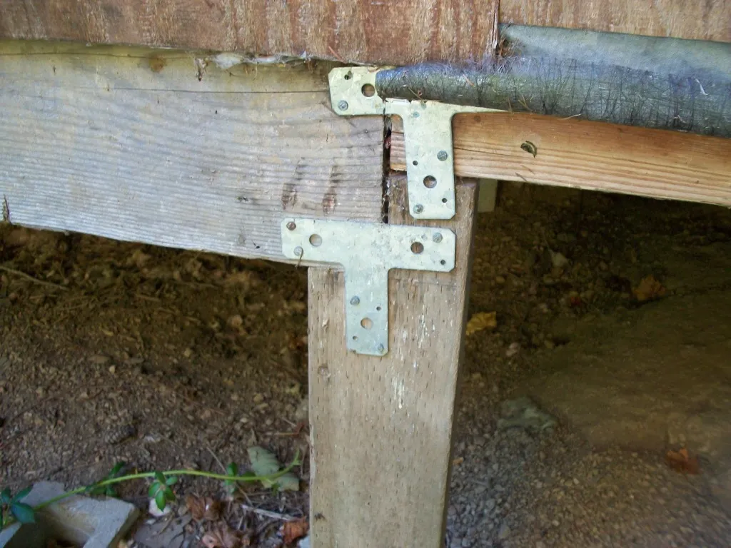

Timber frame "joinery"
Stick is about 1" in diameter.  I've since relieved the bark about 2" deep.  The tree is about 4' dbh.

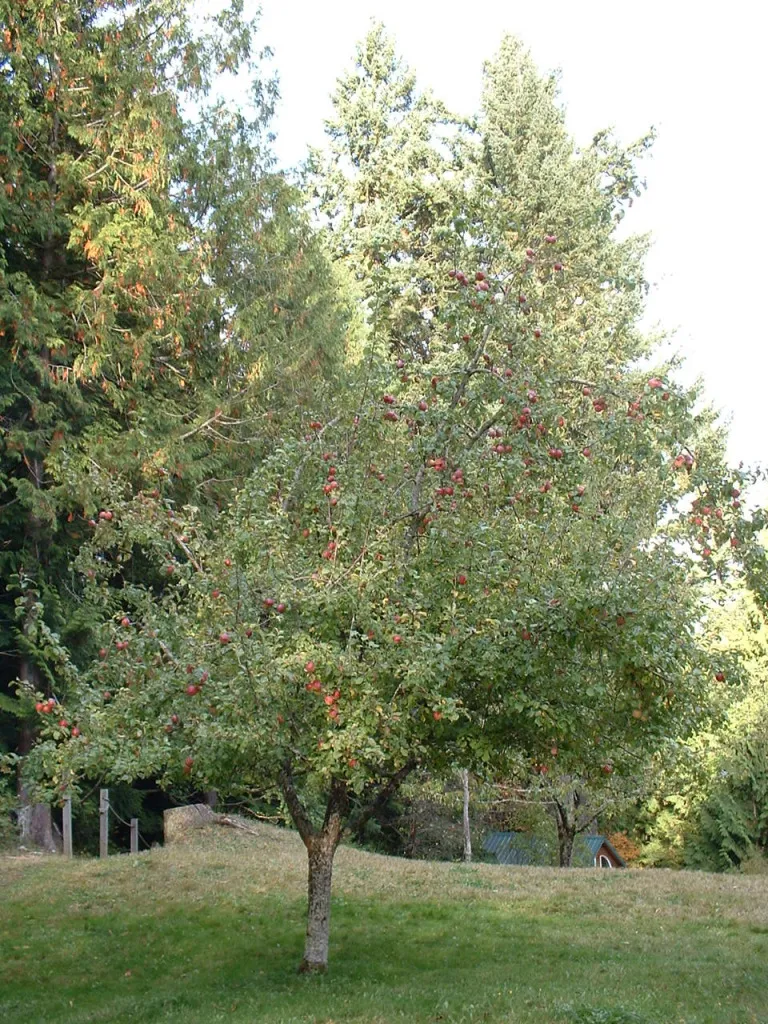

Anjou pear tree
Akane apple tree
Liberty apple tree
BIG leaf maple
It's a great year for Akane apples! My tree looks about the same :D :D

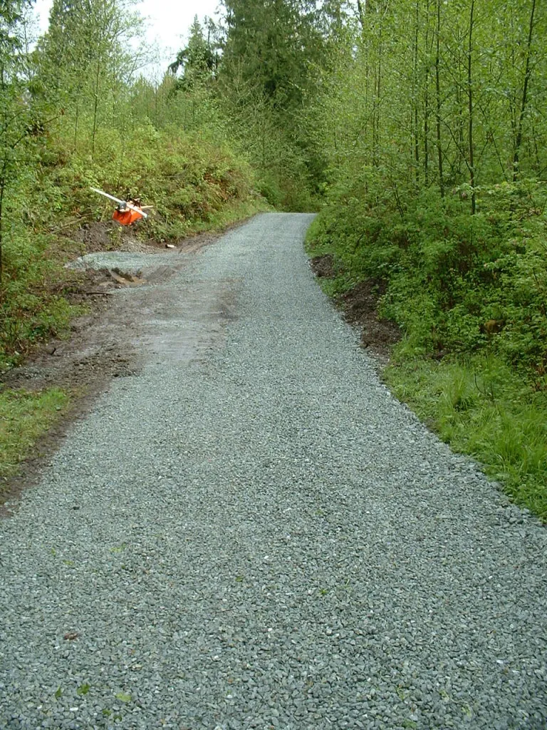

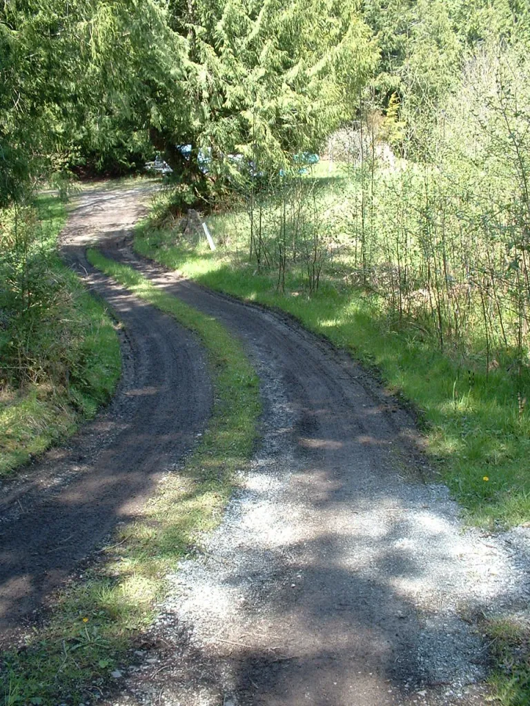

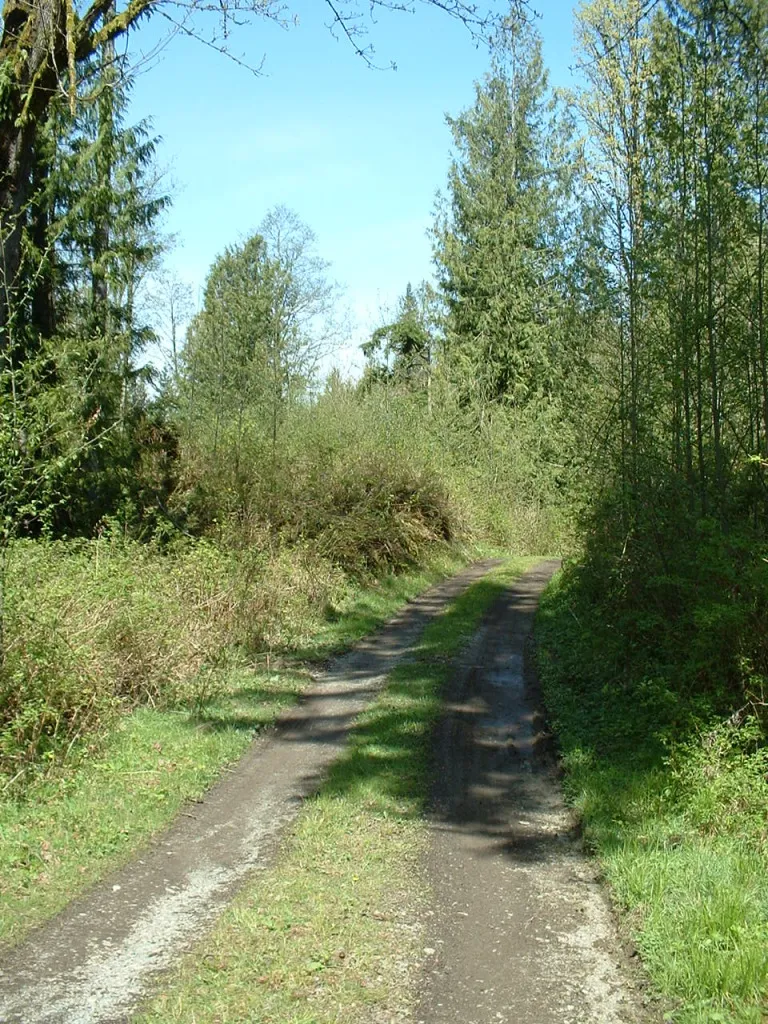

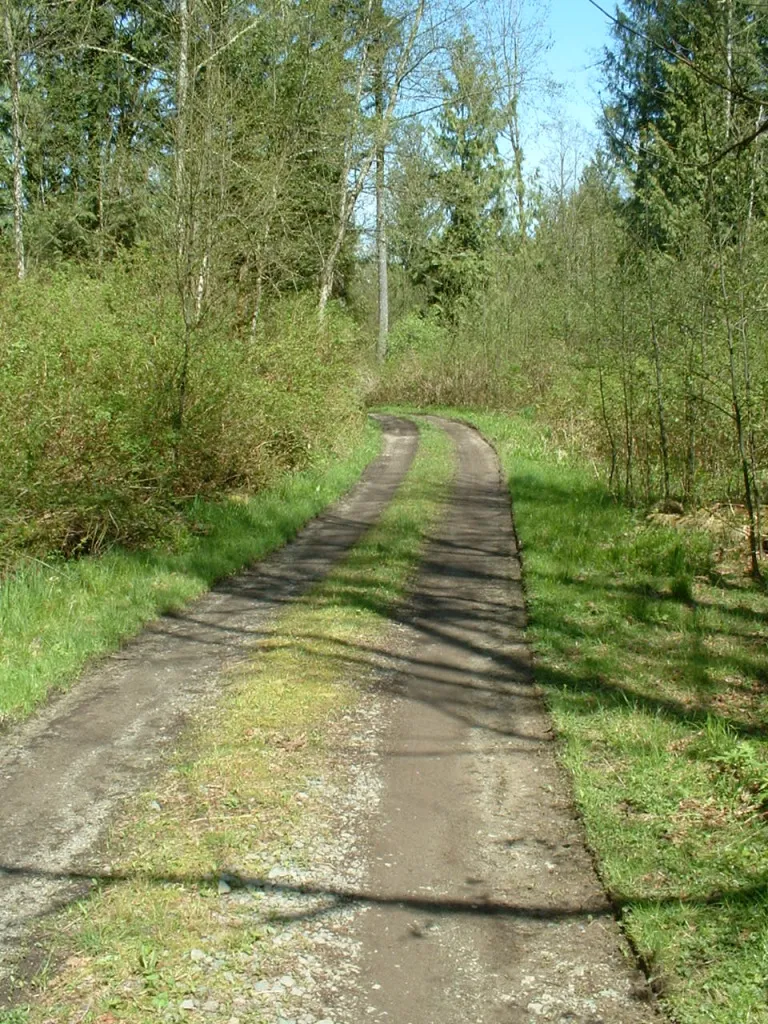

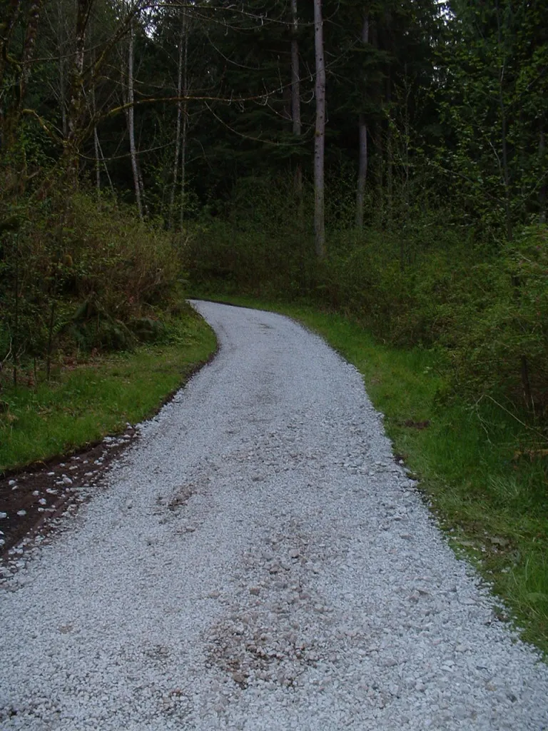

One of the first projects I tackled was the driveway.  It's an established road bed, but it hadn't seen gravel in over 10 years.  It was pretty rutted, and there were a few areas where water pooled and made it muddy.  I considered adding some geotextile fabric in a couple of places, but decided that the road bed was solid enough and improving drainage would suffice.  Thankfully, it was a good call.  I've since had a 40' shipping container delivered, and the driveway held up just fine.
Before:
See the leftover cable embedded in the roadway from when the property was logged at some point?  It pops up in various places on the driveway and in the woods.  I'm not pulling it, as I don't know if/where it might be entwined with the power and phone lines!

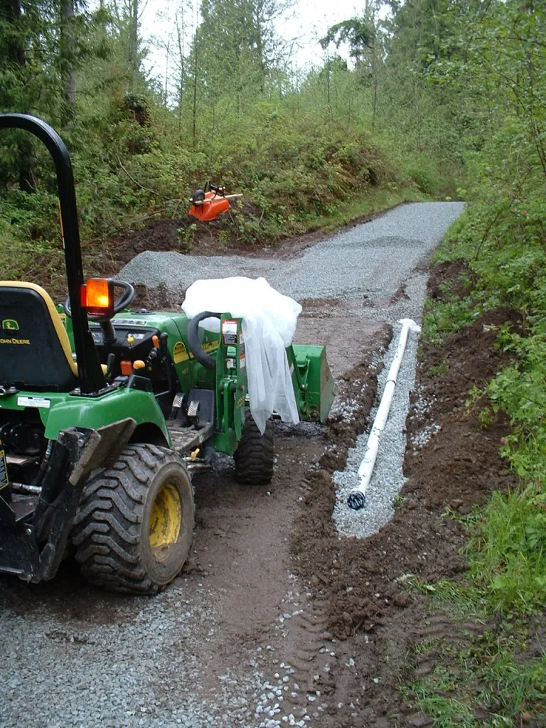

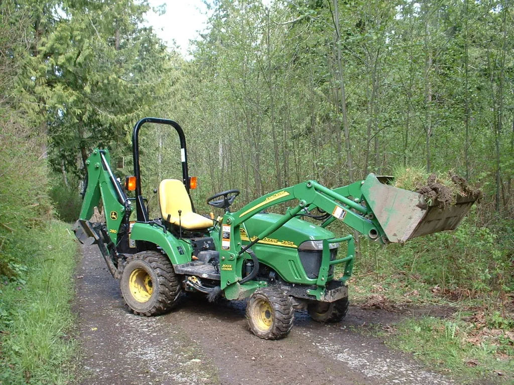

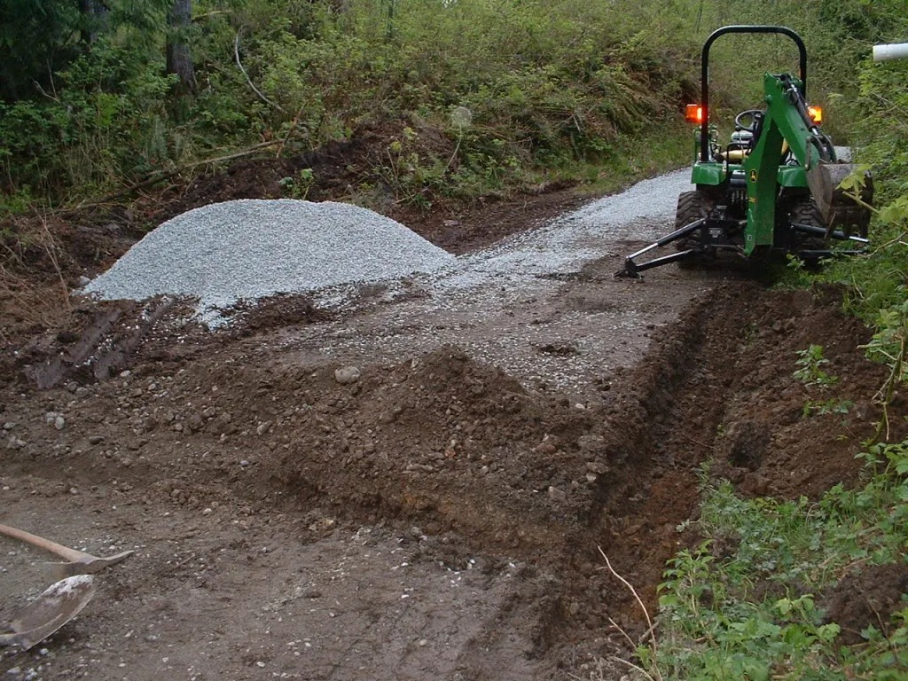

Rented a little John Deere 2305 with loader and backhoe

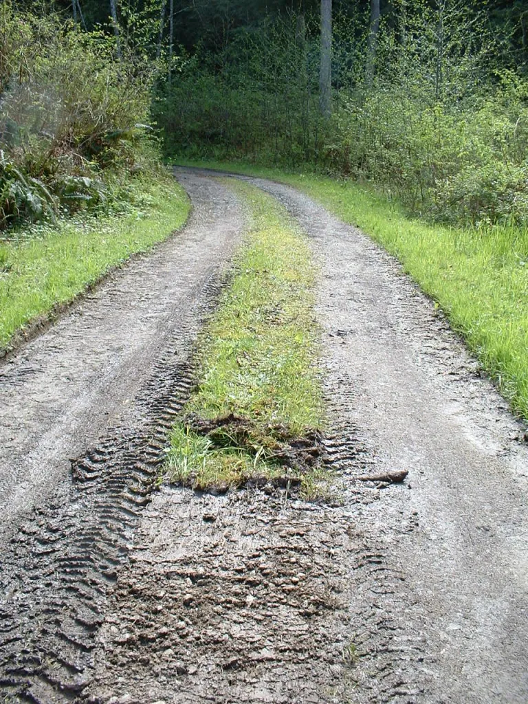

Scraped the crown off in some of the worst places
And made a nice mess in a low spot

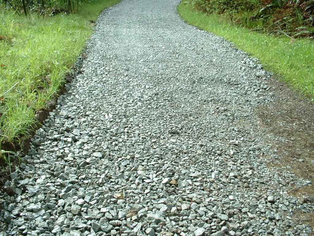

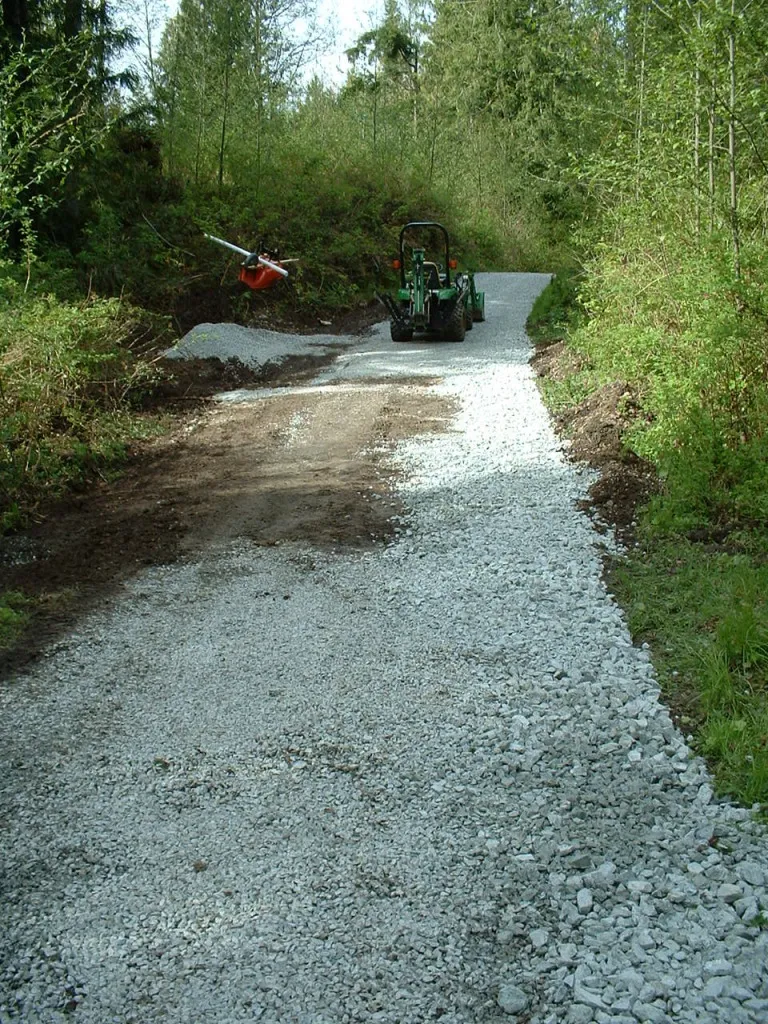

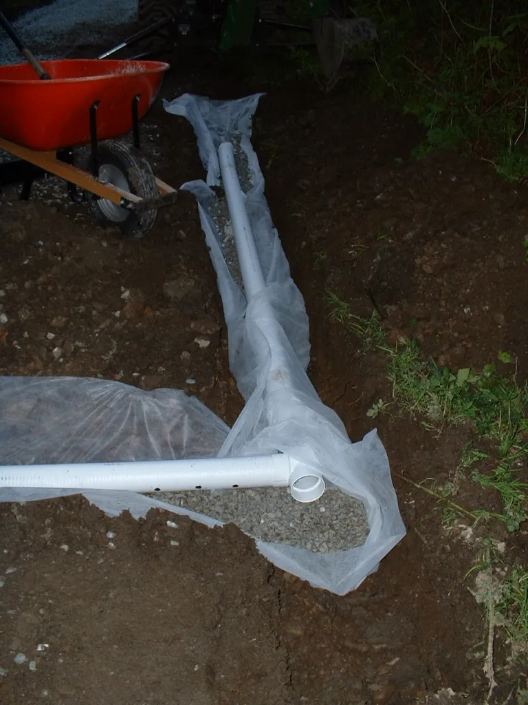

Initially, I'd planned on adding perforated pipe drainage in several places but only ended up using it in one spot instead.  Even there, my revised plan ended up being to try to pitch the driveway to drain off to one side.  To start, I got some 3/4 x 2-1/2 railroad ballast to fill some of the low spots and larger ruts.  I also used it to build up one side of the driveway where needed.

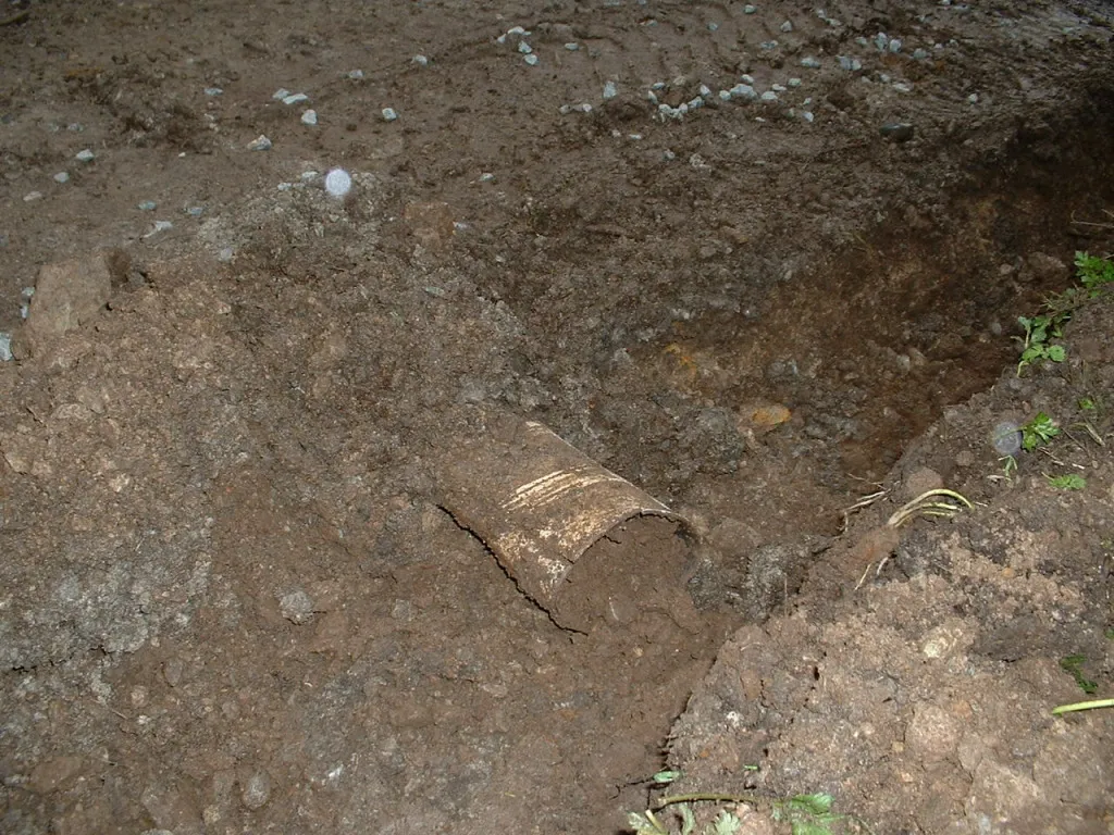

One section of drainage I added along uphill side and draining across
Hope mine works better than this!

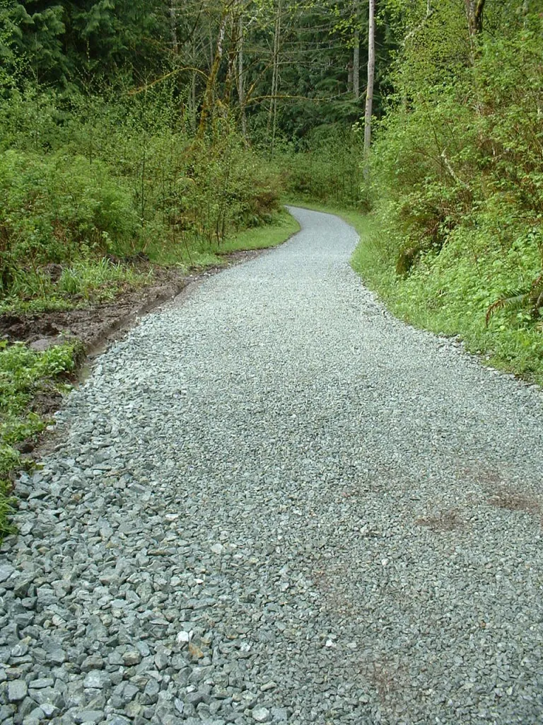

Backfilled and with additional 3/4 x 2-1/2 on top to pitch driveway
Done...
...and working
After the work, I went over most of it with 3/4".  Later, I went over most of that with 5/8" minus.  There are still areas I want to improve, but it's working really well so far, and I get over 40" of rain annually!
