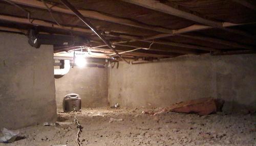

When I am referring to a crawl space, I am referring to a continuous vented or unvented wall like this:
The "best practices" for crawl spaces these days indicate these need to be completely encapsulated and dehumidified (aka conditioned).  I want to avoid that -- depending on the answers I get.

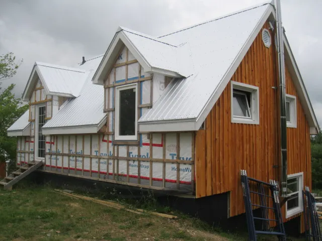

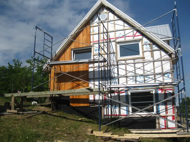

Well, thank you sir for the compliment.
(Actually, that foundation as well as the entire house (minus interior walls and the treated lumber for the porches) was constructed from yellow pine and cedar that I milled from trees on the land with a Logosol chainsaw mill)
I'm still working on the house, but here's a picture from not too long ago.
I've since stained the porches and foundation, wall insulation and all drywall done, electrical done, now working on the plumbing.
It's  been a big job for this old guy of 67. It takes a long time when your're working alone. Some stages are really challenging, like putting up the trusses by yourself ( yeah, I made those from the yellow pine as well).
Anyways, I've enjoyed it for the most part, especially making the lumber.
Regards,
Arky
