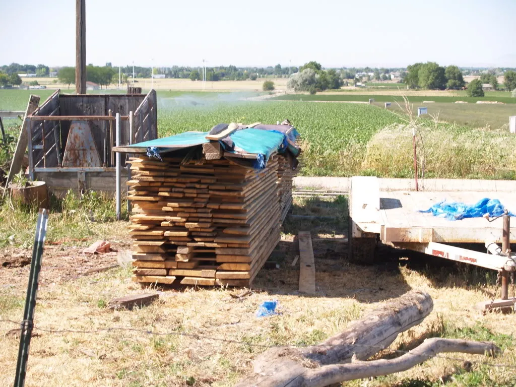

These two units were stickered by my grand son and I.  How long they have to dry depends on weather, wind, humidity and ambient temps.  We are blessed here in this area of Idaho with ideal air dring weather.  How long does it take?  I cheat I have a moisture meter.  Prime conditions here four months if we are getting showers up to six months or more.....
Stickers are small boards ripped uniform width and thickness like 3/4 inch thick by an 1.25 inches wide more or less.  Uniform thickness is more important that width.
Measure out our pile bottoms like 4X4s you should have five and the ground should be level and 4x4 should be equal distances from each other.  If you are stacking 1x12s you place three down then a course of stickers.  The stickers go directly over the 4x4s.  Add the next course and sticker again directly over the other sticker and 4X4.  So that is five stickers per course.  So as you can see it will take a huge amount of stickers.
When the boards are dried then we break them down to plane or make molding or something out of them.  But we keep the sickers in very good guarded condition because they are reused many many times.  I make a pile top out of 2x4 and some heavy timbers and cover that with a plastic tarp.  I used to use slabs off the logs but I seem to like this better.  That keeps the weather off and stops the sun from warping the top boards so bad.
 [cool]  Rick might find you some old roofing tin to replace the tarp with.  Speaking from experience mind you. The tarp will breakdown on the sun.  Shoot they break down anywhere.  Mostly find them good for temporarily use and that is about it.  I covered several hundred bf of Wormey Chestnut and the tarp gave way before I noticed it.  Was only able to salvage about 1/3.   :(  Don't mind ruining pine but 100 yr old stuff is hard to come by.
The one thing I do not like about the metal roofing strangely is the permanency.  Not that I am short on storage space but it is just some thing else sitting around.  All that lumber is now stored up at the ranch ready to be milled.  Those plastic tarps,   Bless them  ;)  are now doing duty in occupying the country sanitary land fill.  Actually what works best here is covering pile tops with lumber wrap.  However all my lumber warp is gone.
Before we lost all our saw and planer mills here.  The mills used pile tops - 1x12 nailed underneath with five or six four foot 2x4.  On top of those was lumber wrap and over that were 1x4 batts or battons over the cracks of the 1x12s.  Planer mills would have acres of bunks like that stored, drying - four high if I remember right. Each had a pile top on it.
They worked great but we do not get the moisture you do.  If we get an inch of rain here in 24 hours it is like in the news and a disaster.  An afternoon of sprinkle your way is a real down pour here.  10% - 15% humidity and people here wondering when it is going to stop.  Oh my word and it is so muggy outside!  All our farm ground here would be a wasteland without irrigation.  Here you could not even do dry land wheat and do much good at all.
