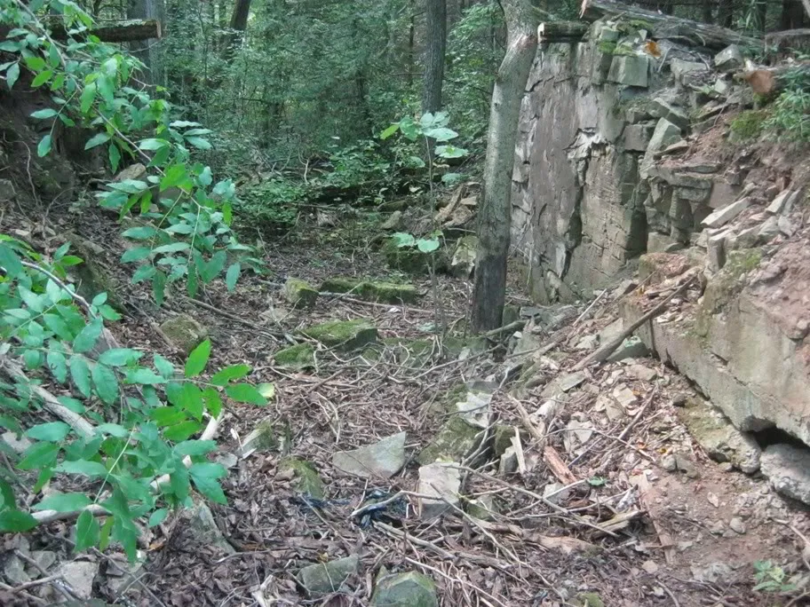

Here are the links on photo bucket. This is the foundation hole that we have been clearing out from fallen trees. It will act as the uphill patio. I would like to leave the tree growing in it, right where it is.

Beautiful uphill patio.  [cool]
You can also insert a couple lines between your links to put spaces between the pictures but you did real good... :)
About the tree, yes, we preserved many trees around the perimeter of the house and saved them wherever we could.
Is it possible to drain the uphill patio to one side or the other around the proposed underground house.  Also, I recommend putting in French Drains from the start.  Mike is also recommending EPDM rather than Poly now.  That is a wise recommendation.  It is forgiving, heavier and will stretch rather than tear.  I am adding layers of EPDM in a few problem areas this year.  [ouch]

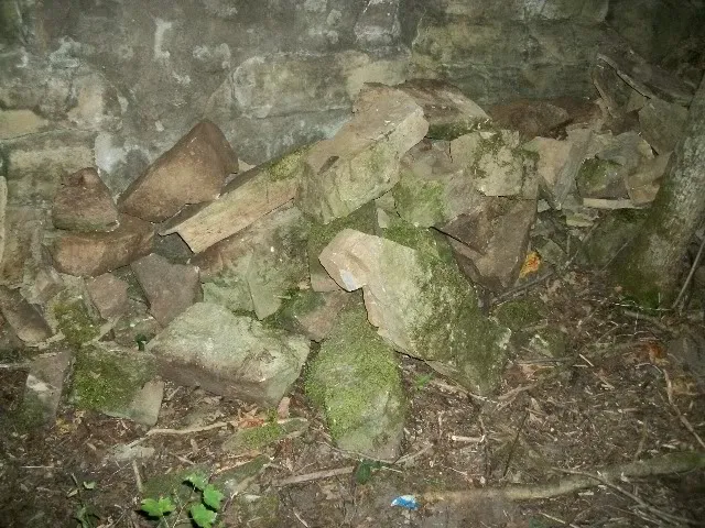

Shale rock that I have pulled out and piled to use in the front entrance
They may look small but Huge rocks piled for retaining walls and steps

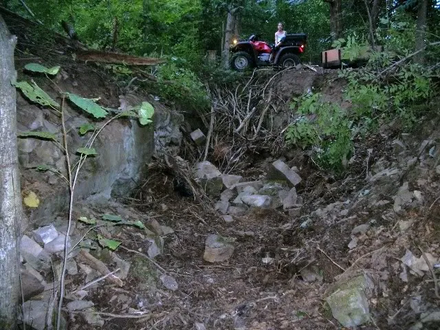

To give an idea of how deep it is from above. Tires cleaned out and rocks getting piled
It dosen't look like much but, it's progress. Other pics I could not get as it was too dark. Now working on a path to cut for the tractor and bucket to clear it out.

My question is, Do you think I can use this stone for a flooring material in the entrance way like you would a tile? I know it would have to be set properly in order not to crack, but if it's done right do you think it would last?
It could be used if you really want to.  We did exactly that and I tore it out this year as I was replacing the floor and adding French drains under it.  We found it to be hard to clean the rough floor or the slate floor and have opted to use only the CBRI light duty floor  - smooth only also but with color added to the top layer.  Cleaning the slate always requires the use of a vacuum cleaner to clean the grout areas.  Kept flush with the slate edges and very smooth would be an option but I wanted to mention the problems.
